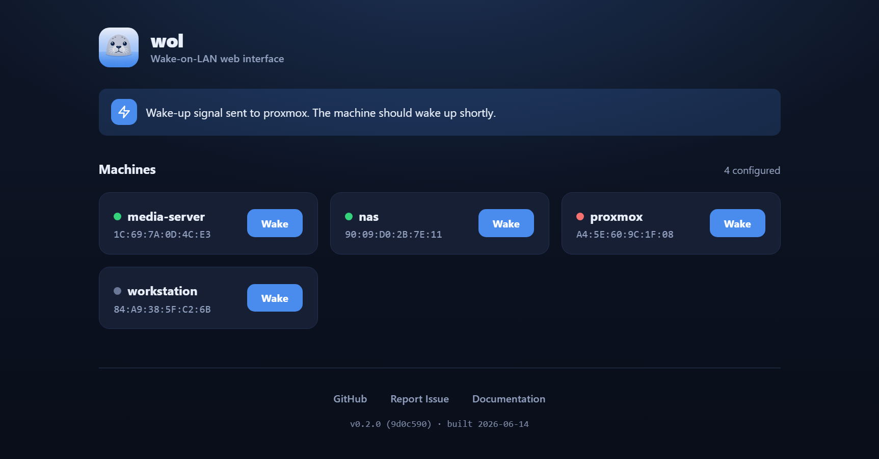

Web Interface
The web interface is available at http://localhost:7777 when running the serve command. It provides:
  • List of all configured machines
  • One-click wake up buttons
  • Real-time machine status monitoring (when IP is configured)
  • Version information
  • Links to documentation and support
