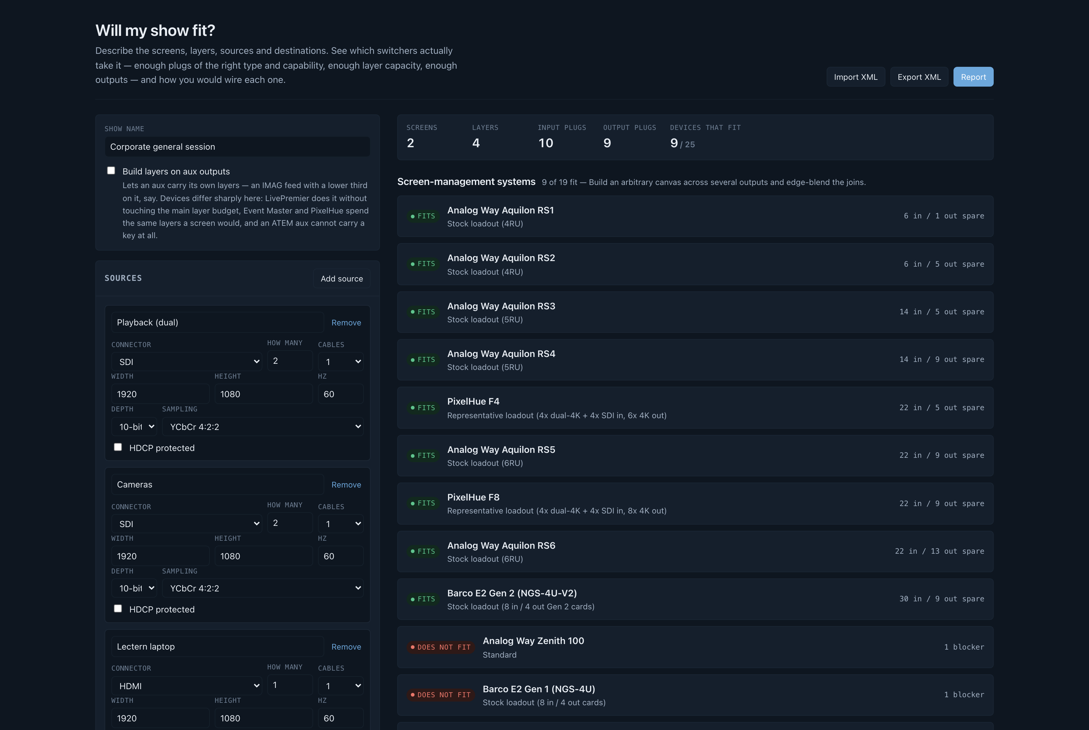

Will my show fit? with a corporate general session described and the device list marked fits or does not fit
A corporate general session (two screens, four layers, ten input plugs) checked against the device library: nine fit, with the spare inputs and outputs each would have, and the blocker on the ones that don't. The screenshot is from when the library had twenty-five switchers. It has thirty-seven now, and the same nine fit.
