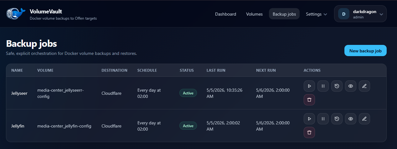

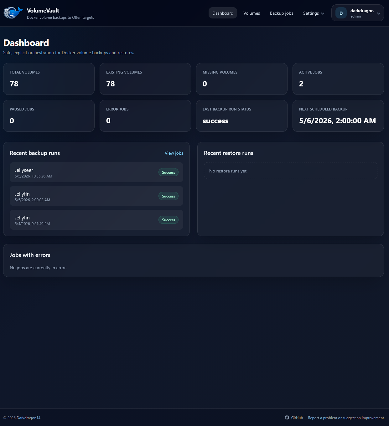

VolumeVault dashboard preview VolumeVault backup jobs preview
