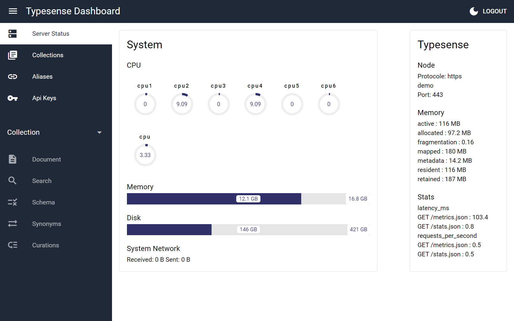

server status

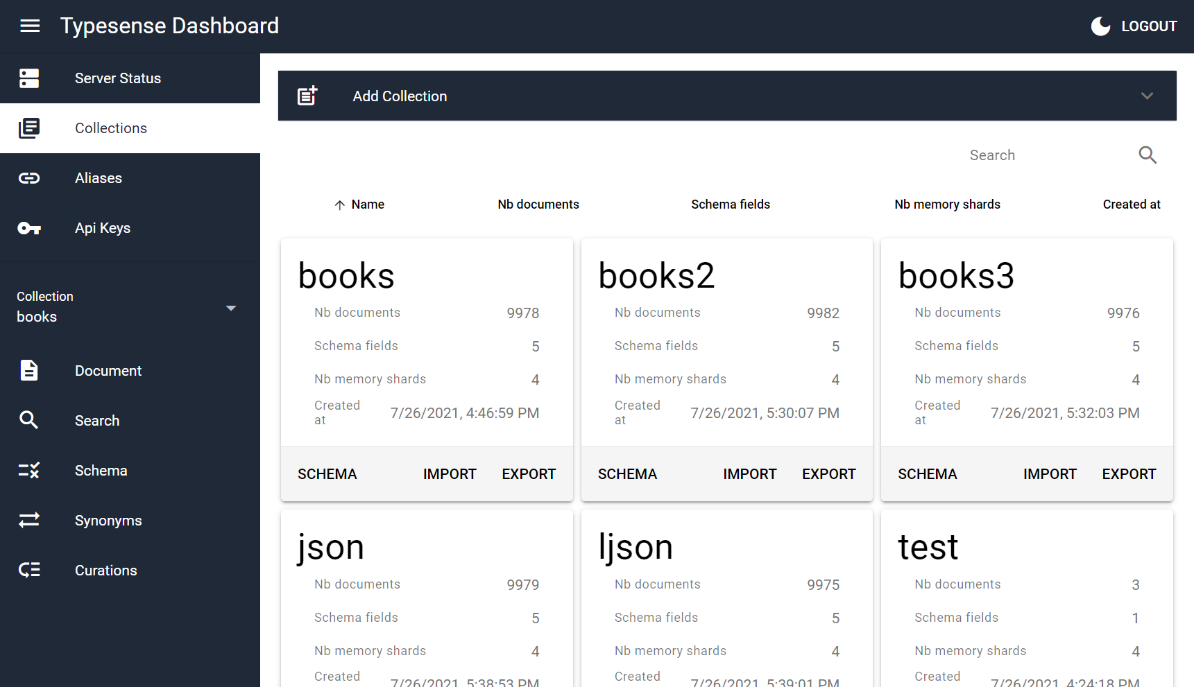

collections

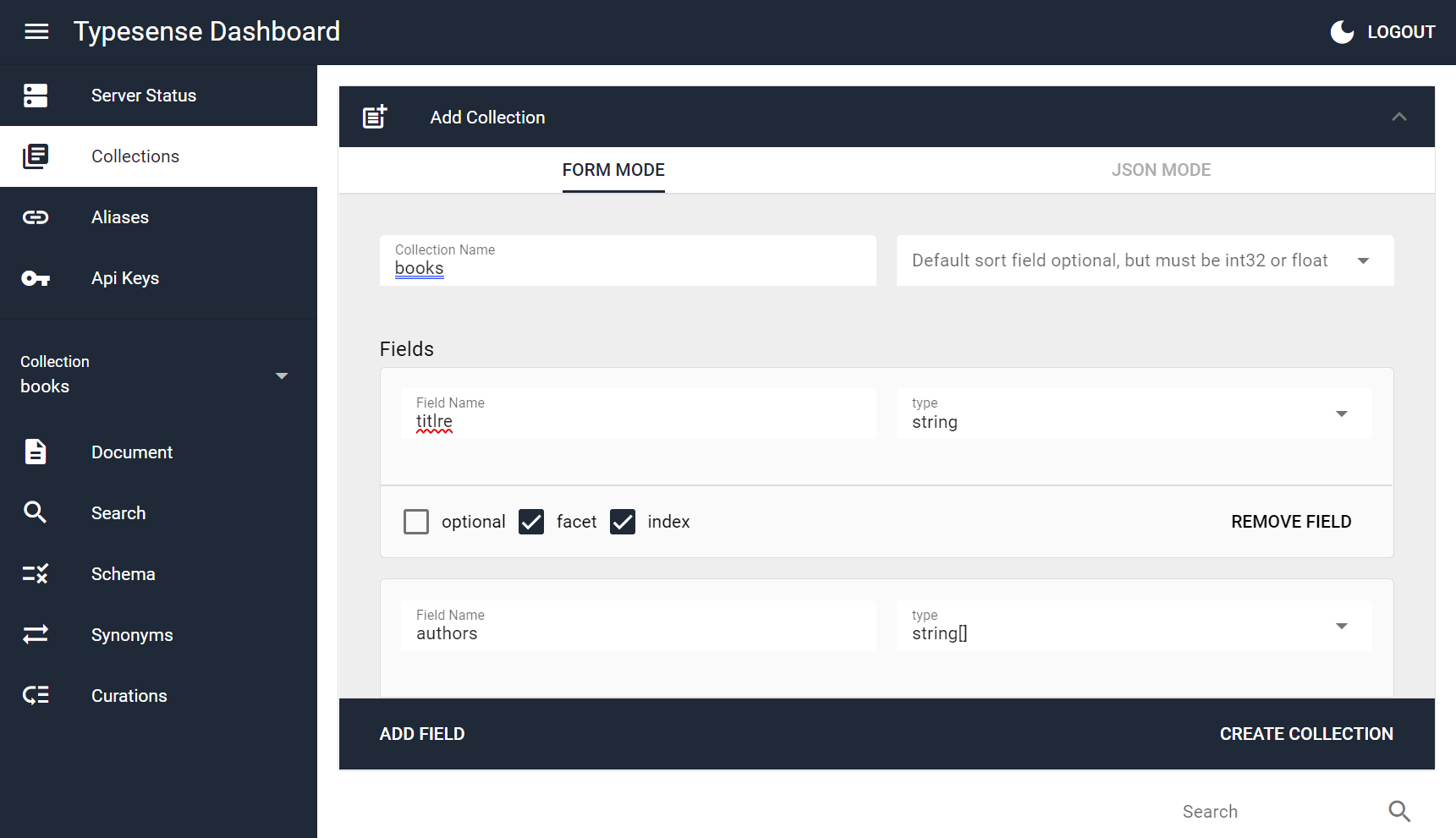

collection add

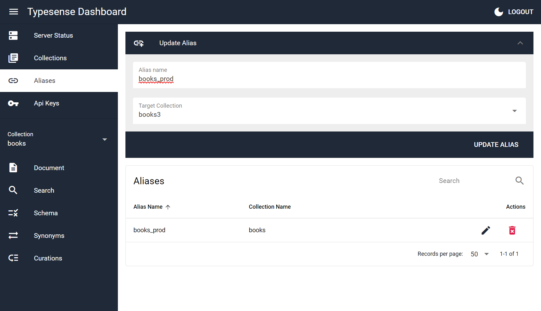

aliases

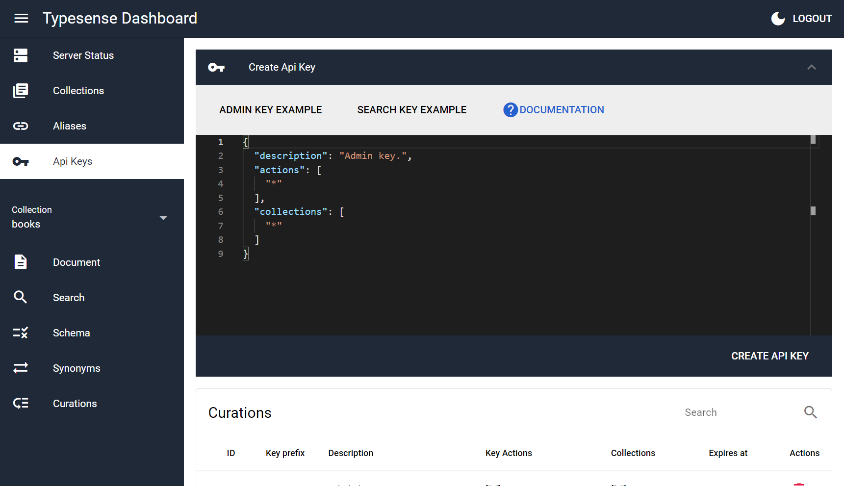

apikeys

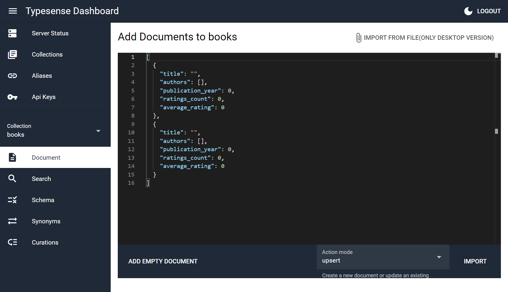

document

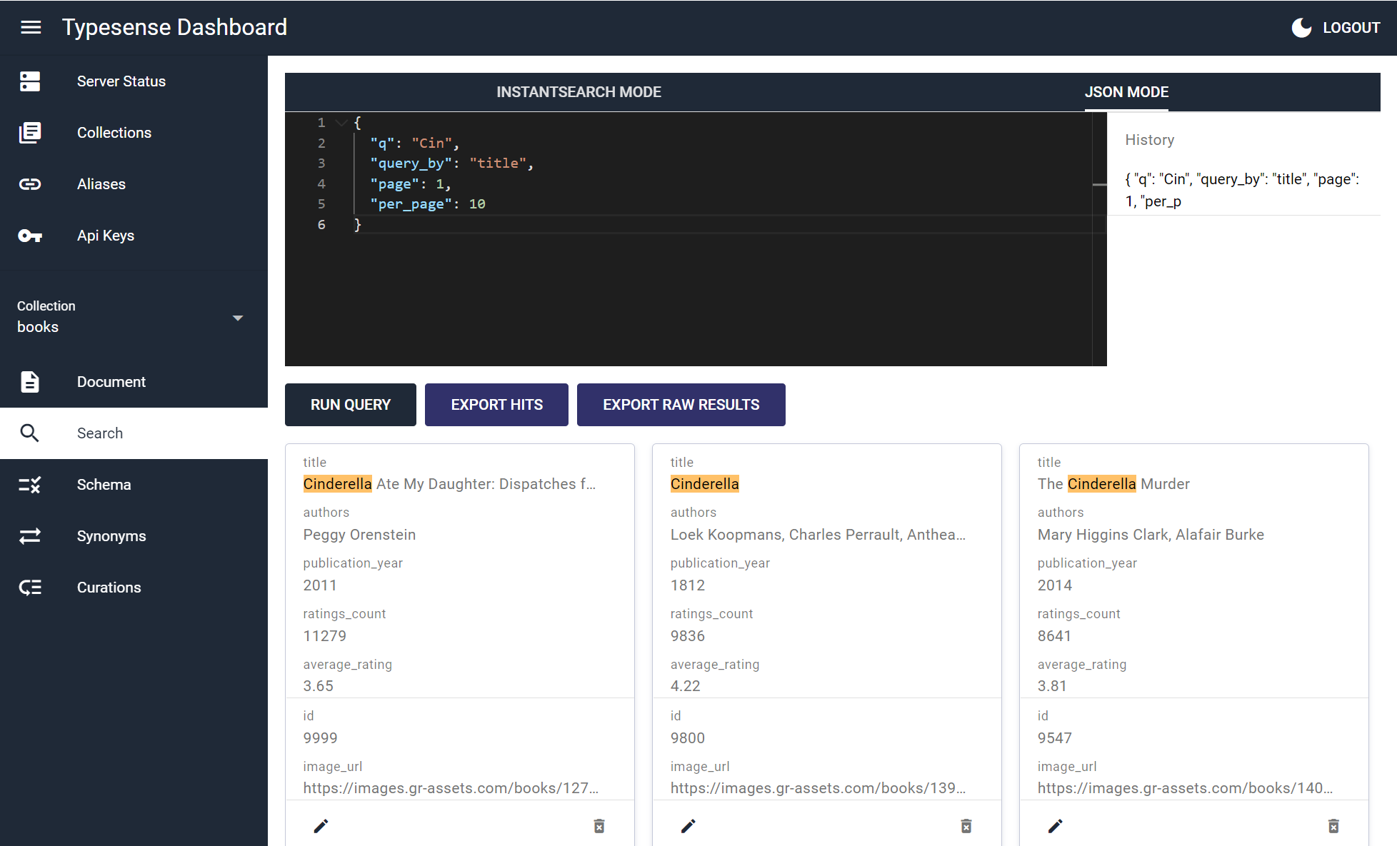

search

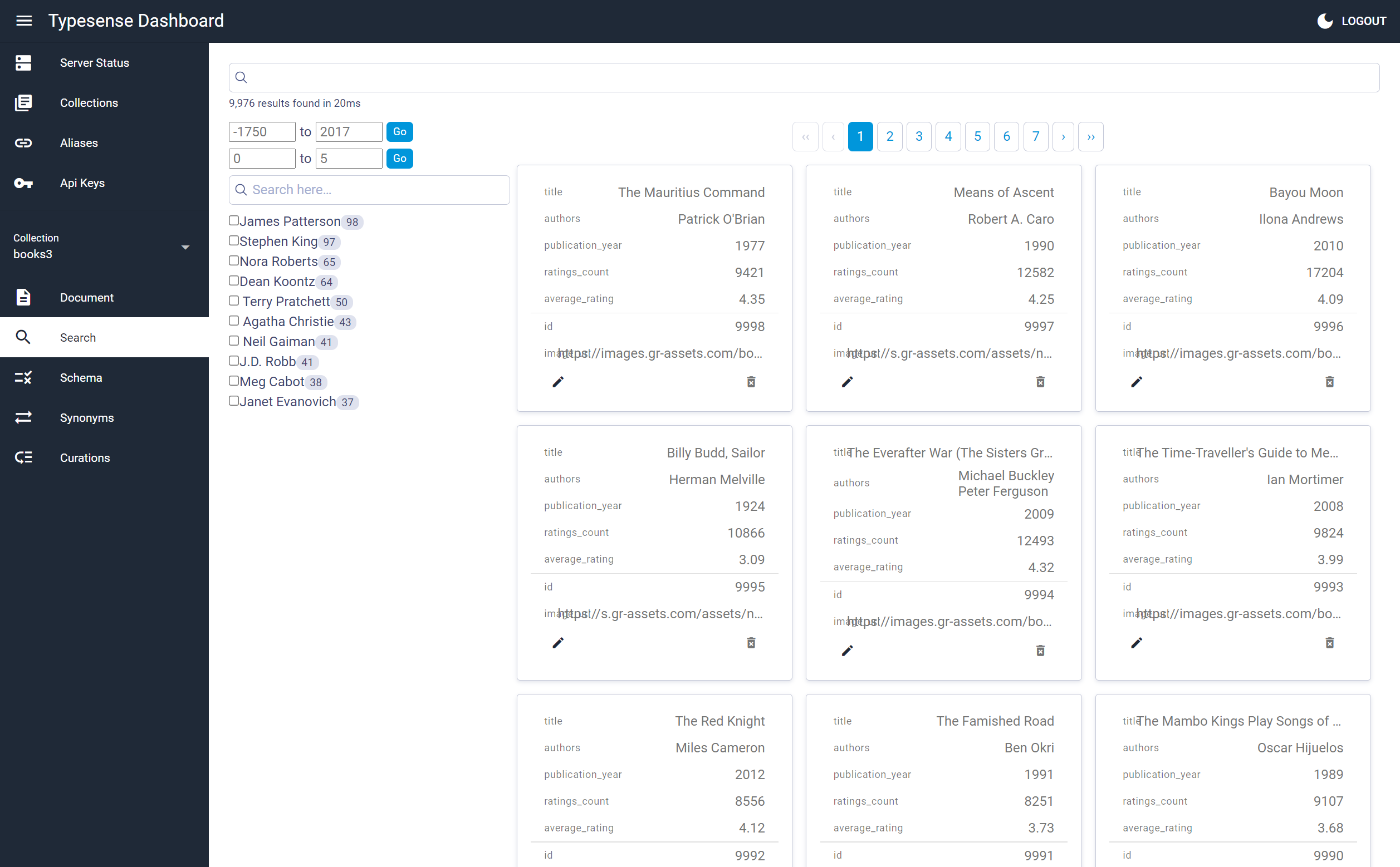

search

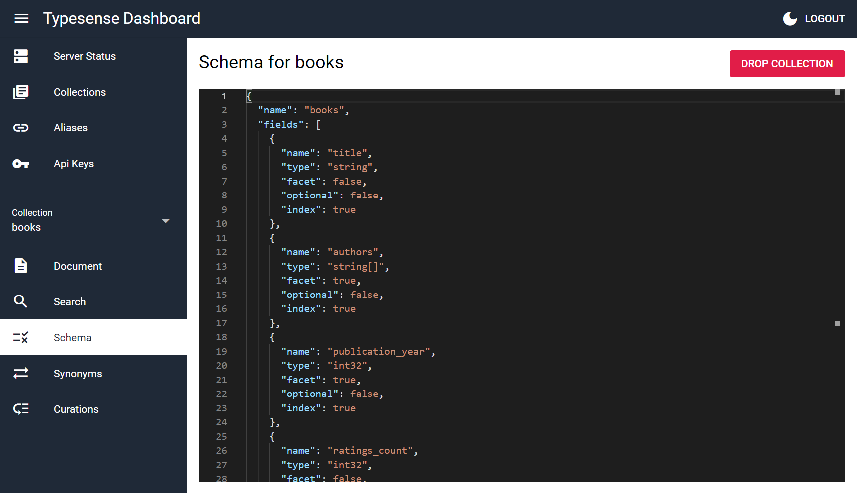

schema

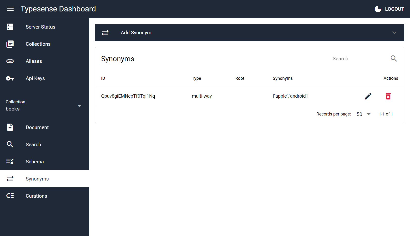

synonyms

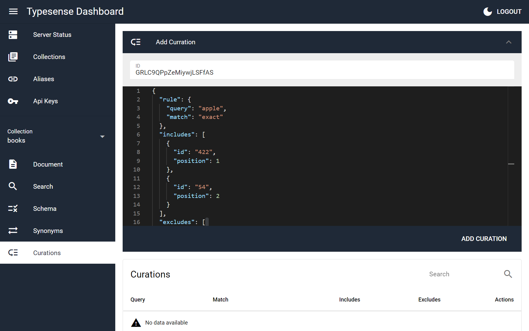

curations
