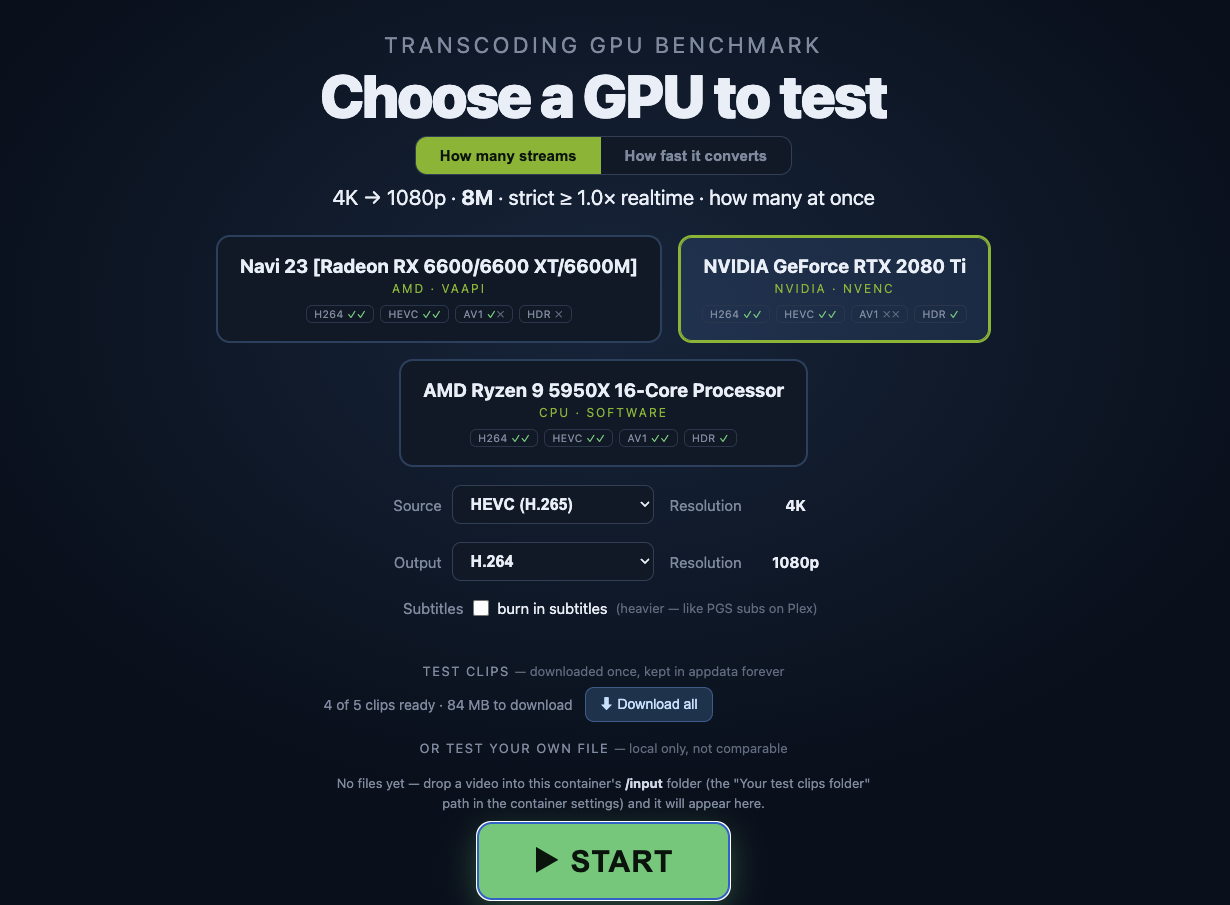

Once it's running, open the WebUI on port 8088 and you'll get the picker screen with every device it found.
The device picker showing the detected GPUs and CPU with the source and output options

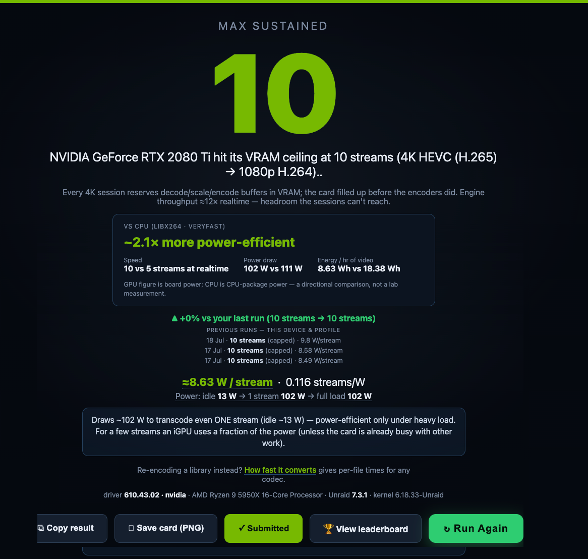

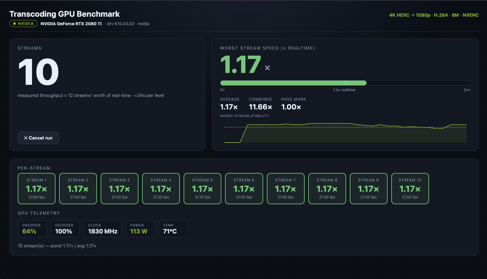

Pick a device, leave the source and output on their defaults for the standard test, and press start. The scoreboard shows each stream's speed live as it ramps up, and when it finishes you get your headline number along with the power draw and efficiency figures.
The live scoreboard part way through a run, with several streams going and the worst stream speed above real time
The finished verdict showing the headline stream count, the power draw and the efficiency figures
The efficiency numbers are where it gets interesting for me. A discrete GPU pulls a lot of power the moment it does anything, so it only looks good per stream when it's running plenty of them. An Intel iGPU sips power by comparison. If you run a CPU baseline as well, you'll see just how much more efficient a media engine is than software encoding for the same job, and that gap was bigger than I'd have guessed. On my own boxes the iGPU came out something like forty times more efficient than the CPU doing the identical work.

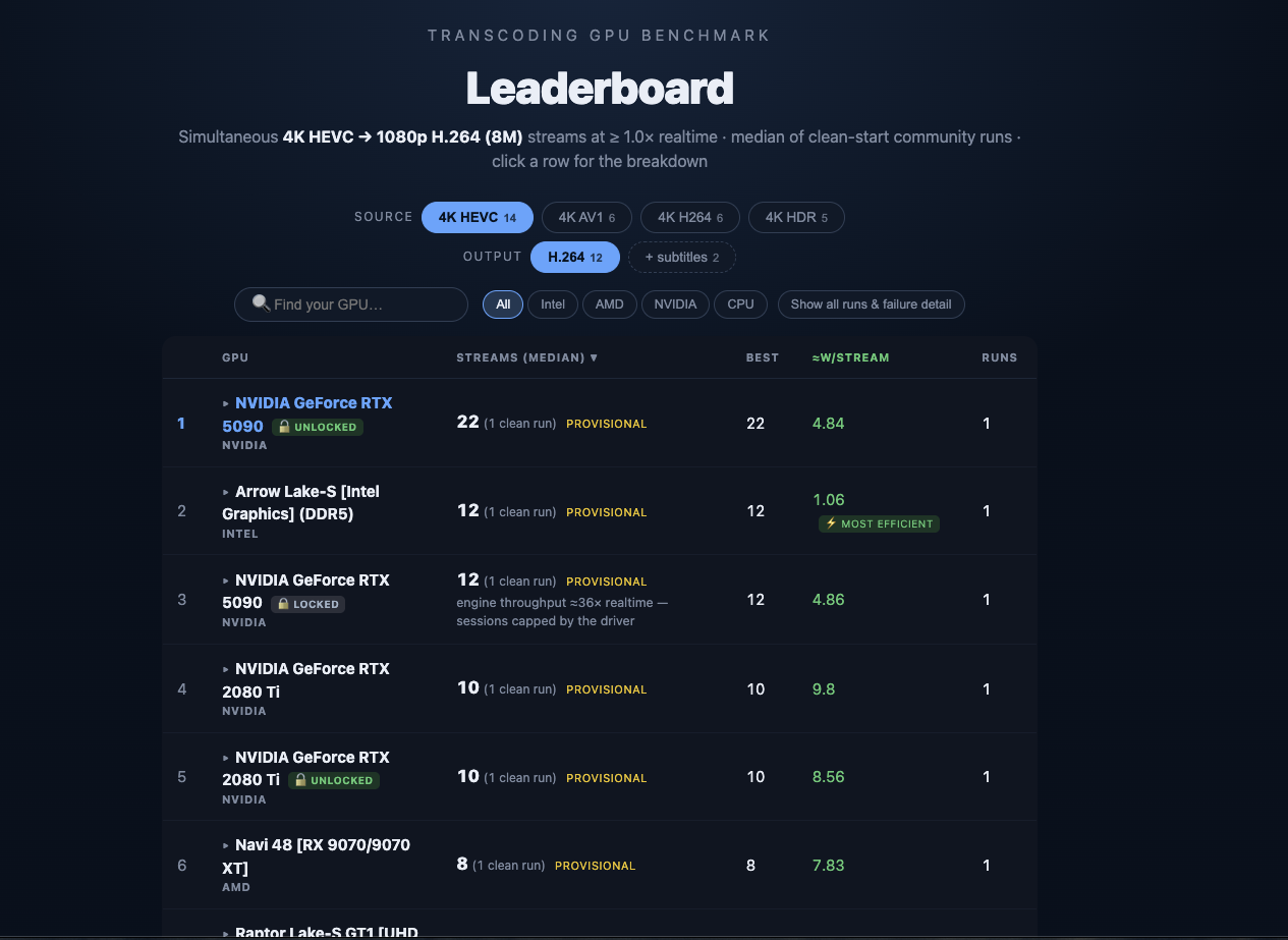

The leaderboard
Once you've got a streaming result you can submit it to gpu.spaceinvader.one with the button on the verdict screen. The board ranks cards by the median of clean runs rather than the single best score anyone managed, so it reflects what you'll typically get, not a lucky one off.
The leaderboard with the same NVIDIA card listed twice, unlocked and locked, showing the different stream counts
A few things it shows that are worth knowing about.
For Intel integrated graphics it splits cards by memory generation, so a UHD 770 on DDR4 and the same chip on DDR5 show up separately. The iGPU shares your system RAM as its video memory, so faster RAM genuinely moves the score, and keeping them apart stops that muddying the ranking.
For NVIDIA cards it detects whether the driver's NVENC session limit has been patched out, and marks each card as locked or unlocked with a small padlock. Consumer NVIDIA drivers cap how many encode sessions you can run at once, and some people patch that limit away. A locked and an unlocked version of the same card are ranked as separate entries, so you can see for yourself whether unlocking actually bought anything. Honestly, on a lot of modern cards it buys you nothing, because they run out of memory or raw throughput long before the session cap ever comes into play. Being able to see a locked and unlocked card land on the same number tells you that at a glance.
