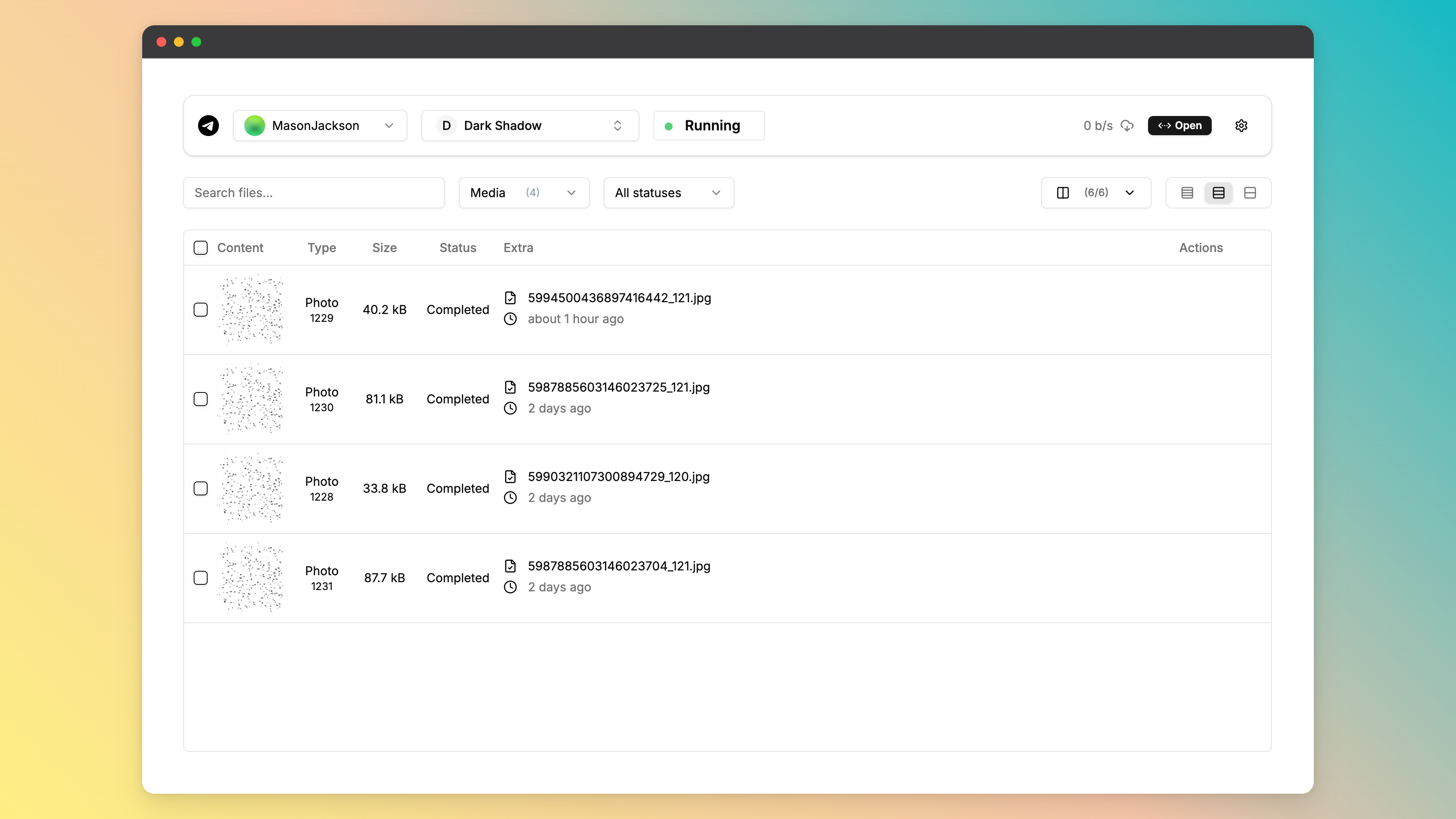

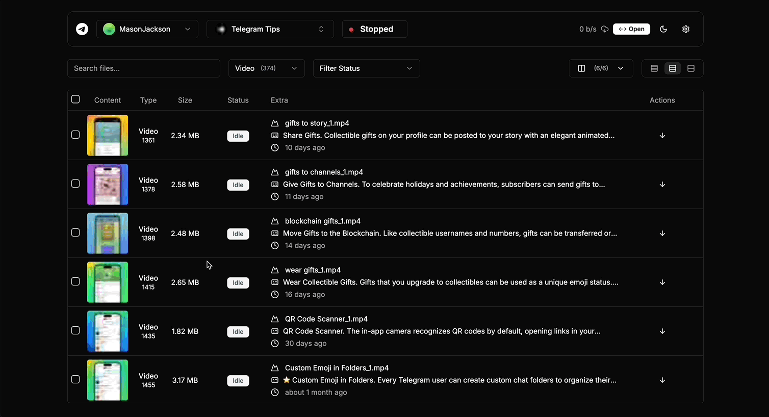

  • Seamless file downloads from Telegram channels and groups

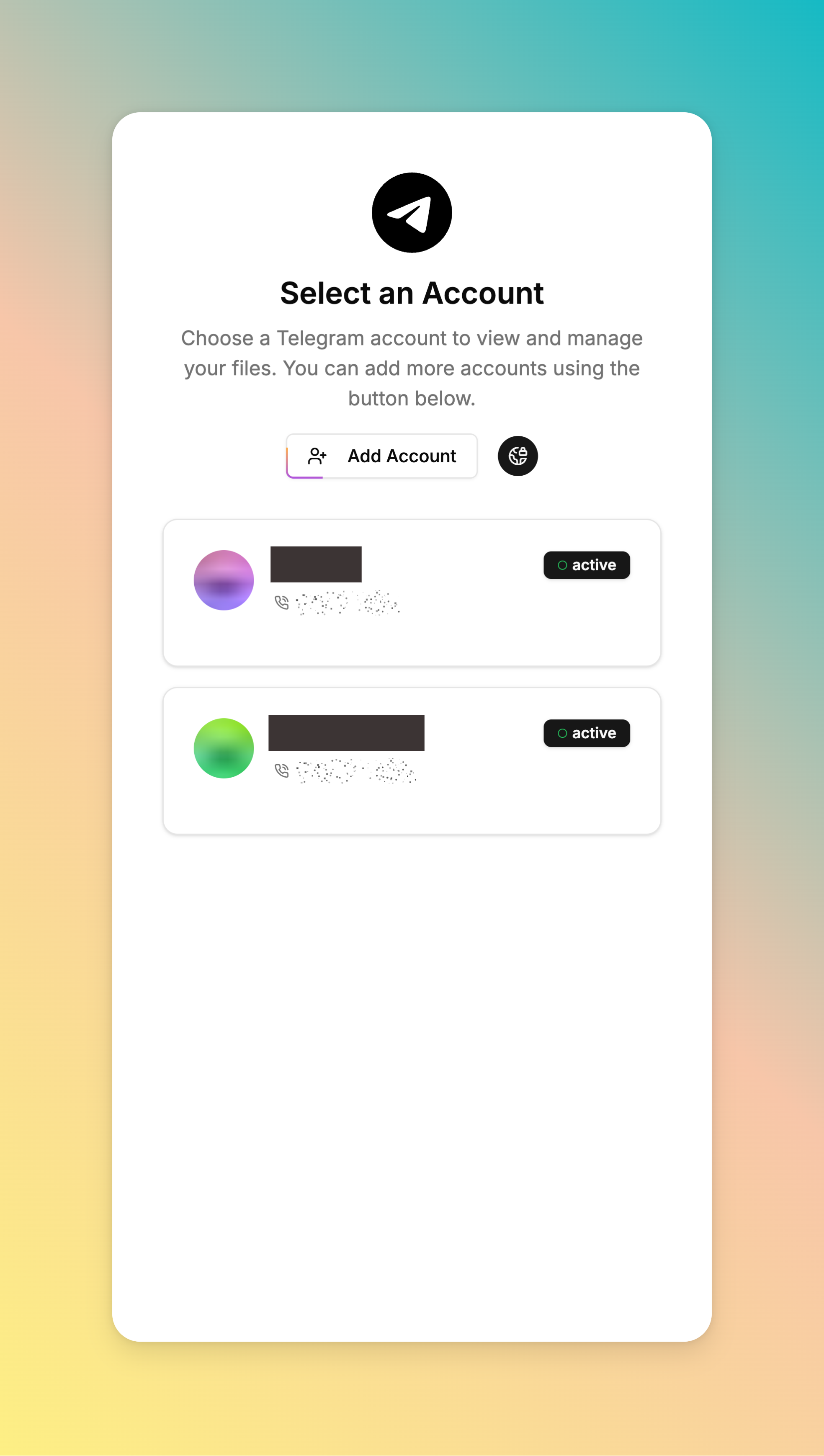

  • Support for multiple Telegram accounts to manage and download files simultaneously

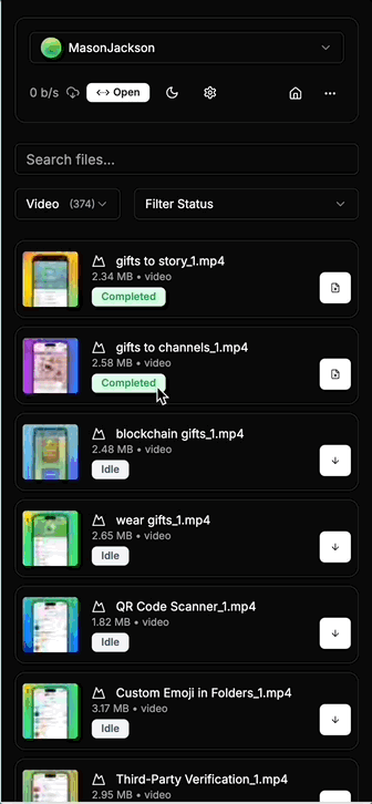

  • Pause and resume downloads anytime, with automatic file transfer to designated destinations

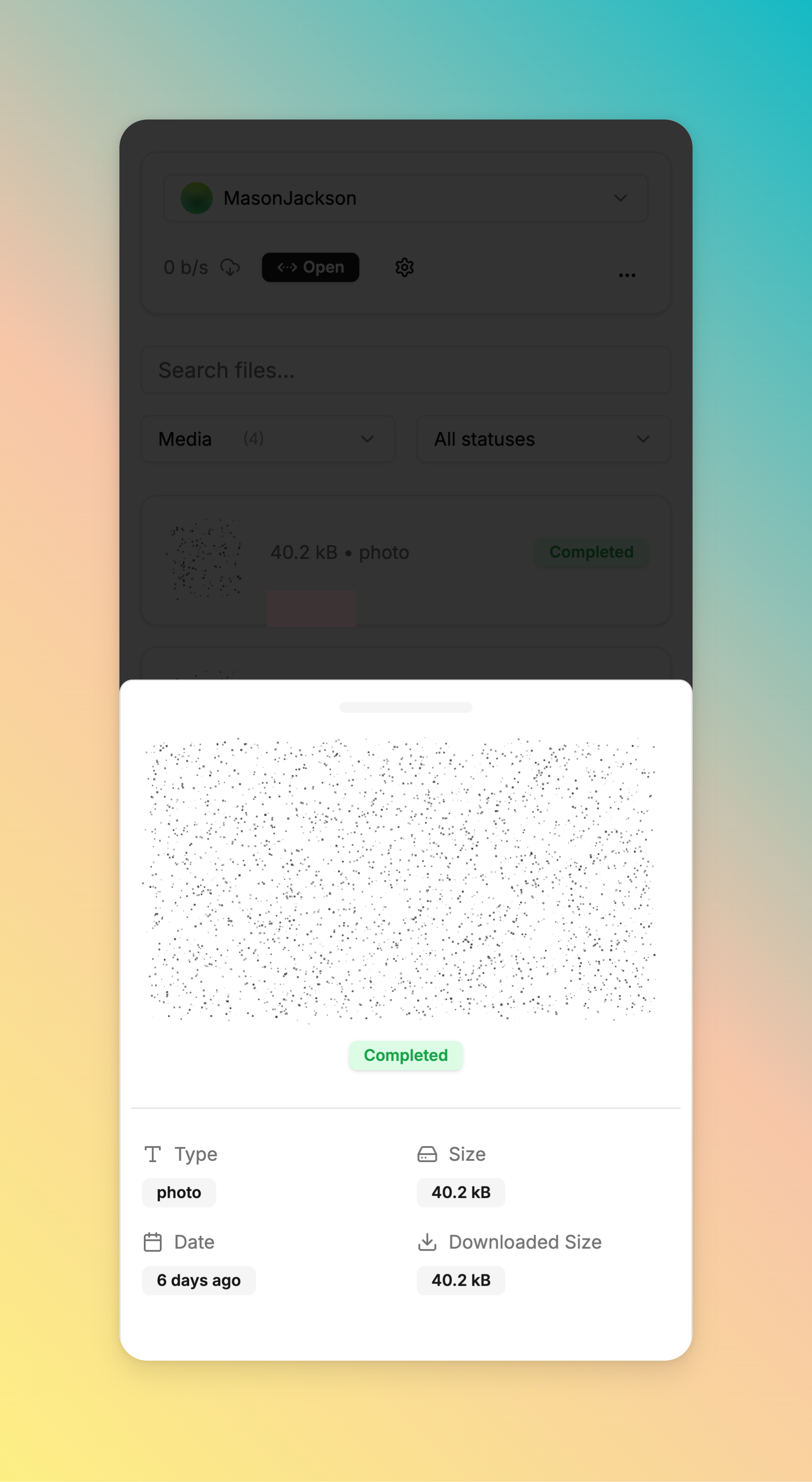

  • Instant preview of downloaded videos and images
  • Fully responsive design with mobile-friendly access, Progressive Web App (PWA) support, and offline capabilities
  • Easily fetch files from Telegram shared links

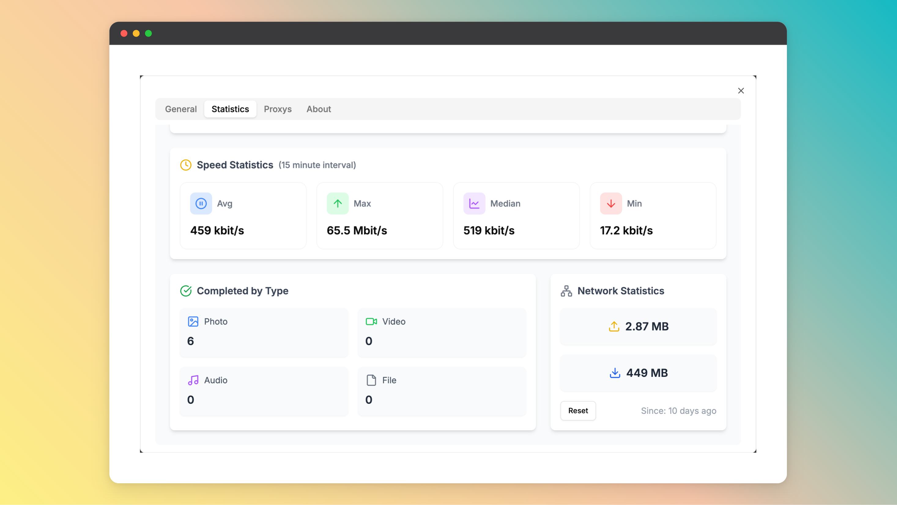

  • βœ… Task 2: Download statistics and reports.
