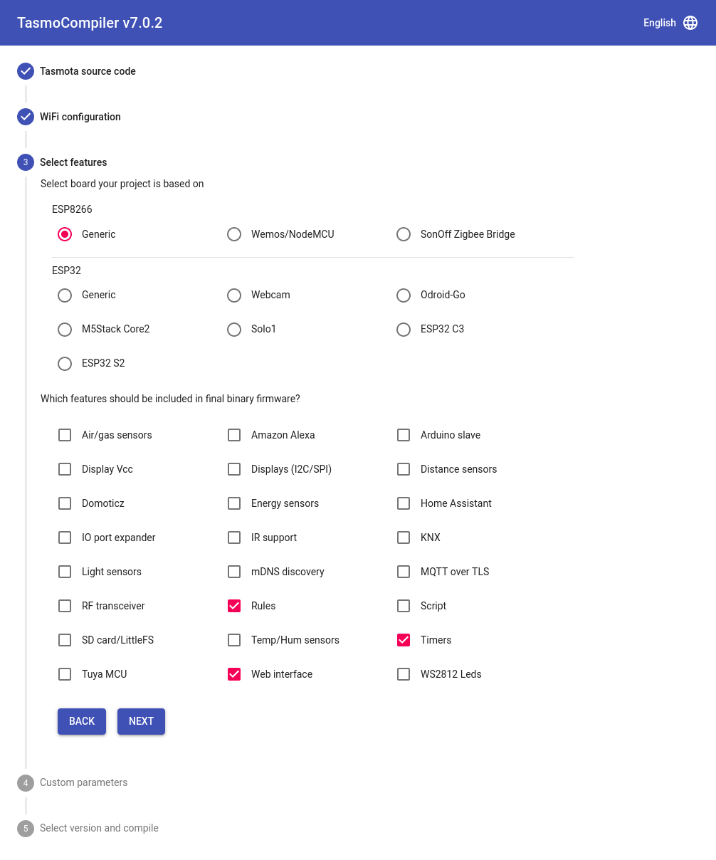

  • You can select which board you are building firmware for
  • You can select which features/sensors of Tasmota firmware you want to use (description of available features can be found in FEATURES DESCRIPTION file)

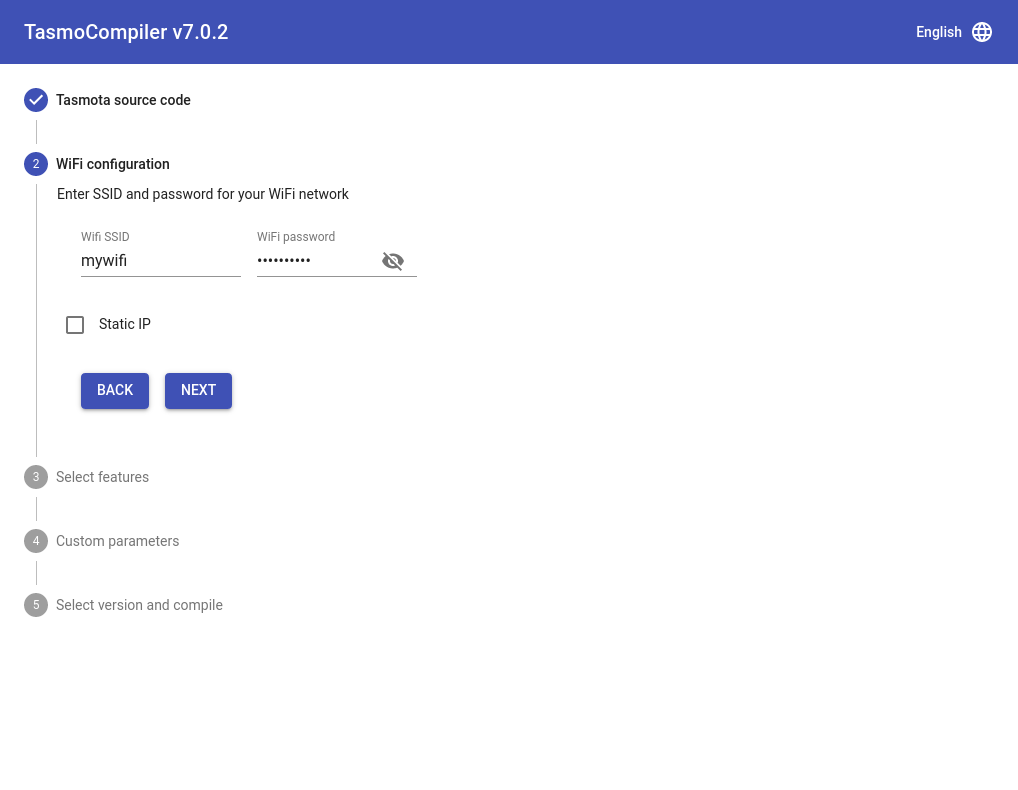

  • Credentials for your IOT WiFi network, so even after unexpected problems with the device (complete lost of configuration), credentials for your network will still be there, but mainly you don't have to connect to AP, served by Tasmota to configure your Home WiFi

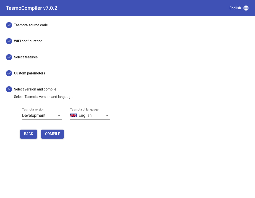

  • You can select Tasmota version you want to compile. You can select development bleading edge version, or latest stable release if this is the one you like
  • Language of Tasmota GUI interface

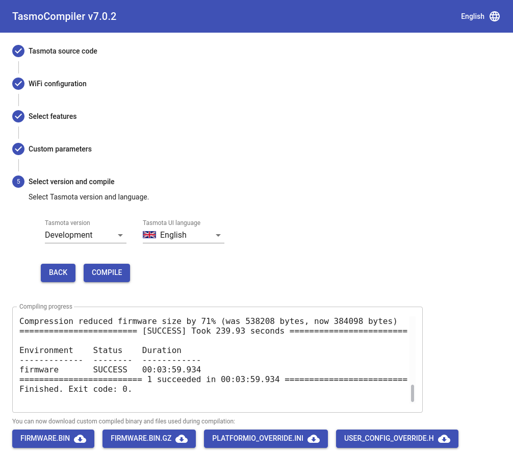

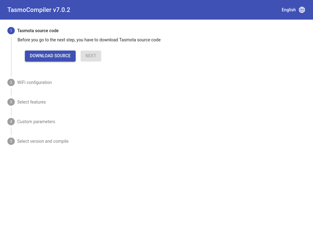

How it works?
The easiest way is to look at the screenshots (the whole process is five steps only). After compilation you will be able to download four (or three for ESP32 boards) files:
  1. Your new firmware.bin file, which can be uploaded to your device via Tasmota WebGUI, espotool, ESPEasy flasher or any other tool you used to use to flash your device
  2. Compressed file firmware.bin.gz (not available for ESP32 boards)
  3. platformio_override.ini file, to check what options for platformio were used to compile the custom firmware file
  4. user_config_override.h file to check what features are included/excluded from resulting firmware
The links to download these files will show up under Compiling progress field (look at the bottom of the last screenshot). These links will show up only when compilation is successful.
You have to upload only firmware.bin or firmware.bin.gz file to your device. How to do that is perfeclty described on Tasmota docs.

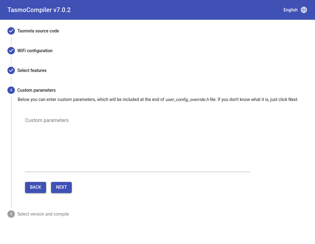

How to use "Custom parameters"?
The configuration options are limited on purpose. I don't want to overload the GUI with too many options. But there is Custom prameters step which allows you to define other Tasmota parameters. Let's say you want to define your MQTT broker and credentials for it. You have to put these lines in Custom parameters field:
#ifdef MQTT_HOST
  #undef MQTT_HOST
#endif
#define MQTT_HOST               "mqtt.yourhost.iot"
#ifdef MQTT_PORT
  #undef MQTT_PORT
#endif
#define MQTT_PORT               1883
#ifdef MQTT_USER
  #undef MQTT_USER
#endif
#define MQTT_USER            "mqttuser"
#ifdef MQTT_PASS
  #undef MQTT_PASS
#endif
#define MQTT_PASS            "mqttpassword"
To define Friendly name for your device you have to put these lines in Custom parametrs field:
#ifdef FRIENDLY_NAME
  #undef FRIENDLY_NAME
#endif
#define FRIENDLY_NAME          "Watering controller"
Let's assume that you want to compile in information about your ntp server, your time zone and location (this is used by timers for events like sunrise/sunset). You can do this by putting these lines in Custom parameters field:
#ifdef NTP_SERVER1
  #undef NTP_SERVER1
#endif
#define NTP_SERVER1             "ntp.yourserver.iot"
#ifdef LATITUDE
  #undef LATITUDE
#endif
#define LATITUDE               34.4348
#ifdef LONGITUDE
  #undef LONGITUDE
#endif
#define LONGITUDE              10.0508
#ifdef APP_TIMEZONE
  #undef APP_TIMEZONE
#endif
#define APP_TIMEZONE           99
You can find additional information what can be set by Custom parameters field in my_user_config.h in Tasmota source code.
