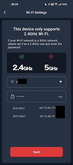

- In-app, add a device. It's safe to connect it to your WiFi network.
- Note down the BLE-MAC during this process, as it will be referenced later
- This step uses Bluetooth Low Energy (BLE) to scan for devices and send the WiFi network information

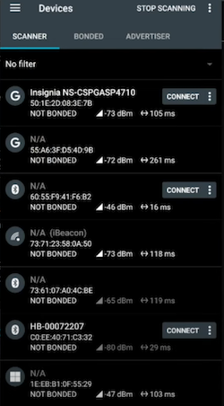

- Install an app such as nRF Connect for Mobile. This will be used to connect to the Bluetooth Low Energy (BLE) radio of the plug to trigger the firmware update process. Bluetility for Mac is also reported to work
- Follow the instructions below, or watch the video, or read the GitHub issues outlining the process https://github.com/kendallgoto/switchbota/issues/43 https://github.com/kendallgoto/switchbota/issues/3#issuecomment-1121864522

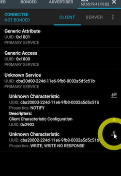

- Using the BLE app of choice, scan for devices and Connect to the device matching the BLE-MAC noted from the SwitchBot app
- Make sure the app is on the Client tab, then expand "Unknown Service" and look at the options within. The last option, "Unknown Characteristic" should have Properties such as "WRITE" and an upload button on the right side. Hit the Upload button on the right side to bring up the Write screen.

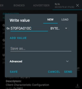

- Select the BYTE_ARRAY type from the dropdown and enter in the hex code
57 0F 0A 01 0C(without spaces). Then it Send to transmit the command to the plug- The last two characters represent the firmware version to be flashed, and must be different from the current firmware version.
0C(as shown above) represents v1.2,0Drepresents v1.3,0Erepresents v1.4.0Cshould be safe to use by default. More detail can be found here

- Now send a new BYTE_ARRAY command in the BLE app (nRF Connect) with hex
57 0F 0B. Hit Send to trigger the second and final firmware flash step - Wait a few seconds again and then look at the NodeJS log to verify the command worked as it should. You should see something such as

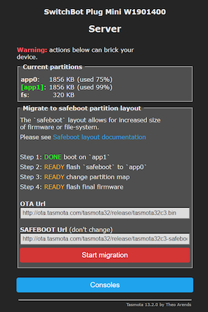

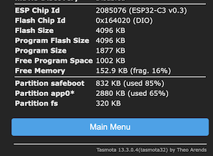

- NOTE: The firmware upgrade may only succeed once, due to the first Tasmota firmware being a factory version that is easily overwritten. Subsequent firmware upgrades may fail silently, meaning the device reboots but the firmware doesn't actually upgrade. Check the console for signs of an error such as
{"StatusSTK":{"Exception":7,"Reason":"Store access fault","EPC":"403832ae","EXCVADDR":"00000000","CallChain":["40387caa","4038be68","420adf92","4038d178","403801ee","421161a0","42115638","42096b3e","42096bd6","42013be6"]}}to validate if this is happening. This is due to the mismatch in partition layout - The partition layout can be fixed by using the Tasmota Application "Partition Wizard" which can be downloaded from here. Partition Manager is also available but is not needed for this process. Download the

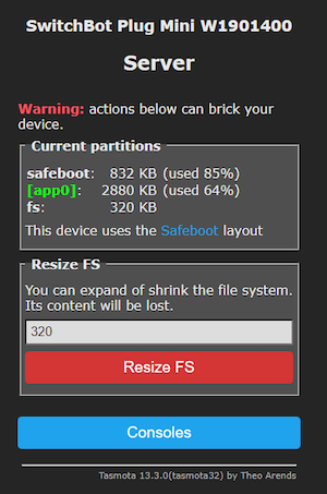

Partition Wizard.tappfile to your computer - Go to the SwitchBot Tasmota interface, into "Consoles" and then "Manage File System." Select the
Partition Wizard.tappfile and click "Upload." If the page refreshes without showing the newly added file, reboot the Tasmota and try again and it should upload - Reboot the Tasmota once the file is uploaded to get Tasmota to recognize the app. Then go to "Consoles" and then "Partition Wizard" to see the following page. It shows that the current partition layout is
app0andapp1andfswhich is incompatible with larger firmwares, hence the need for an upgrade. There is thankfully a section to fix this with one button, "Start migration." Click it, confirm the multiple reboots warning, and wait a few minutes. Note that it will also update the firmware as part of this process
- After a few minutes, click the Main Menu button to return to the Tasmota main menu. Confirm that the new partition layout has taken effect by going back to the "Partition Wizard" page, or just go to "Information." Both are pictured
- The SwitchBot is now prepared to accept future Tasmota firmware updates (though is also now incompatible with the ESPHome partition layout)

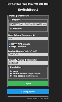

Once the Tasmota page is accessible again, go to "Configuration" and then "Configure Other." In the Template section, paste the following value and check the "Activate" button. Also feel free to change the Device Name, which shows up on the Tasmota home page. Finally, click "Save" and wait for the Tasmota to restart
{"NAME":"SwitchBot Smart Plug Mini W1901400","GPIO":[0,0,32,0,0,0,224,320,321,0,0,0,0,0,0,0,0,0,2720,2656,2624,0],"FLAG":0,"BASE":1}- The template can also be found on the Tasmota device repository https://templates.blakadder.com/switchbot_plugmini_W1901400.html
- The
GPIOnumbers refer to the different GPIO device IDs, found at https://tasmota.github.io/docs/Components/. TheBASErefers to a base template, which in this case is 1 orESP32C3

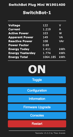

Perform the Power Calibration following the instructions in https://tasmota.github.io/docs/Power-Monitoring-Calibration/
- NOTE: Power Calibration is technically optional but not doing it can cause the power readings to be off by an order of magnitude. It is highly recommended to perform Power Calibration
- I used a Kill-a-watt and a portable space heater or hair dryer after confirming it was in a mode that had a Power Factor of 0.99 or 1.0
- I then used the Kill-a-watt to note the voltage, wattage, and amperage (in my case, 122.3V, 778W, 6.36A)
- I then used the Backlog command in the Tasmota Console to write all three values at once:
Backlog0 VoltageSet 122.3; PowerSet 778; CurrentSet 6360
A helpful pointer is to configure the time zone, and set up Daylight Savings https://tasmota.github.io/docs/Timezone-Table/
DONE! The SwitchBot Smart Plug Mini is now fully configured and ready to enter service
