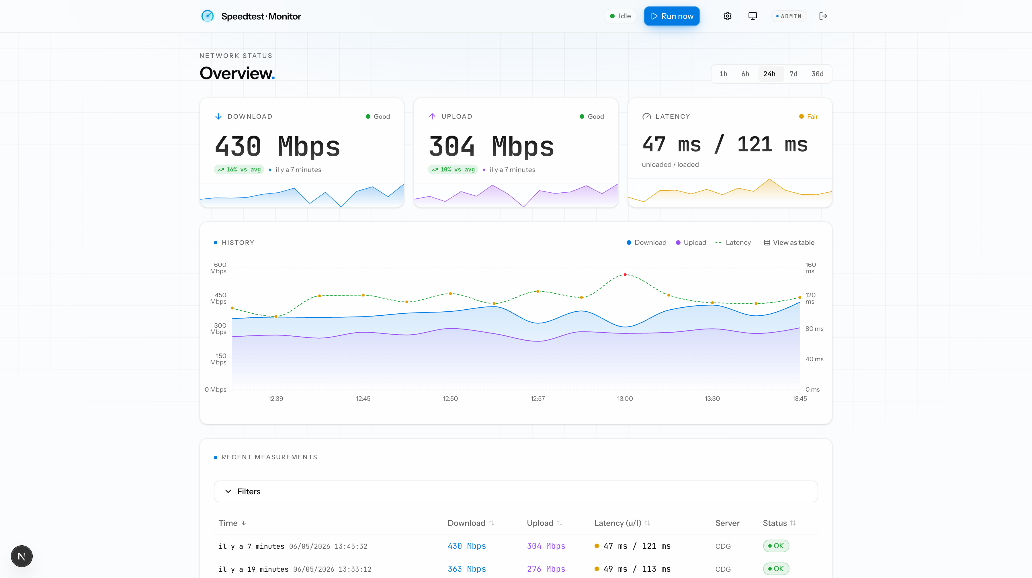

Self-hosted internet speed monitor. Runs Cloudflare Speed Test on a configurable schedule, stores every measurement in SQLite, and serves a dashboard with live updates over WebSocket. Includes alerts (webhook, ntfy, Discord, Slack, SMTP), authentication (local accounts and OIDC), and role-based access (admin / viewer). On first boot, set AUTH_SECRET (required) and BETTER_AUTH_URL (required when accessed behind a reverse proxy). Either set SPEEDTEST_ADMIN_EMAIL + SPEEDTEST_ADMIN_PASSWORD to seed the first admin, or visit /setup to create it from the UI. All other variables are optional. Data is persisted to /data (mapped to /mnt/user/appdata/speedtest-monitor by default).
Speedtest Monitor
Self-hosted internet speed monitor. Runs @cloudflare/speedtest on a configurable schedule, stores every measurement in SQLite, and serves a dashboard with live updates over WebSocket.
Dashboard
Stack
  • Runtime: Bun 1.x
  • Package manager: Bun 1.4
  • Framework: Next.js 16 (App Router) + TypeScript 7 + Biome 2 + Tailwind v4
  • UI: Astryx design system (@astryxdesign/core, exact-pinned) with a custom pre-built theme (lib/astryx-theme.ts -> bun run theme:build)
  • Custom server (server.ts): hosts Next.js and a ws WebSocket endpoint on the same port
  • Scheduler: plain setInterval, reprogrammable at runtime from the UI
  • DB: Drizzle ORM 0.45 + bun:sqlite (built-in)
  • Measurement engine: @cloudflare/speedtest (HTTP-only, no browser)
  • Tests: Bun native (bun test)
  • Runtime image: oven/bun:1-slim
