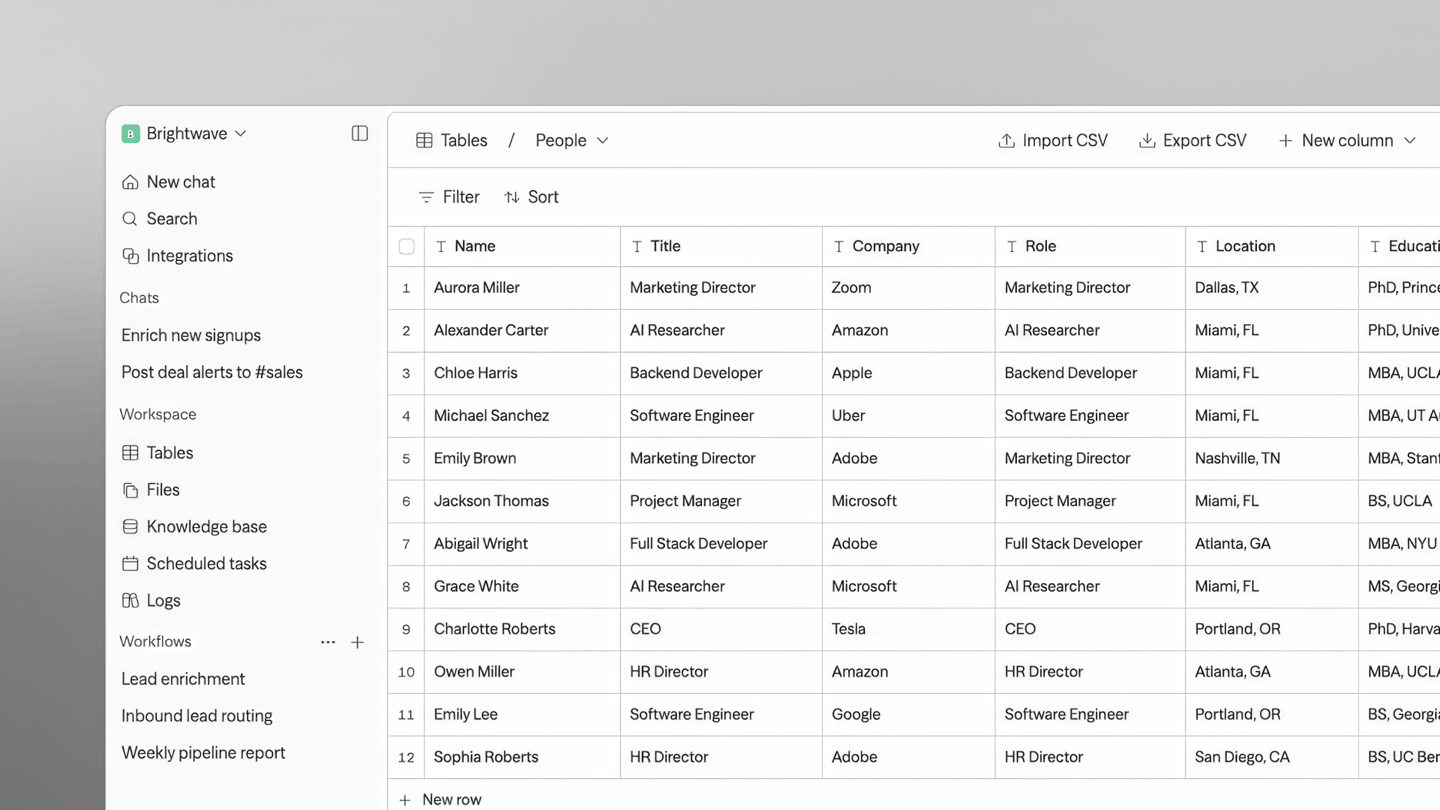

Tables in Sim — structured data your agents can query
Tables — a database, built in

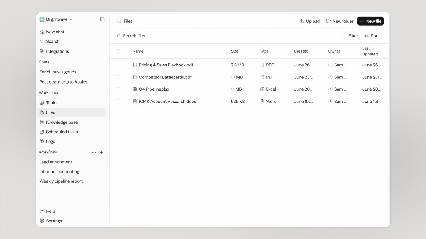

Files in Sim — documents for your team and every agent
Files — one store for your team and every agent

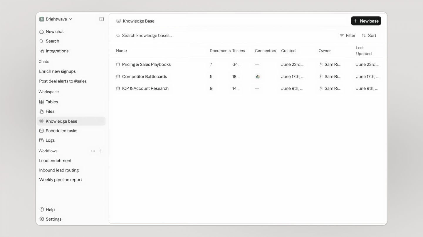

Knowledge bases in Sim — synced docs your agents can search
Knowledge — your agents' memory
