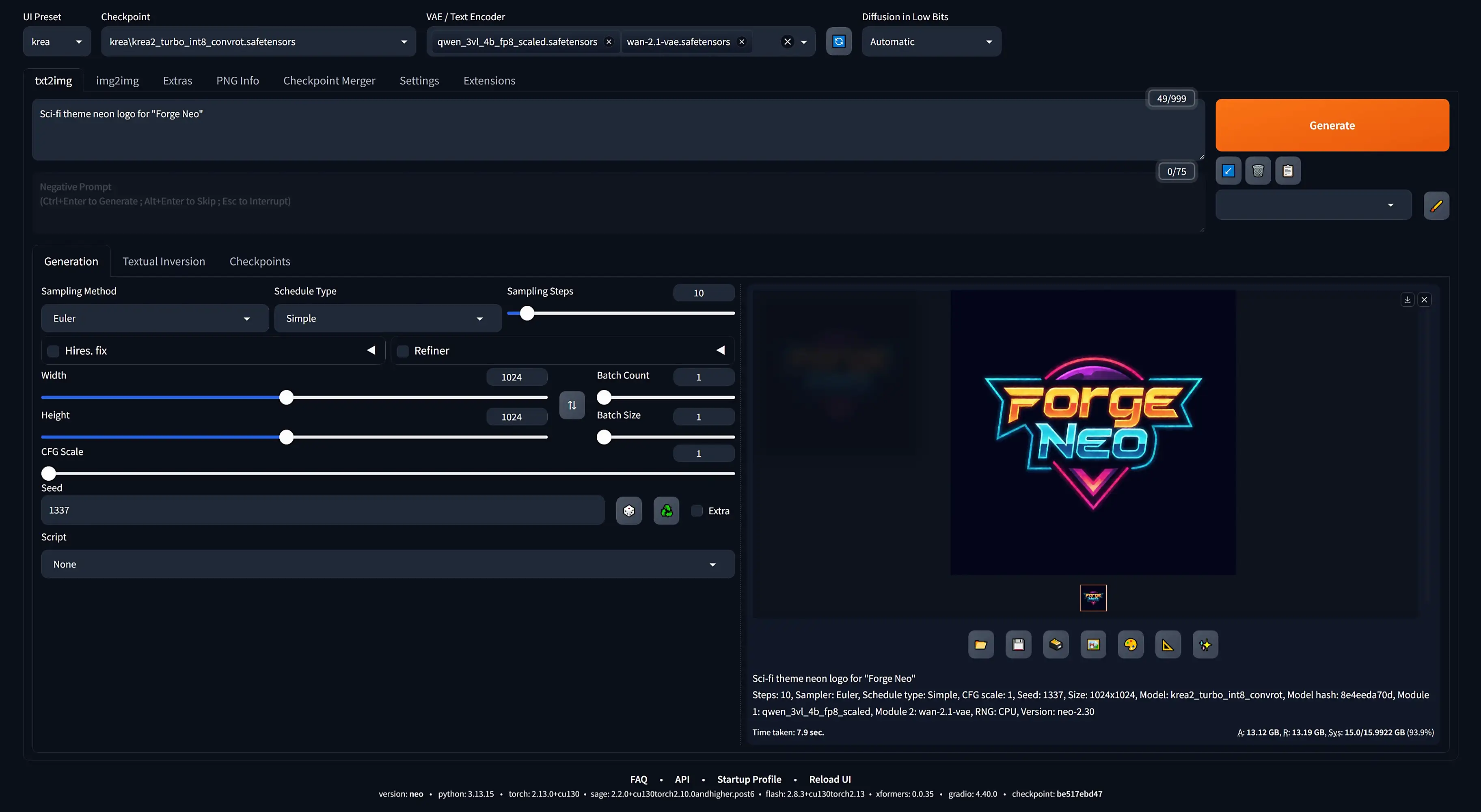

Stable Diffusion WebUI Forge - Neo
[ Neo | Classic ]
UI
Stable Diffusion WebUI Forge is a platform on top of the original Stable Diffusion WebUI by AUTOMATIC1111, to make development easier, optimize resource management, speed up inference, and study experimental features.

Attention Functions
[!Note] The --xformers, --flash, and --sage args are only responsible for installing the packages, not whether its respective attention is used (this also means you can remove them once the packages are successfully installed)
[!Caution] Do not just blindly install all of them
Nowadays the native PyTorch scaled_dot_product_attention is usually as fast, and also more stable
Forge Neo tries to import the packages and automatically choose the first available attention function in the following order:
  1. SageAttention
  2. FlashAttention
  3. xformers
  4. PyTorch
  5. Basic
[!Tip] To skip a specific attention, add the respective disable arg such as --disable-sage
