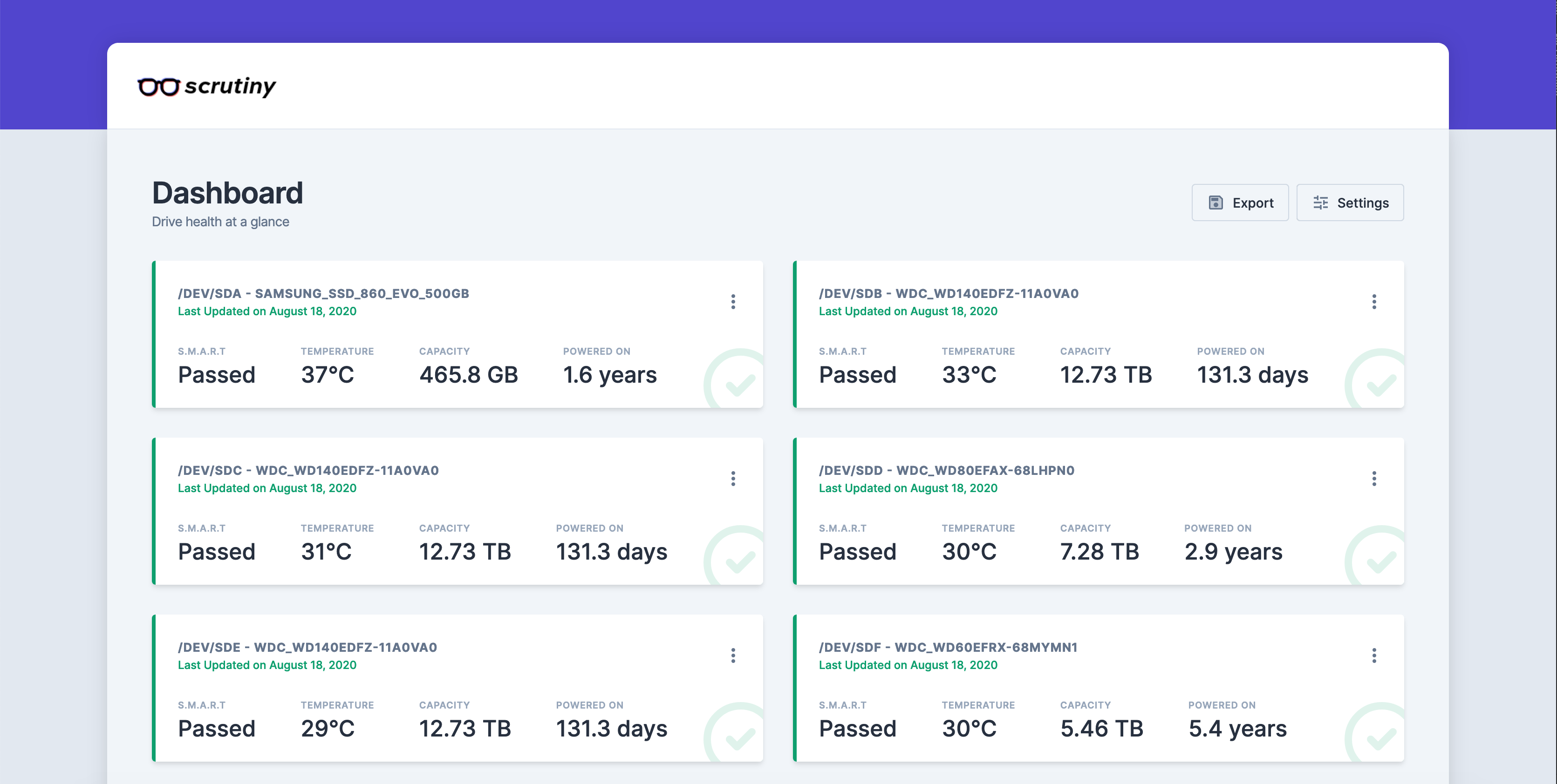

Scrutiny is a Hard Drive Health Dashboard & Monitoring solution, merging manufacturer provided S.M.A.R.T metrics with real-world failure rates.

Once scrutiny is running, you can open your browser to http://localhost:8080 and take a look at the dashboard.
If you're using the omnibus image, the collector should already have run, and your dashboard should be populate with every drive that Scrutiny detected. The collector is configured to run once a day, but you can trigger it manually by running the command below.
