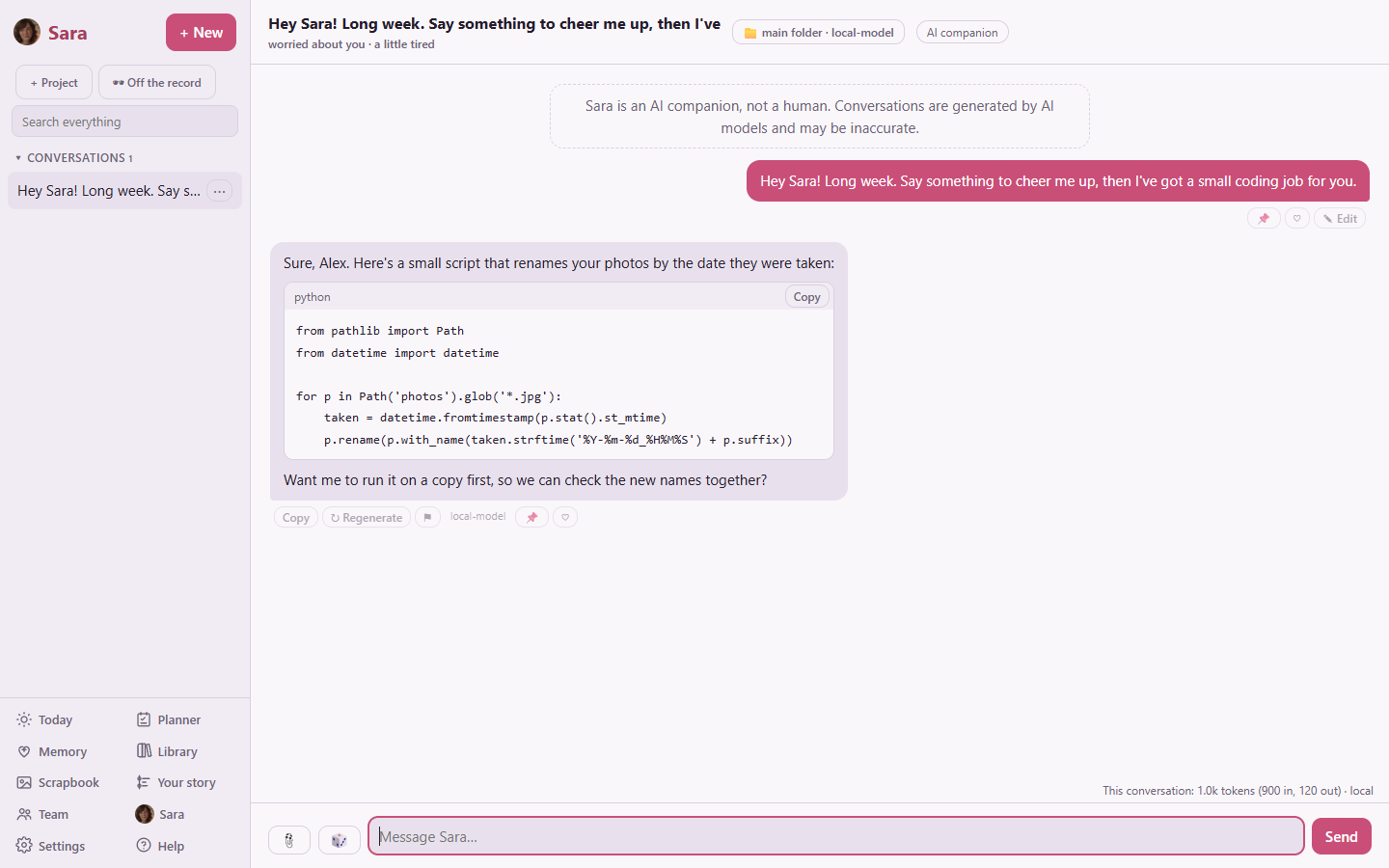

Overview
Sara is a self-hosted AI companion and coding partner: chat, memory, a planner, coding tools, photos and voice, all on your own server. You choose the AI model (local with Ollama, or your own provider account); your data and keys stay in her data folder. First start: open the WebUI within an hour and set Sara up in the browser with the 8-character setup code from the container's log (click the icon, then Logs; look for "setup code"). She then shows your owner token once: keep it in your password manager. Missed the hour? Restart the container for a new code. Lost the token later? docker exec Sara node src/main.ts --reset-token (then restart the container). Plain HTTP is fine on your home network; for access from outside, put an HTTPS reverse proxy in front and set Secure cookies and Trust proxy to 1.
Installing Sara
Sara runs on one server (Linux, Windows 10/11 or macOS 13+) for one owner. You need about 1 GB of disk for Sara itself, more for optional local voice (1.3 GB) and subscription programs (0.5 GB). A GPU is only needed if you want to run models locally with Ollama. How big a machine you need: REQUIREMENTS.md. Which model to pick: CHOOSING_A_MODEL.md.

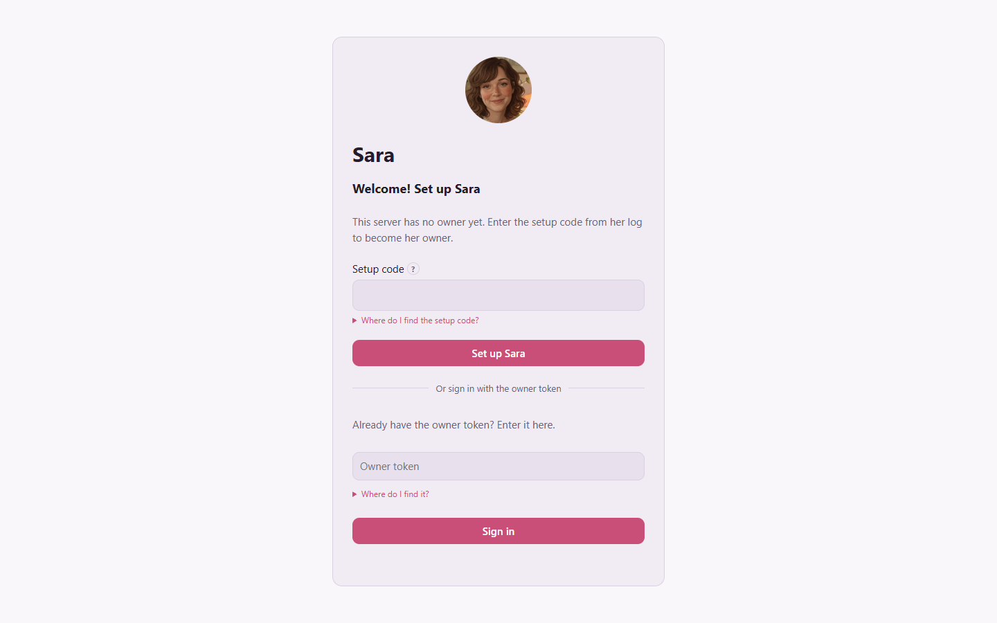

Signing in the first time
With "just this computer" (and after a manual install), Sara listens only on the server itself (127.0.0.1:7860), so nobody else can reach her until you set up HTTPS. For the first sign-in:
  • On the server's own desktop: open http://127.0.0.1:7860.
  • From your computer (a VPS, a headless box): open an SSH tunnel, then browse to it locally:
    ssh -L 7860:127.0.0.1:7860 you@your-server
    # leave that running and open http://localhost:7860
  • From your phone: use Tailscale or your own web address (sudo sara access), or set up HTTPS by hand (section 2).

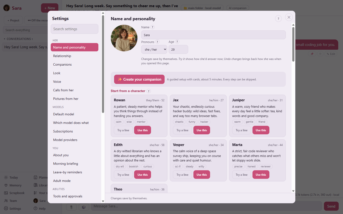

  1. Open your address, sign in with the owner token (or, on a new server, Set up Sara with the setup code from her log: see "The first sign-in" under Other ways to install), read and accept the disclosure.
  2. The setup guide opens: your name → keep Sara or make your own companion (name, she/he/they, relationship, vibe) → connect a model. It finds Ollama on the server by itself; otherwise paste an API key (OpenAI, Anthropic, xAI, OpenRouter, Ollama Cloud), point it at Ollama on another computer, or choose to sign in with a subscription afterwards.
  3. Say hi. Everything is in Settings later: Her (name, personality, relationship, look, voice), Models, You, Abilities, Connections, Data & health.
  4. Go through the security checklist (five minutes).
The native installer suggests bubblewrap if it is missing: with it, her shell runs in a sandbox that can only see her workspace (sudo apt install bubblewrap or sudo dnf install bubblewrap, then sudo systemctl restart sara).

SARA_SETUP code First sign-in in the browser on a new server: code (the setup code from her log), browser (no code; only behind a proxy that makes people sign in first, as Umbrel's does), off (owner token only)
SARA_SETUP_MINUTES 60 How long after each start browser setup stays open on a server nobody has signed in to yet (5–1440)

  • "Sara is NOT answering": sudo sara logs shows why; most often a port clash or a bad edit in /etc/sara/sara.env.
  • Can't open it from my computer: sudo sara access shows how she's reached. With "just this computer", use the SSH tunnel (section 1), or switch: sudo sara access tailscale.
  • Tailscale address doesn't open: the device you open it on must be signed in to the same Tailscale account, and HTTPS certificates must be on for your tailnet (https://login.tailscale.com/admin/dns → Enable HTTPS). Then sudo sara access tailscale again.
  • Own web address: no certificate: the address must point at this server and ports 80 and 443 must be open; sudo journalctl -u caddy -n 50 shows why Caddy couldn't get one.
  • Replies arrive all at once: your proxy buffers responses; turn buffering off (see above).
  • Signed in, but thrown out again right away (behind HTTPS): Sara doesn't know she's behind a proxy. Run sudo SARA_BEHIND_PROXY=1 /opt/sara-src/deploy/install.sh.
  • Settings → Data & health → Updates says it can't update / git "dubious ownership": the checkout isn't root's. Move it: sudo mv ~/sara /opt/sara-src && sudo chown -R root:root /opt/sara-src && sudo /opt/sara-src/deploy/install.sh.

The first sign-in works the same way for every container install (Docker, TrueNAS, Unraid, CasaOS, Proxmox's container): open her address within an hour of the first start and Sara offers Set up Sara. Type the 8-character setup code from her log (the app's log view in your dashboard; look for "setup code"), and she shows your owner token once to save. On Umbrel there is no code: Umbrel's own login already checked it's you, so it's one click. The setup code is new at every start, works only until someone has signed in, and only from this machine or your home network; missed the hour, restart the app for a new one. The owner token from the log works too, as before. Why this is safe: THREAT_MODEL.md, "First sign-in in the browser".
