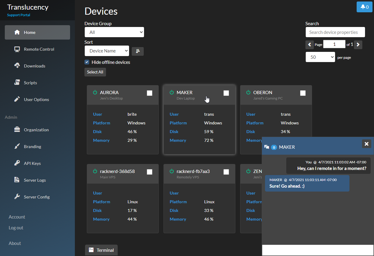

Overview
A remote control and remote scripting solution, built with .NET 6, Blazor, and SignalR Core.
Remotely
A remote control and remote scripting solution, built with .NET, Blazor, and SignalR Core.
Build Status Tests
