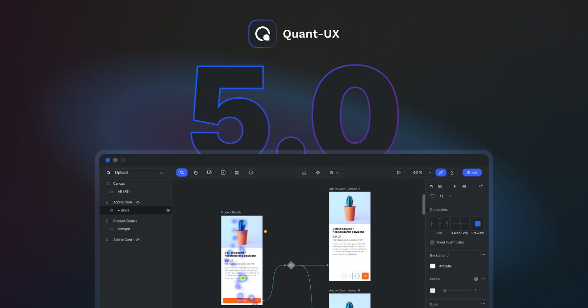

Quant-UX - Prototype, Test and Learn
Quant UX is a research, usability and prototyping tool to quickly test your designs and get data driven insights. This repo contains the front end. You can find a working demo at https://quant-ux.com/#/
Alt text
