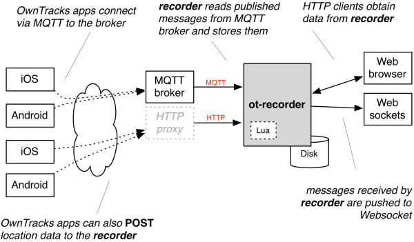

Architecture of the Recorder
There are two main components: the Recorder obtains data via MQTT subscribes or HTTP POST, stores the data in plain files and serve it via its built-in REST API, and the ocat command-line utility reads stored data in a variety of formats.
We developed the Recorder as a one-stop solution to storing location data published by our OwnTracks apps (iOS and Android) and retrieving this data. Our previous offerings (m2s, o2s/Pista) also work of course, but we believe the Recorder is best suited to most environments.
See also HOOKS.md, DESIGN.md, and STORE.md for more information on Lua hooks, program design, and storage layout, respectively.

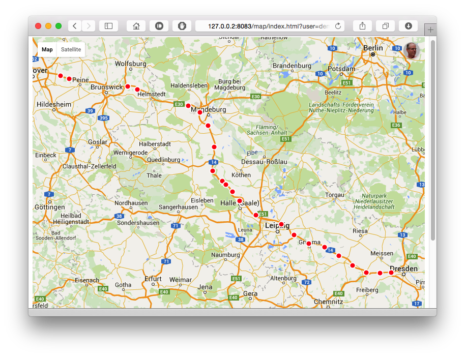

Display map with points starting at a particular date
By specifying a format we can produce GeoJSON, say. Normally, the API retrieves the last 6 hours of data but we can extend or limit this with the from and to parameters.
http://127.0.0.2:8083/map/index.html?user=demo&device=iphone&format=geojson&from=2014-01-01
In a suitable Web browser, the result is
GeoJSON points

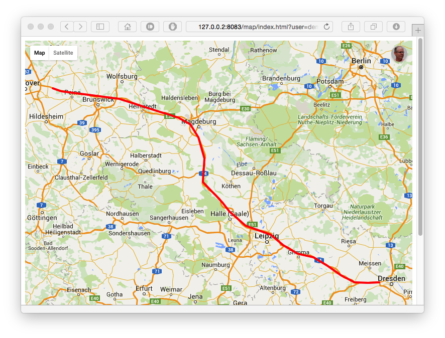

Display a track (a.k.a linestring)
If we change the format parameter of the previous URL to linestring, the result is
GeoJSON linestring

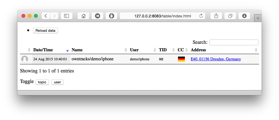

The Recorder's Web server also provides a tabular display which shows the last position of devices, their address, country, etc. Some of the columns are sortable, you can search for users/devices and click on the address to have a map opened at the device's last location.
Table

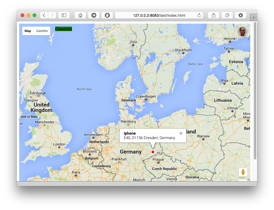

Live map
The Recorder's built-in WebSocket server updates a map as it receives publishes from the OwnTracks devices. Here's an example:
Live map

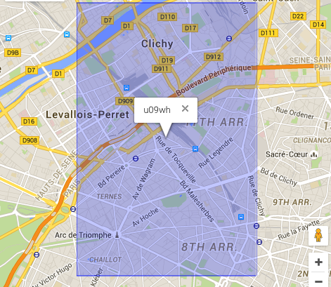

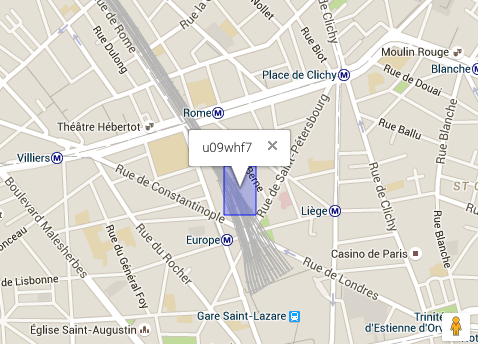

As an example, let's assume Jane's device is at position (lat, lon) 48.879840, 2.323522, which resolves to a geohash string of length 7 u09whf7. We can visualize this and show what this looks like. (See also: visualizing geohash.)
geohash7
Every location publish outside that very small blue square would mean another lookup. If, however, we lower the precision to, say, 5, a much larger area is covered
geohash5

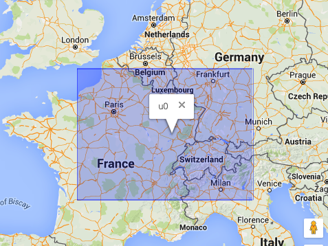

and a precision of 2 would mean that a very large part of France resolves to a single address:
geohash2
The bottom line: if you run the Recorder with just a few devices and want to know quite exactly where you've been, use a high precision (7 is probably good). If you, on the other hand, run Recorder with many devices and are only interested in where a device was approximately, lower the precision; this also has the effect that fewer reverse-geo lookups will be performed in the geocoding service infrastructure. (Also: respect their quotas!)

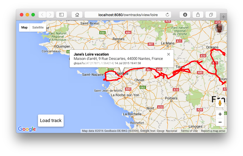

Suppose Jane wishes to have her acquaintances see where she is while on vacation. Jane knows she'll be en-route between 2015-06-29 and 2015-07-15. She creates a file called, say, loire.json in the views/ directory of the Recorder's document root:
  "user"  : "jjolie",
  "device": "phone",
  "page"  : "leafletmap.html",
  "from"  : "2015-06-29",
  "to"    : "2015-07-15"
Jane's friends can now visit the URL /view/loire (note the missing .json extension) to be served a map showing Jane's progress along the Loire valley (if that is where she's actually traveling through). Jane can keep that view up even after she returns because the view will not serve data after the 15th of July, in other words, her location at any other time before or after the from/to dates is hidden.
Jane's vacation

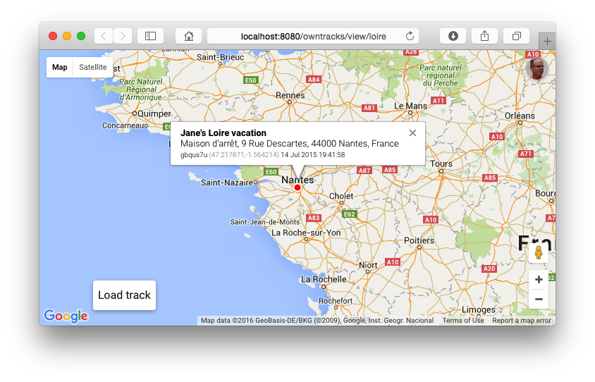

The default page we provide is called leafletmap.html; by default it refreshes the last position every 60 seconds, and clicking on "Load track" loads the GeoJSON track for the time frame specified by from and to.
Jane's vacation track

   "lon": -1.564214,
   "lat": 47.217871,
   "alt": 35,
   "vel": 0,
   "t": "L",
   "cog": 0,
   "tid": "K2",
   "tst": 1436895718,
   "ghash": "gbqus7u",
   "addr": "Maison d'arrêt, 9 Rue Descartes, 44000 Nantes, France",
   "locality": "Nantes",
   "isorcv": "2015-07-14T19:41:58Z",
   "isotst": "2015-07-14T17:41:58Z",
   "disptst": "2015-07-14 17:41:58",
   "page": "leafletmap.html",
   "user": "jjolie",
   "device": "phone",
   "from": "2015-06-29",
   "to": "2015-07-15",
   "label": "Jane's Loire vacation",
   "zoom": 7,
   "pathname": "/tmp/somewhere",
   "port": 9001
Note how pathname and port have been copied into the object. These values can be used by the page served in the view.
