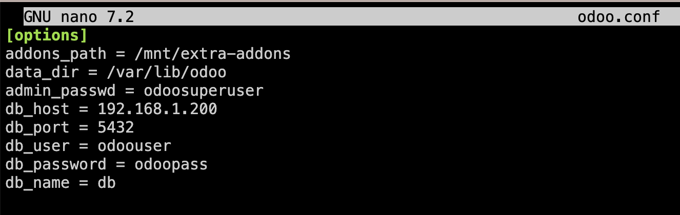

  1. The odoo.conf file needs to be copied in to the Config Location path on Unraid server
    The Config Location path is selected by you in the Odoo17 settings when installing in Unraid CA
    Your typical Config Location path may be at /mnt/user/appdata/odoo/config
  2. My odoo.conf file if you'd like to use it
    For my path (above), within the Unraid Shell / CLI:
  •     cd /mnt/user/appdata/odoo/config
  •     wget https://raw.githubusercontent.com/Eurotimmy/unraid-templates/main/Odoo17/odoo.conf
  •     nano odoo.conf
  1. The odoo.conf file needs to be edited and then your Odoo Docker container needs to be started / restarted:
  admin_passwd = (This password will become hashed on first start-up, for security reasons)
  db_host = (Use the IP address assigned to the PostgreSQL15 container, in the 'Docker' tab)
  db_port = (Enter what your PostgreSQL15 'Container Port' is set to, from your PostgreSQL install)
  db_user = (Enter what your PostgreSQL15 'POSTGRES_USER' is set to, from your PostgreSQL install)
  db_password = (Enter what your PostgreSQL15 'POSTGRES_PASSWORD' is set to, from your PostgreSQL install)
  db_name = (Enter what your PostgreSQL15 'POSTGRES_DB' is set to, from your PostgreSQL install)
