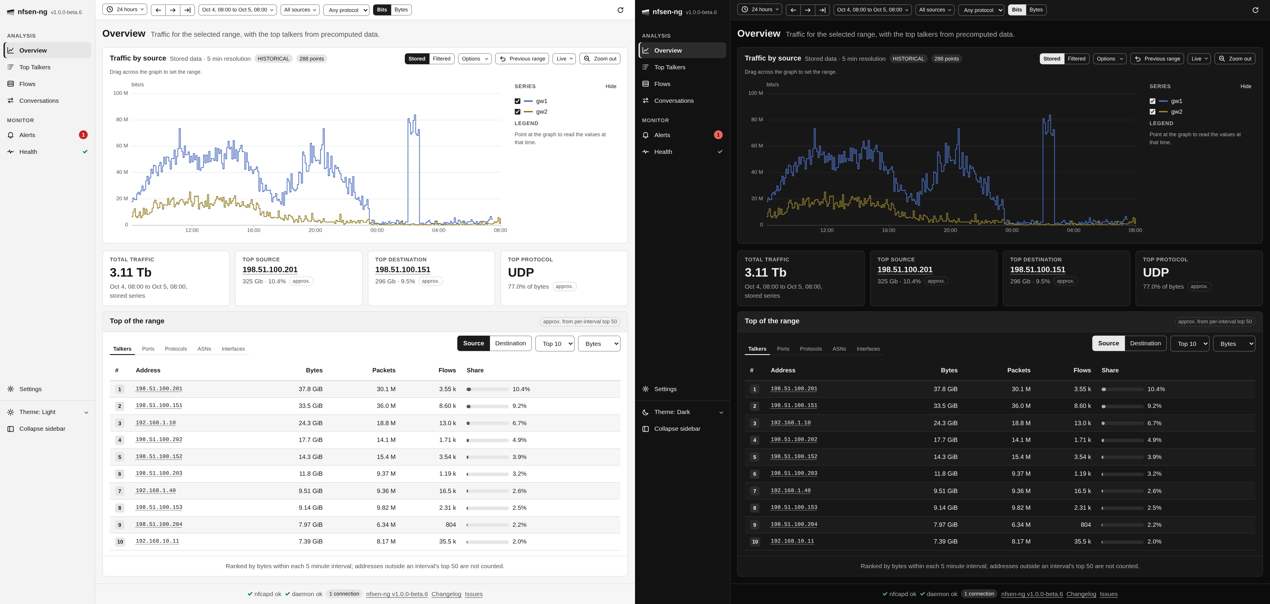

Seven pages. Four analysis pages share one time range: Overview (the traffic graph, key figures and the top talkers of the range, precomputed while importing), Top Talkers (exact top-N by any nfdump statistic), Flows (individual records, raw output and a summary), Conversations (who talks to whom as a Sankey, a Matrix or a table). Next to them sit Alerts, Health and Settings. Anything that reads capture files shows its cost first and runs only when you press Run.

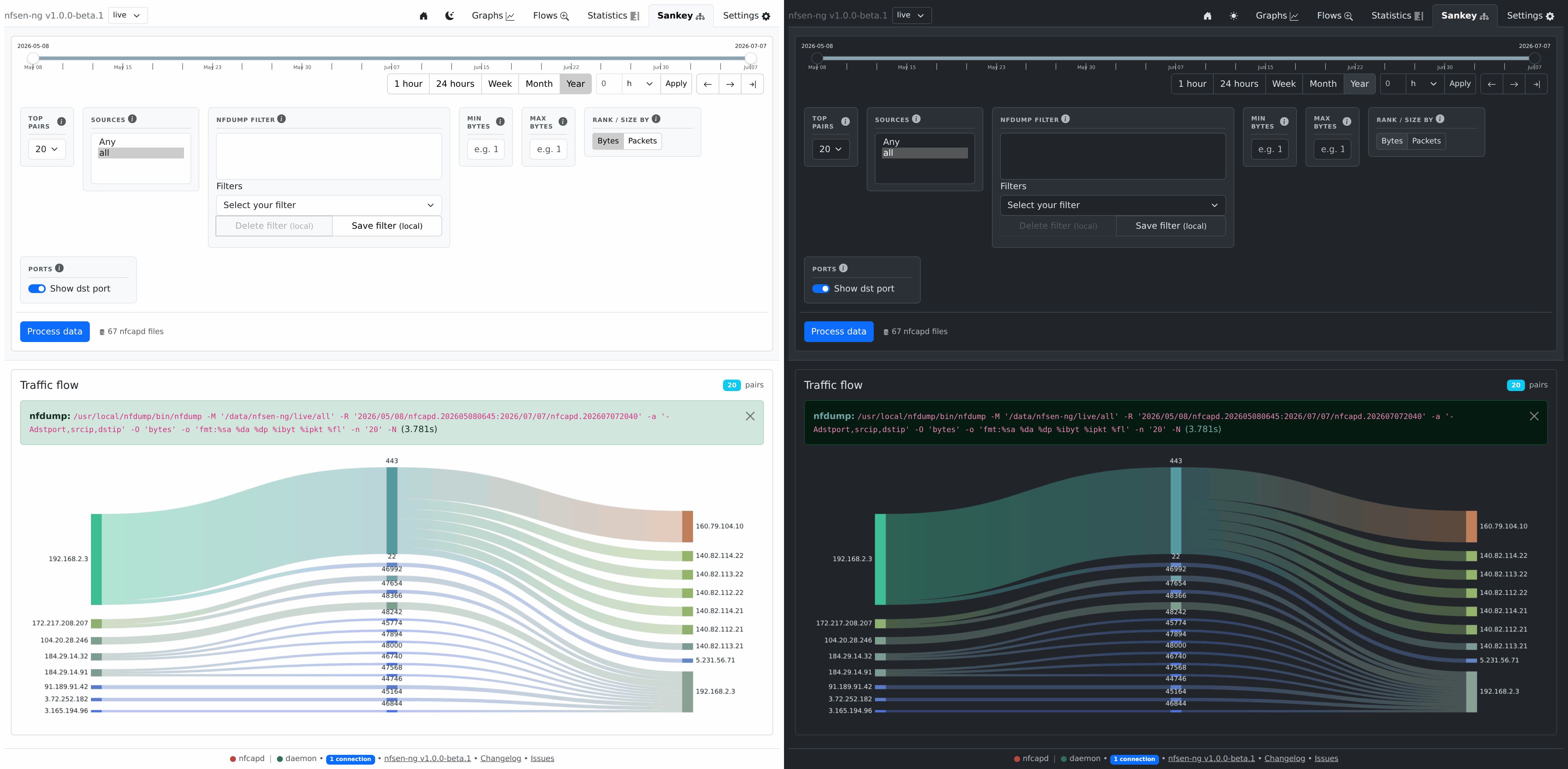

Conversations grouped by destination port: source IP, port and destination IP as a Sankey. The same result is also shown as a Matrix and a ranked table.
