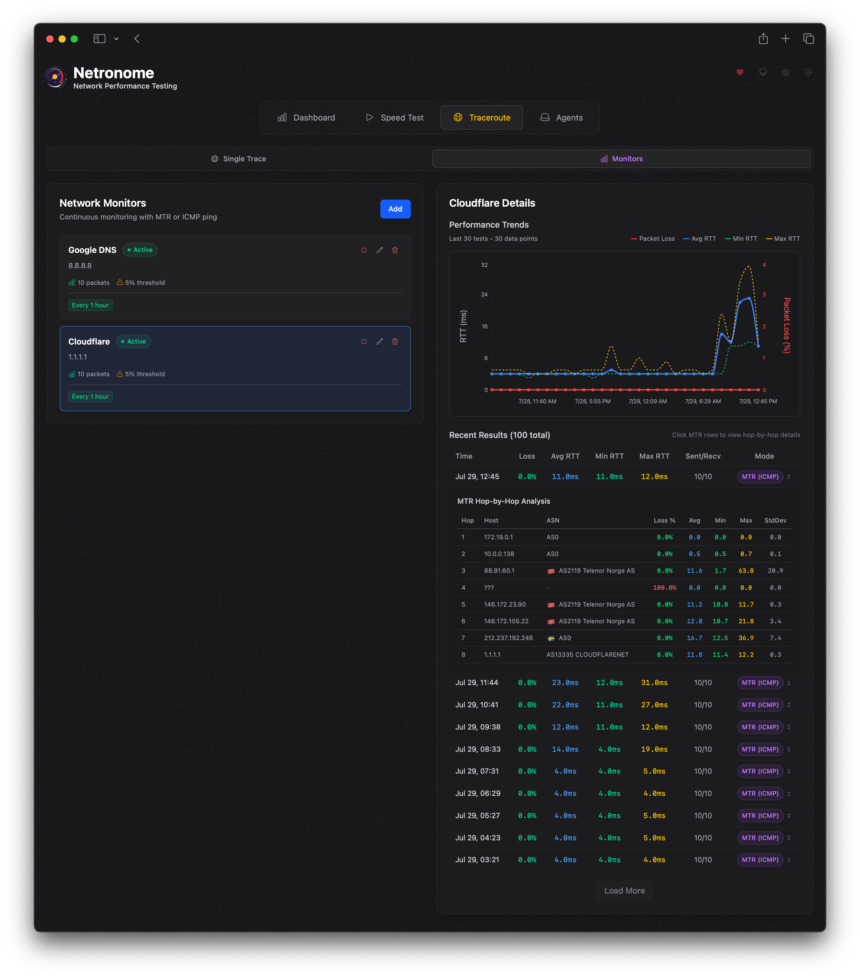

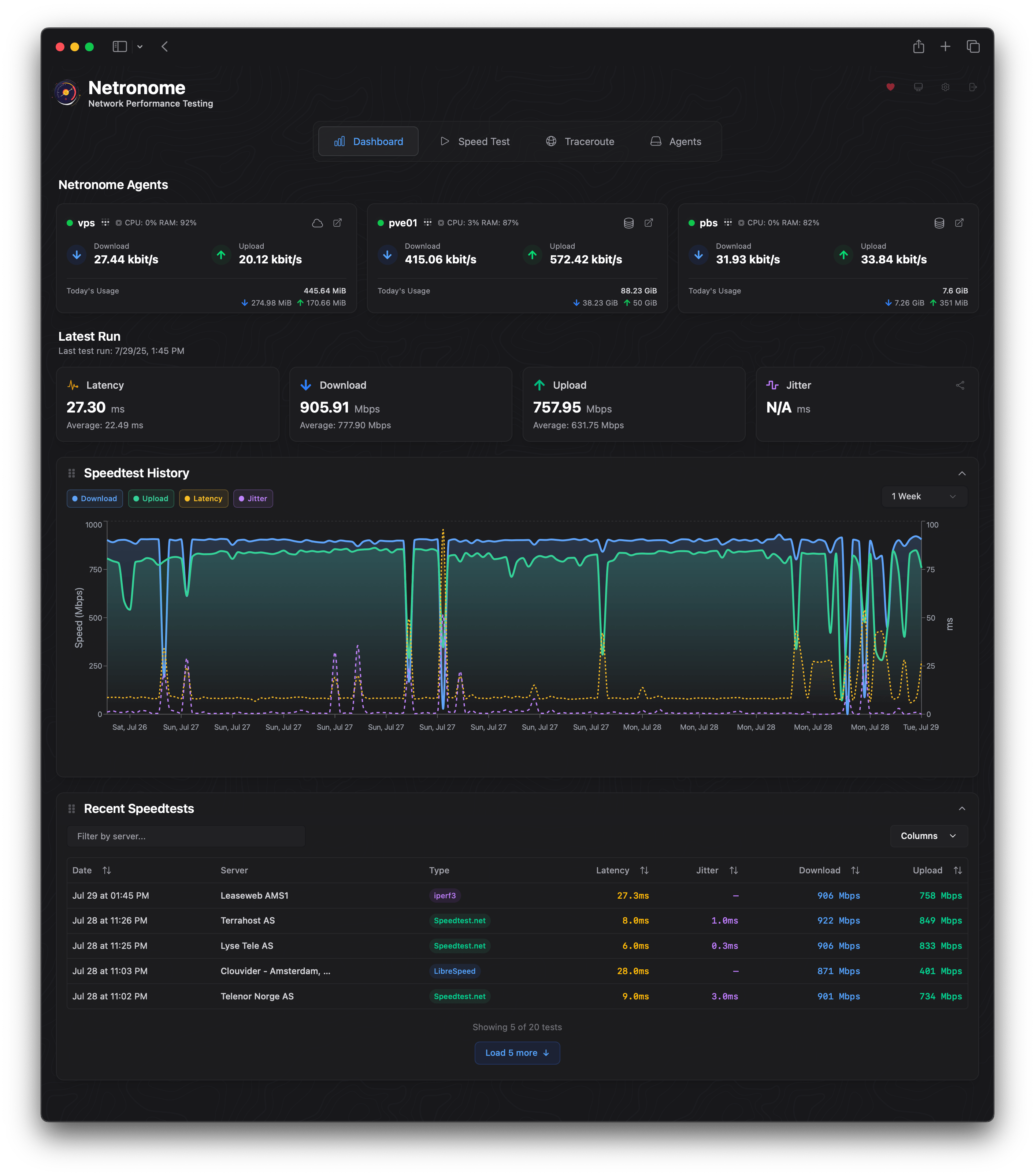

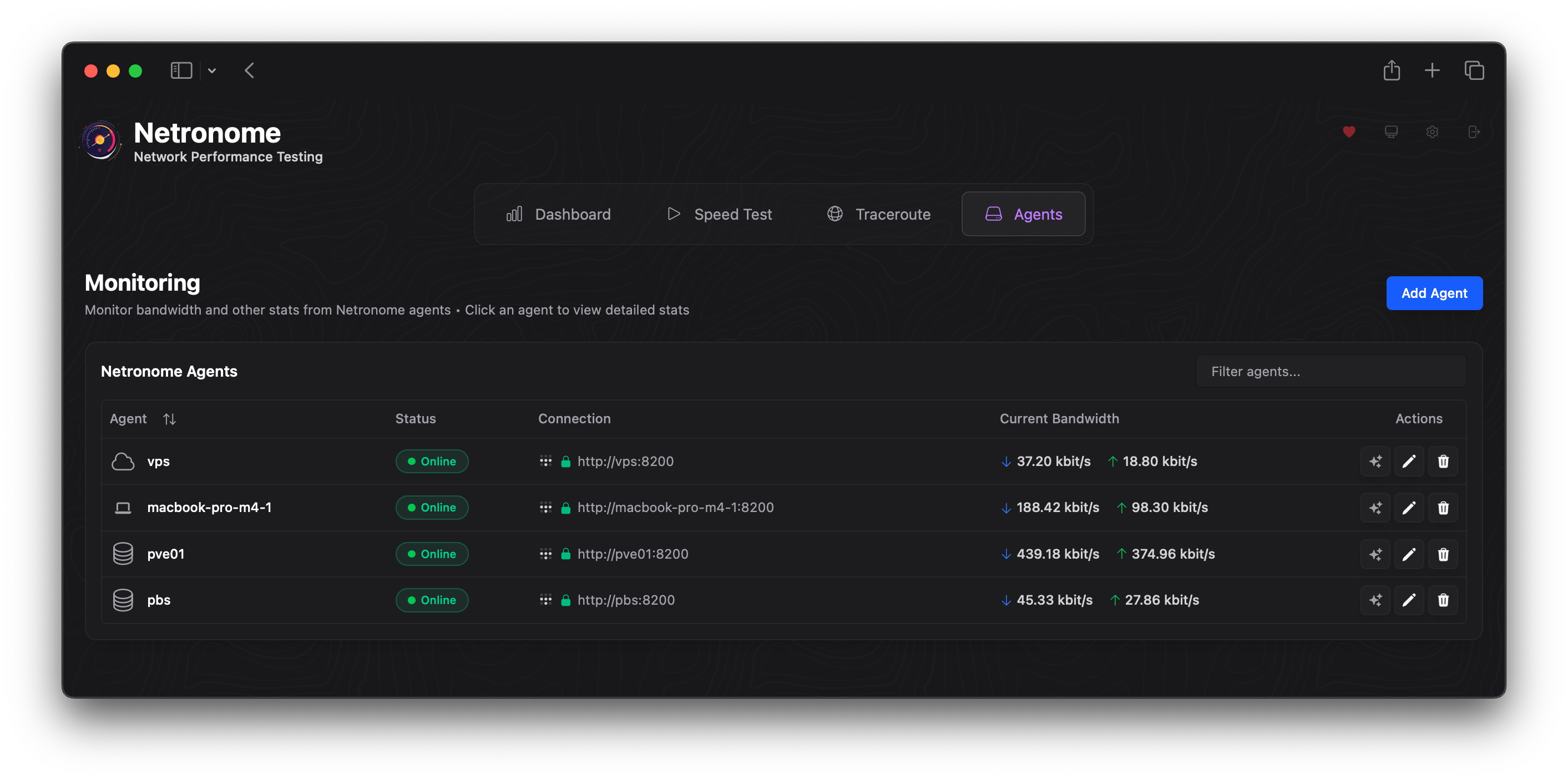

Netronome tests your network speed with Speedtest.net, iperf3, or LibreSpeed. It also traces routes and watches packet loss and DNS resolvers. Agents on your servers send it system and bandwidth data. When a value goes past a limit, you get a notification. One binary holds the server, the web interface, and the agent.
