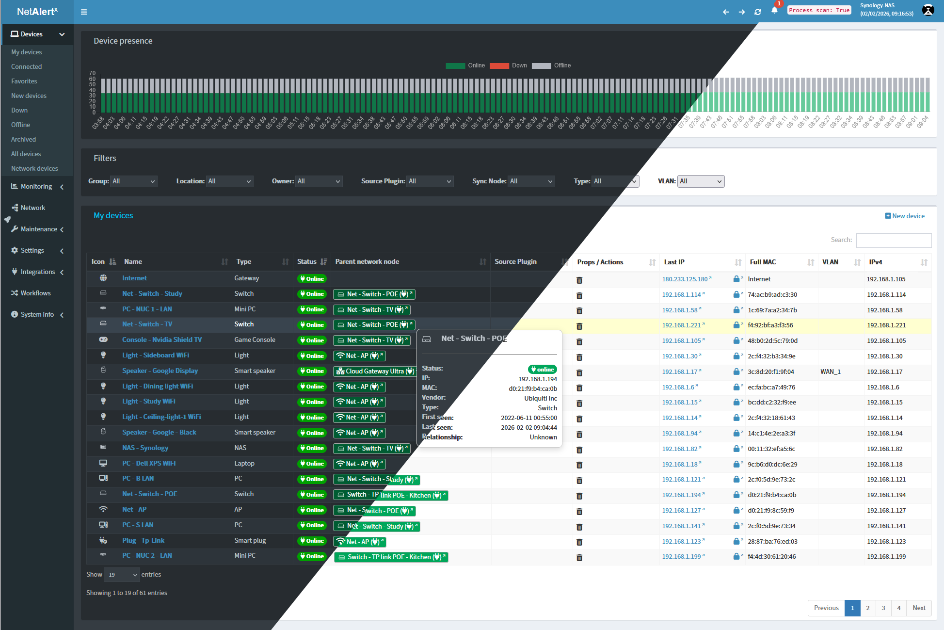

📷 Click for more screenshots

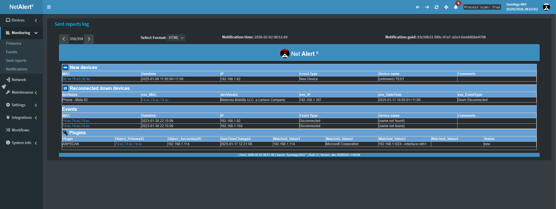

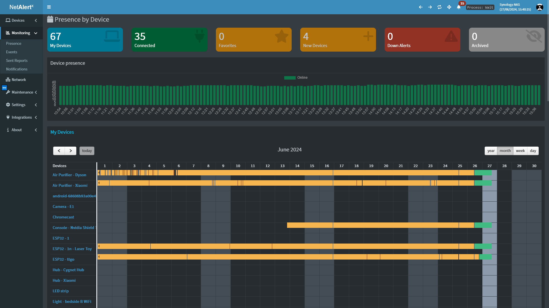

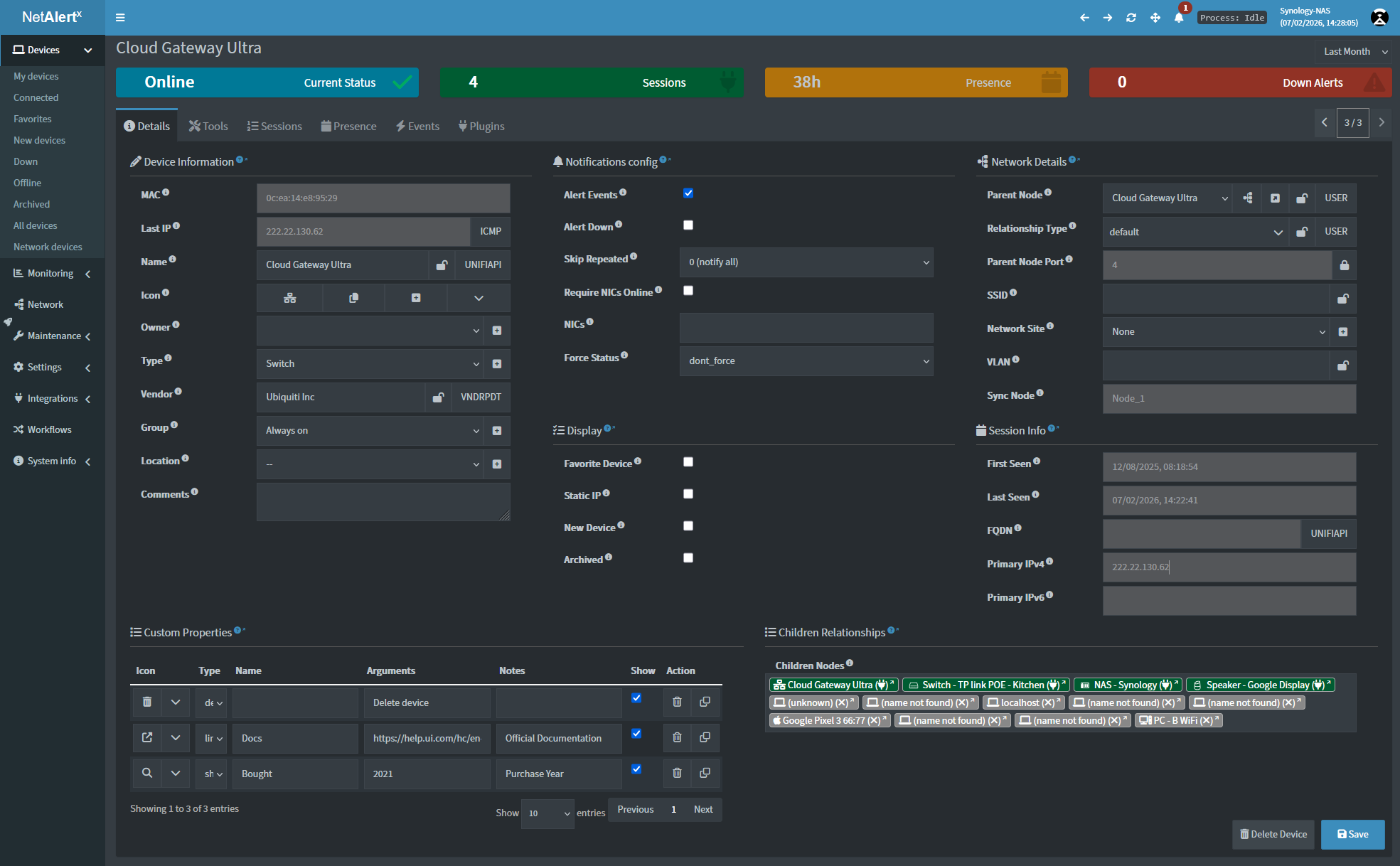

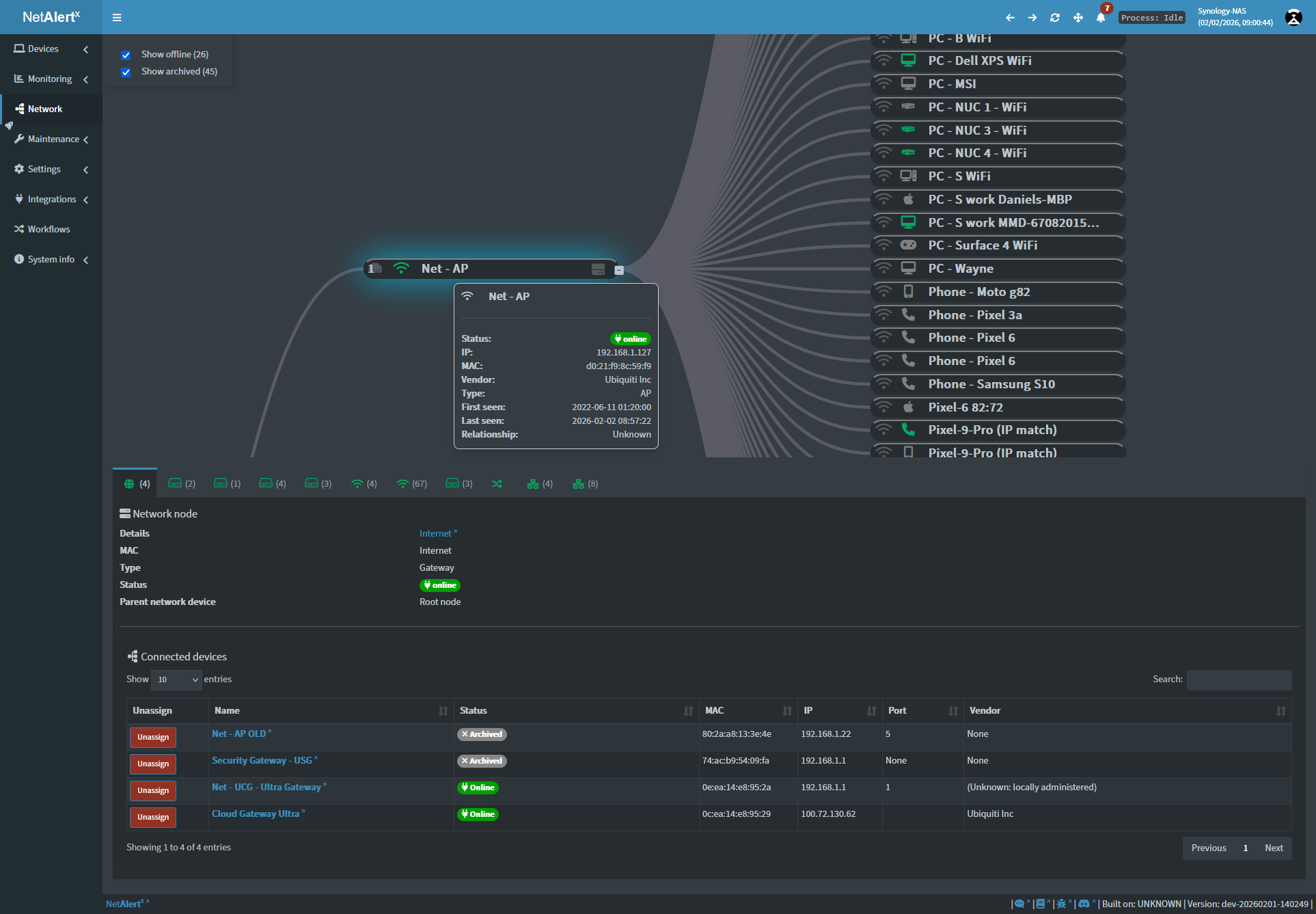

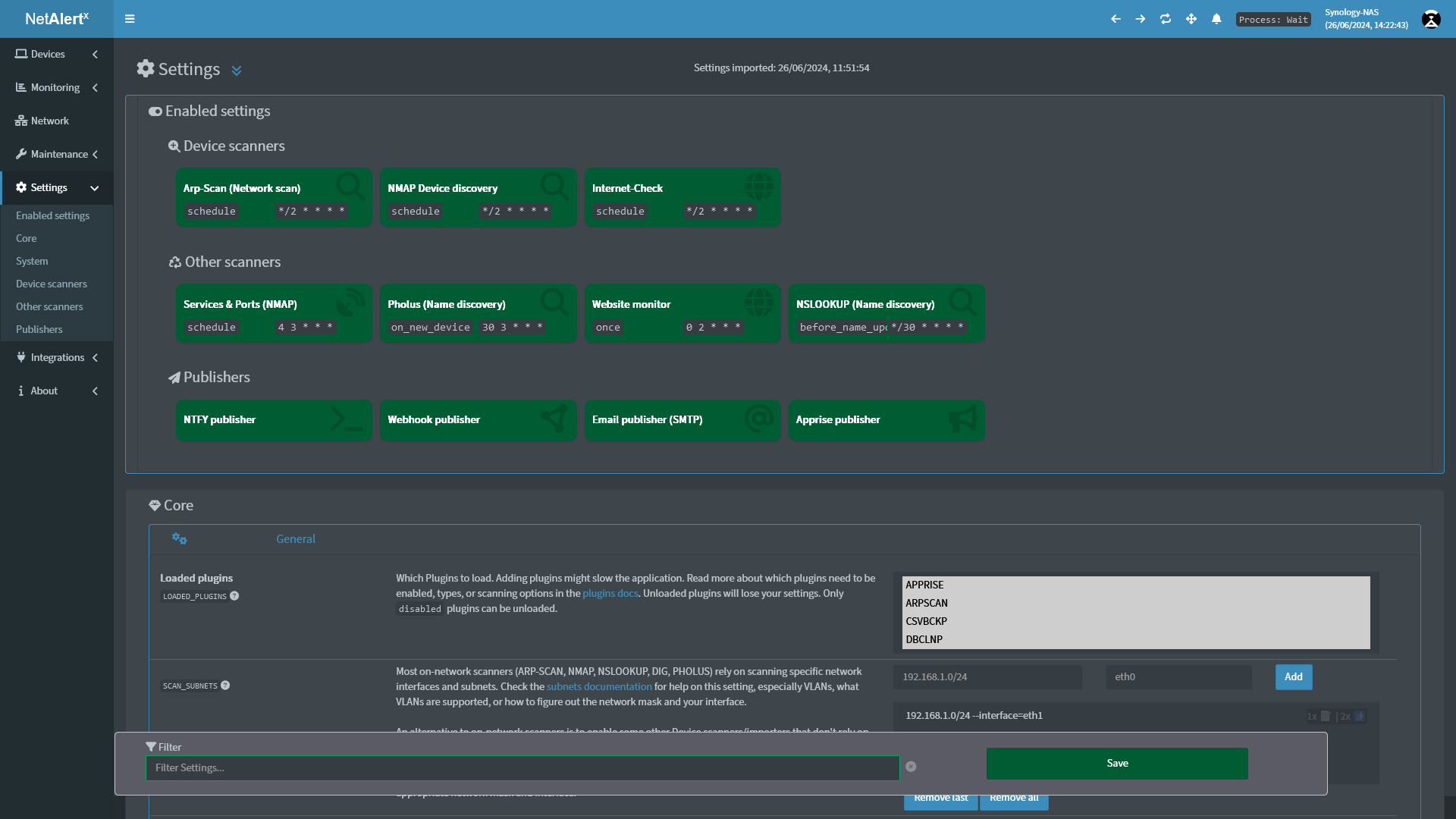

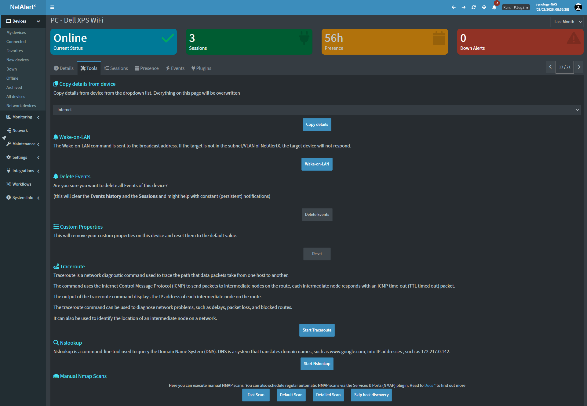

Main screen device_details 1 Screen network

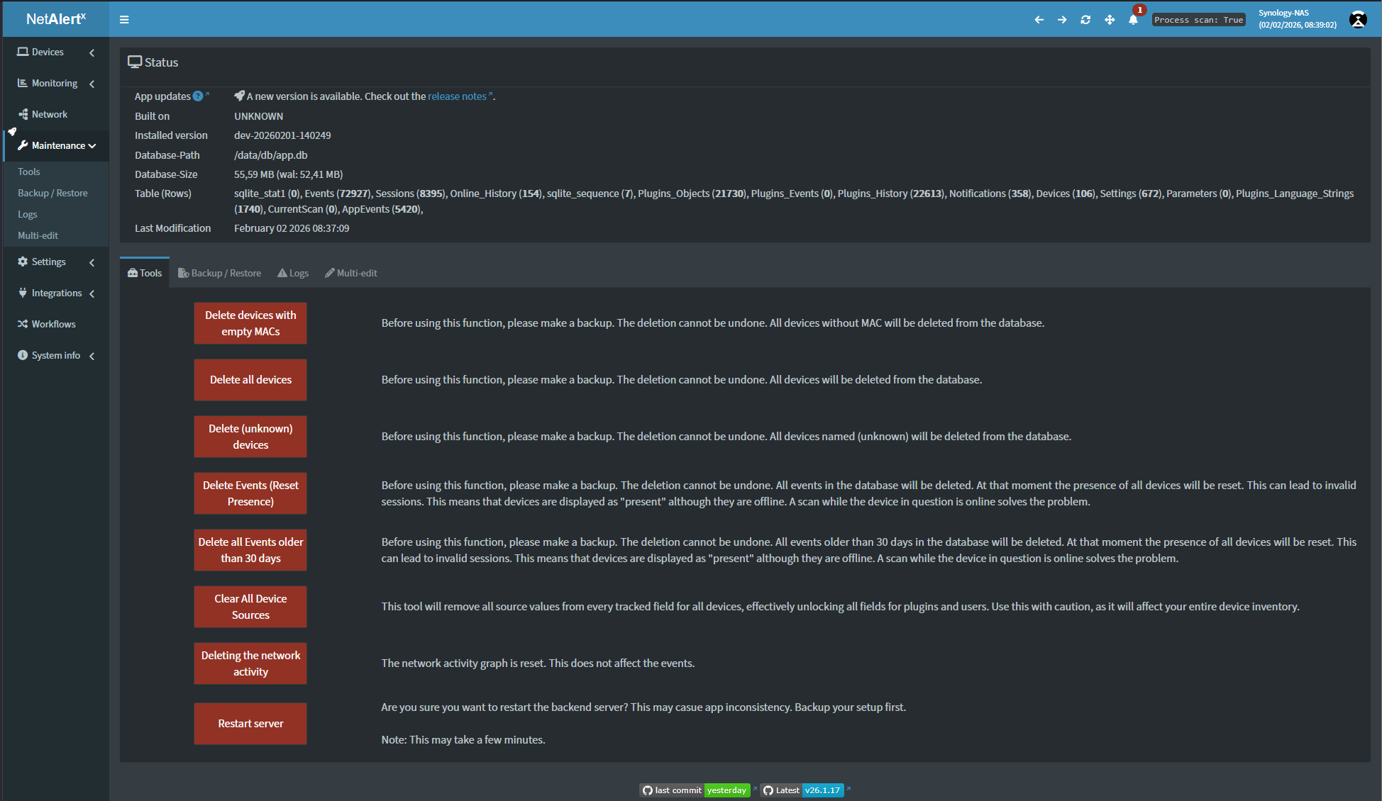

presence maintenance settings
sync_hub report1 device_nmap

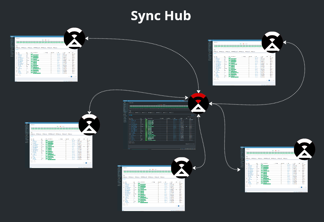

MSP & Multi-Site Monitoring
NetAlertX enables centralized monitoring across remote sites and isolated environments through Sync Nodes for VLANs and branch offices, providing unified visibility of assets across multiple networks. It supports NOC-style wallboard dashboards, Prometheus metrics export, workflow automation for device governance, and distributed discovery with centralized alerting for scalable network operations.

Designed for MSPs, NOCs & Distributed Networks
NetAlertX supports centralized monitoring across VLANs, branch offices, customer environments, isolated networks, and remote sites.
Using Sync Nodes, distributed collectors securely send device inventory and network visibility data back to a central hub, enabling unified monitoring, alerting, and asset tracking across all locations.
This provides MSPs and NOCs with a single operational view of many independent networks, without requiring direct access or centralized scanning infrastructure.
Common deployments include MSP wallboards, NOC dashboards, multi-site inventory monitoring, and remote office discovery.
