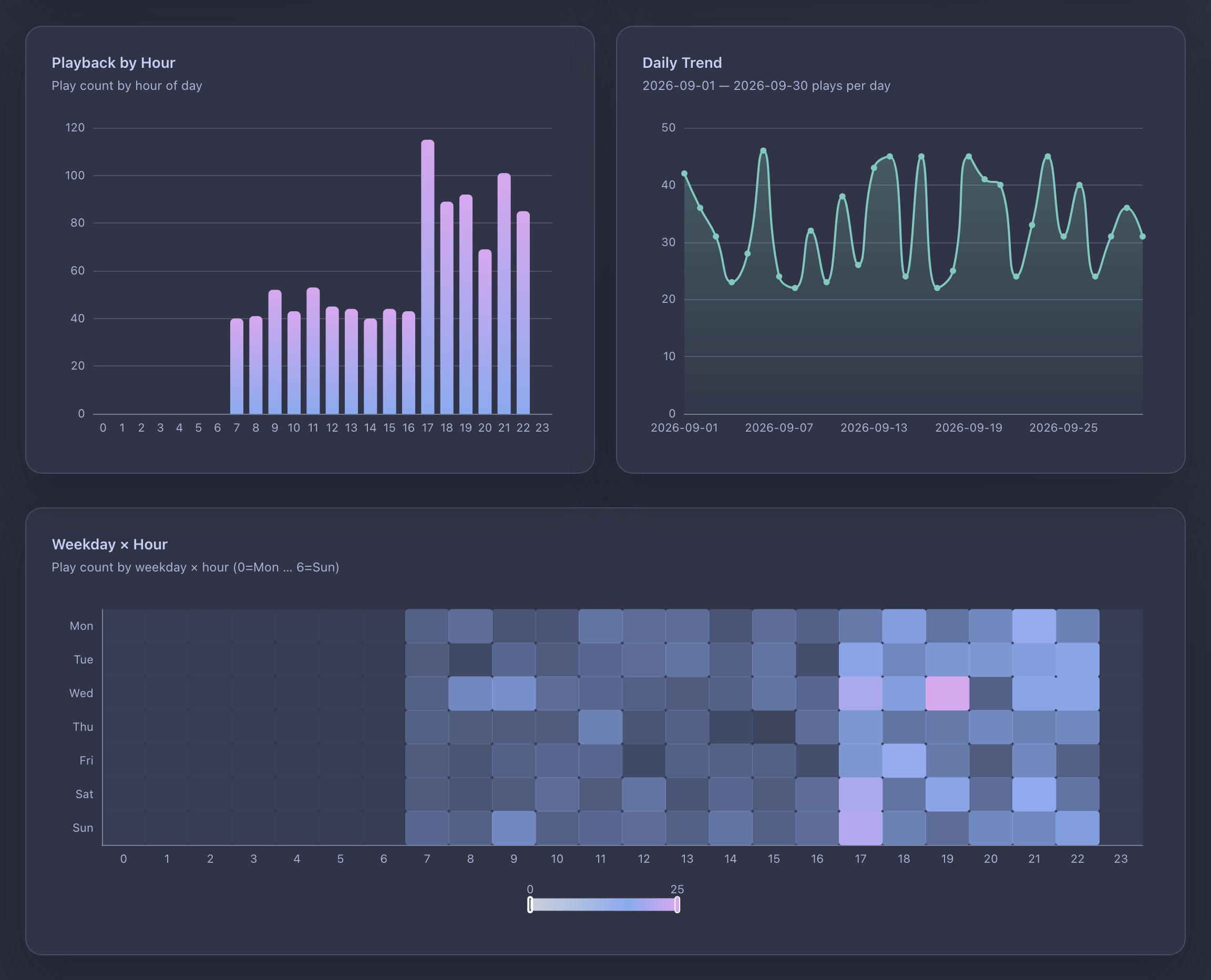

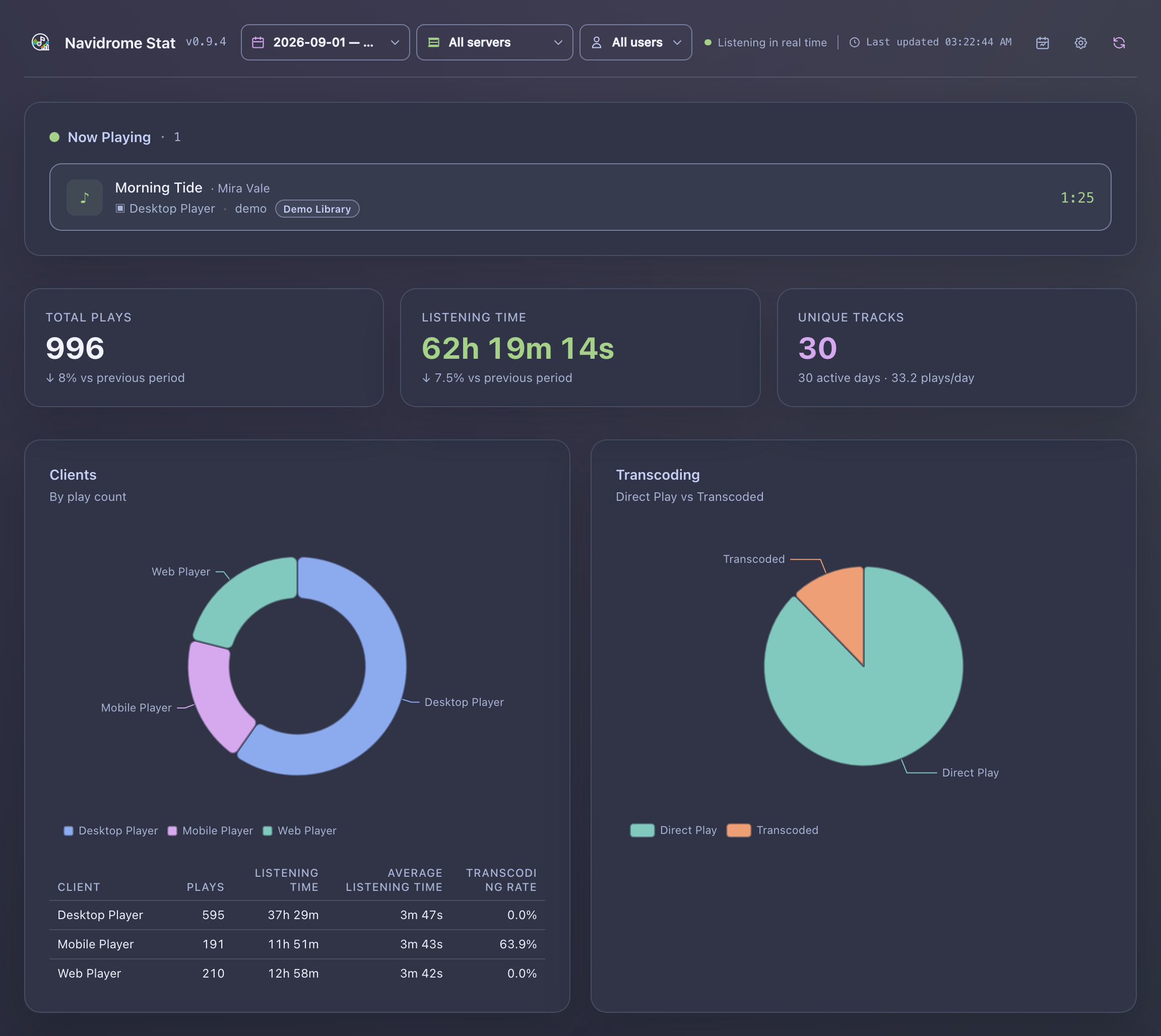

Self-hosted listening statistics for Navidrome. Explore playback history, artist and album rankings, listening charts, and monthly and yearly reviews across clients and servers. Uses a local SQLite database. Set a dashboard administrator token, then add your Navidrome servers in Settings > Connections after signing in. Recording depends on playback reported to Navidrome; installation does not recover a complete past history.
