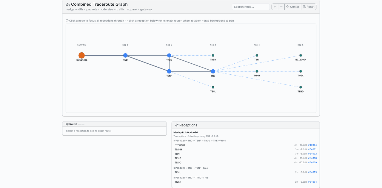

Malla is a web analyzer for Meshtastic networks based on MQTT data. This is the capture component.
Malla
Malla (Mesh, in Spanish) is an (AI-built) tool that logs Meshtastic packets from an MQTT broker into a SQLite database and exposes a web UI to get some interesting data insights from them.
Running Instances
Check out some instances with running data from community MQTT servers:
Features
🚀 Key Highlights
• End-to-end capture – Logs every packet from your Meshtastic MQTT broker straight into an optimised SQLite database.
• Live dashboard – Real-time counters for total / active nodes, packet rate, signal quality bars and network-health indicators (auto-refresh).
• Packet browser – Lightning-fast table with powerful filtering (time range, node, port, RSSI/SNR, type), pagination and one-click CSV export.
• Node explorer – Detailed hardware, role, battery and signal info for every node – searchable picker plus online/offline badges.
• Traceroutes – Historical list view to inspect packet paths across the mesh network.
• Map view – Leaflet map with live node locations, RF-link overlays and role colour-coding.
• Network graph – Force-directed graph visualising multi-hop links and RF distances between nodes / gateways.
• Toolbox – Hop-analysis tables, gateway-compare matrix and "longest links" explorer for deep dives.
• Analytics charts – 7-day trends, RSSI distribution, top talkers, hop distribution and more (Plotly powered).
• Single-source config – One config.yaml (or MALLA_* env-vars) drives both the capture tool and the web UI.
• One-command launch – malla-capture and malla-web wrapper scripts get you up and running in seconds.
