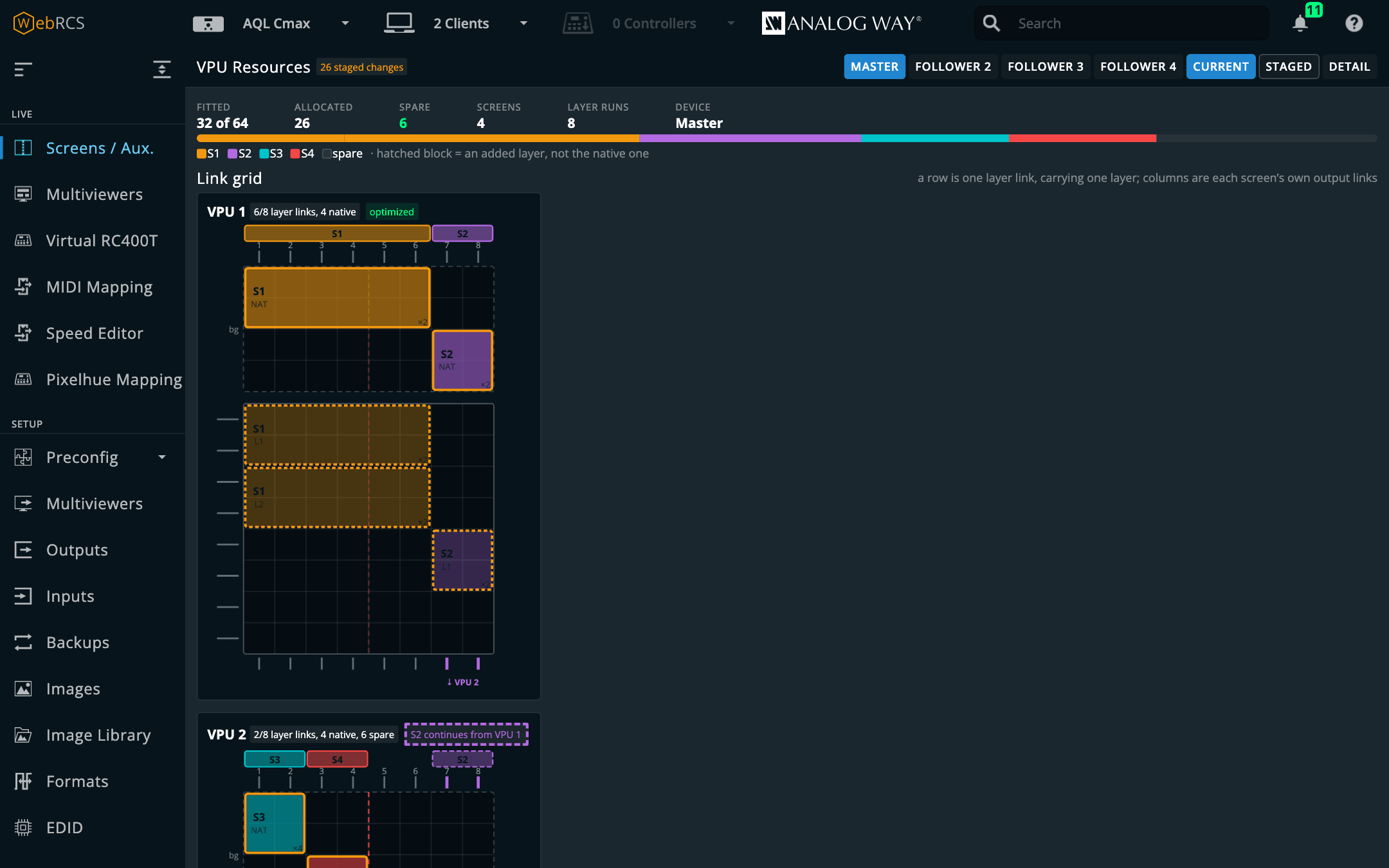

  • VPU Map — the device's mixing-resource allocation, drawn as a budget. Which units are fitted, who holds them, what is spare, and what a staged preconfig would change.

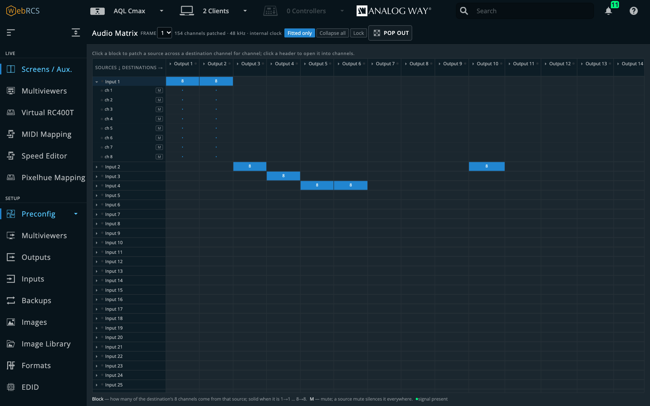

  • Audio Matrix — a LivePremier's audio channel matrix as a crosspoint grid: inputs and Dante down the side, outputs, Dante and multiviewers across. It opens as blocks (click one to lay a source across a destination 1→1 … 8→8, or clear it); a header opens into its eight channels for single crosspoints and mutes. Nothing lights until the switcher echoes it, there is a Lock for a live show, and it pops out. Simulator-proven only.

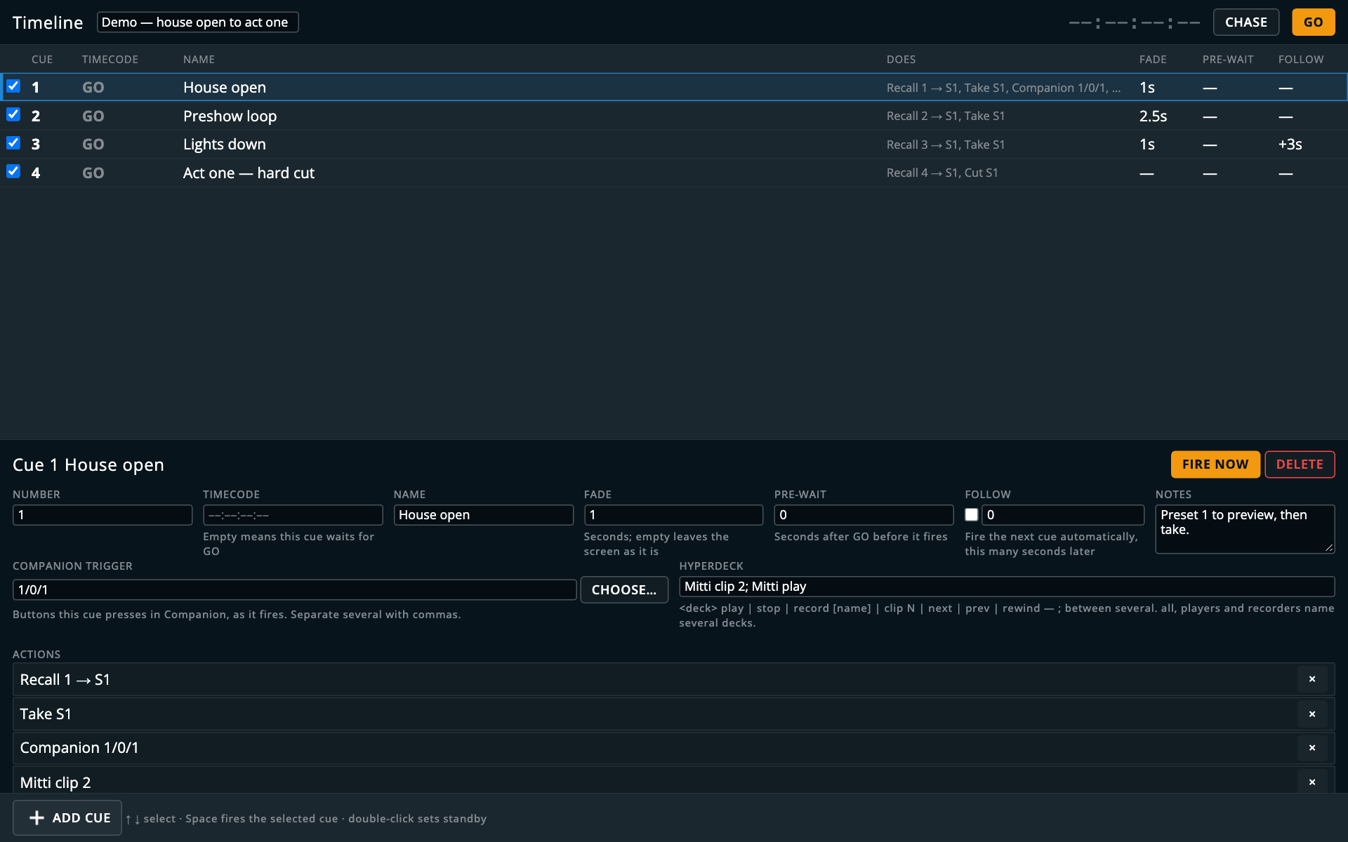

  • Timeline — a theatre-style cue stack. A numbered list that advances on one GO, with per-cue fade, delay and follow times, driving the switcher's preset recalls and TAKE. A cue can also carry a timecode and fire when MIDI Time Code, LTC from an audio input, or a timecode pushed from another machine passes it.

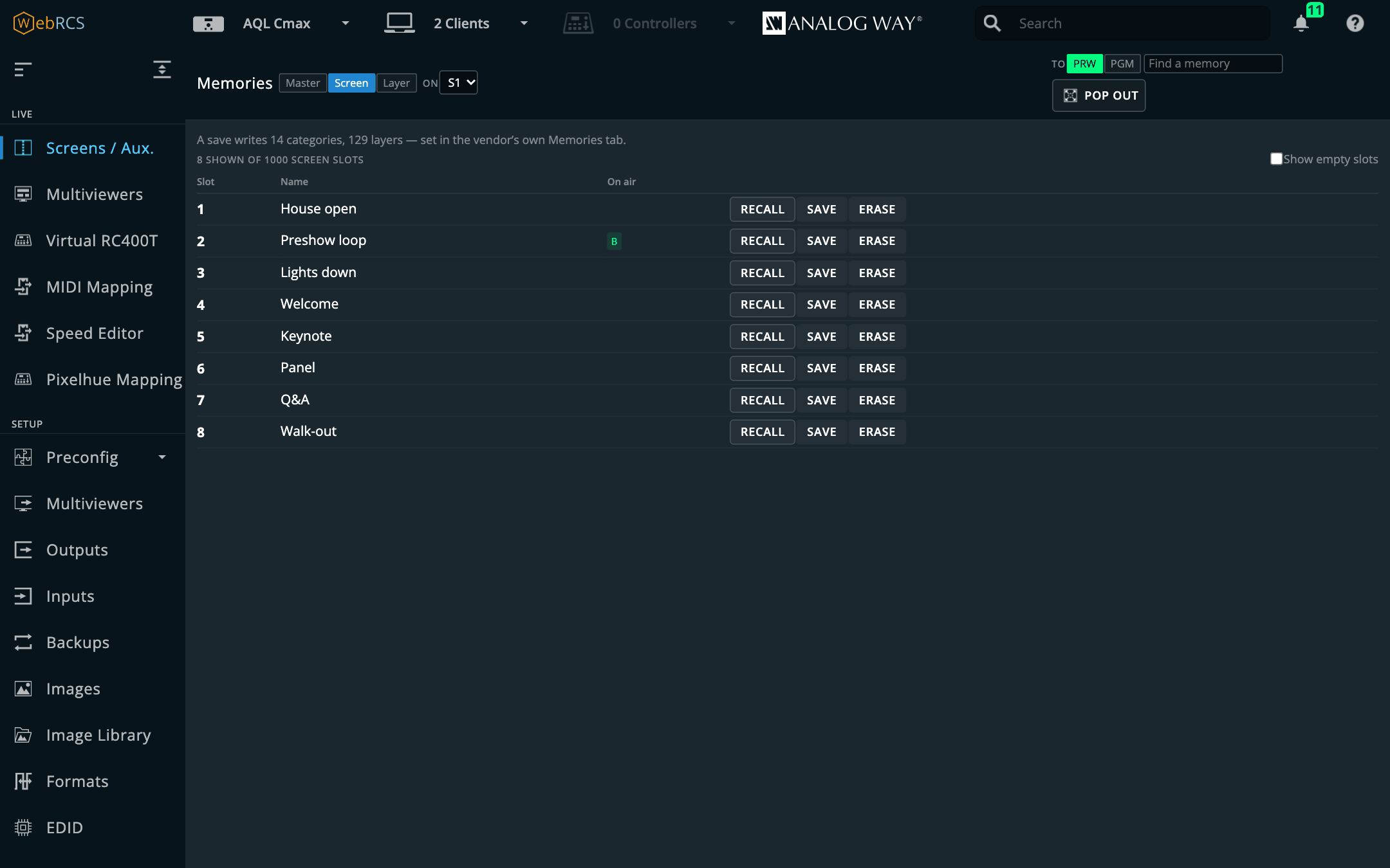

  • Memories — all three banks in one list: master, screen and layer, with search, renaming, and which buffer is holding each memory right now. Recall names its target buffer every time and never defaults to program. Pops out onto a second monitor.

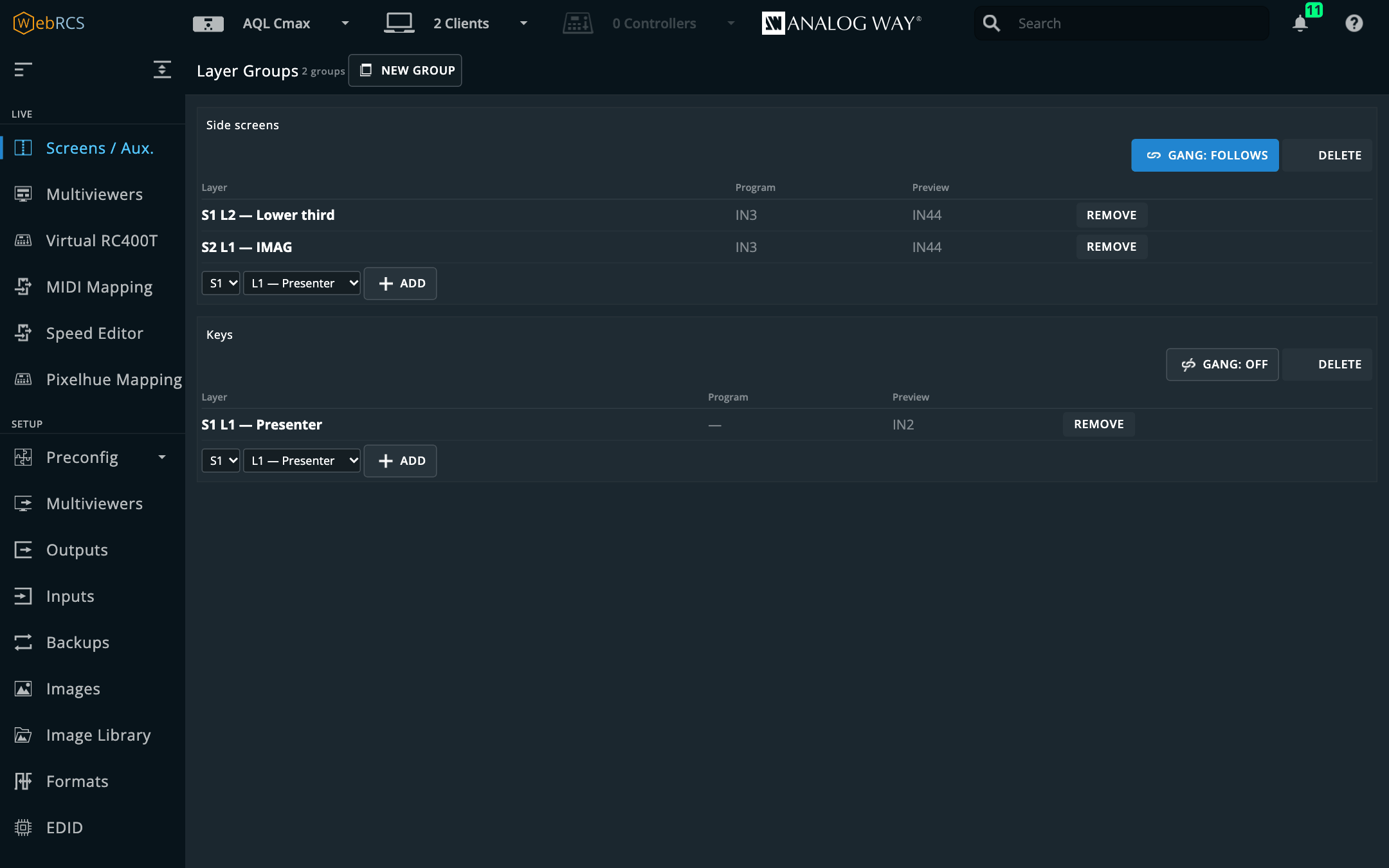

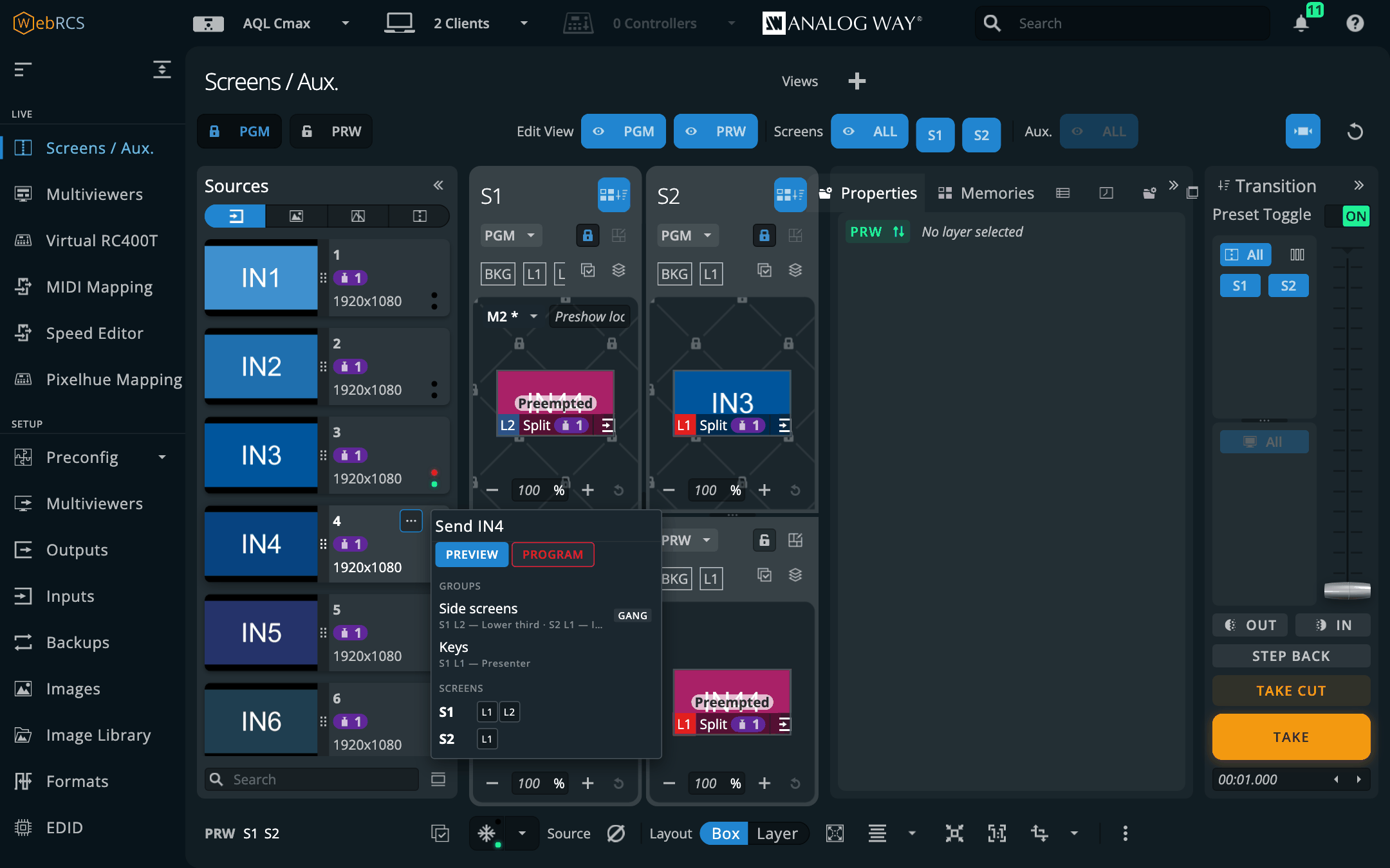

  • Layer Groups — several layers, on one screen or on many, driven as one. Layer 2 on screen 1 with layer 1 on screens 2 and 3 is the side screens, and a ganged group follows a source change made to any of its members, wherever that change came from.

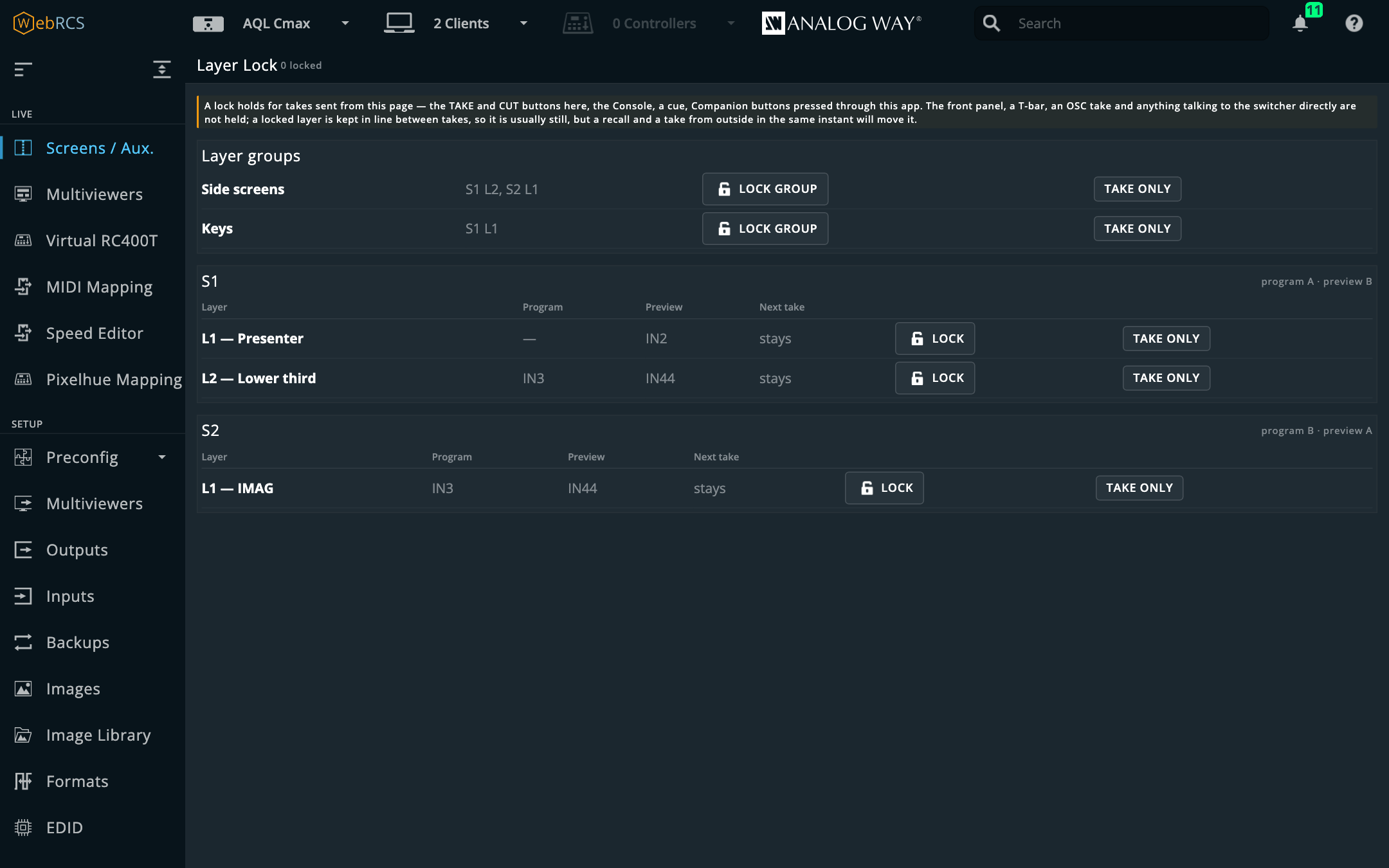

  • Layer Lock — lock a layer and a take leaves it where it is; or take one layer, or one group, alone. The switcher has neither: a take swaps the whole preset buffer. So a locked layer's preview copy is kept equal to program, and every TAKE or CUT sent from this page — the vendor's own button included — is held for the moment it takes to line it up. Takes from the front panel, a T-bar or OSC are not held, and the panel says so.
  • Preview lock during takes (off until you switch it on) — press TAKE and recall the next memory a moment later, and the switcher loads it into the buffer that is fading up, so it rides the take onto program. This shuts the vendor's own PRW padlock on a screen's card for as long as that screen is transitioning, so Web RCS refuses the recall with its own warning, and opens it again when the take lands. It never opens a padlock you shut yourself. This app's own recalls — Timeline cues, the Memories panel, the Console — wait instead: a recall into a preview that is mid-take goes the moment the take lands, and cues fire in the order GO was pressed. Companion, OSC and the front panel are not held back.
  • Send to — a … on every source card that routes it without a drag: preview or program, then a screen and layer or a whole group. It respects the vendor's own PGM padlock, asking before it steps past one.

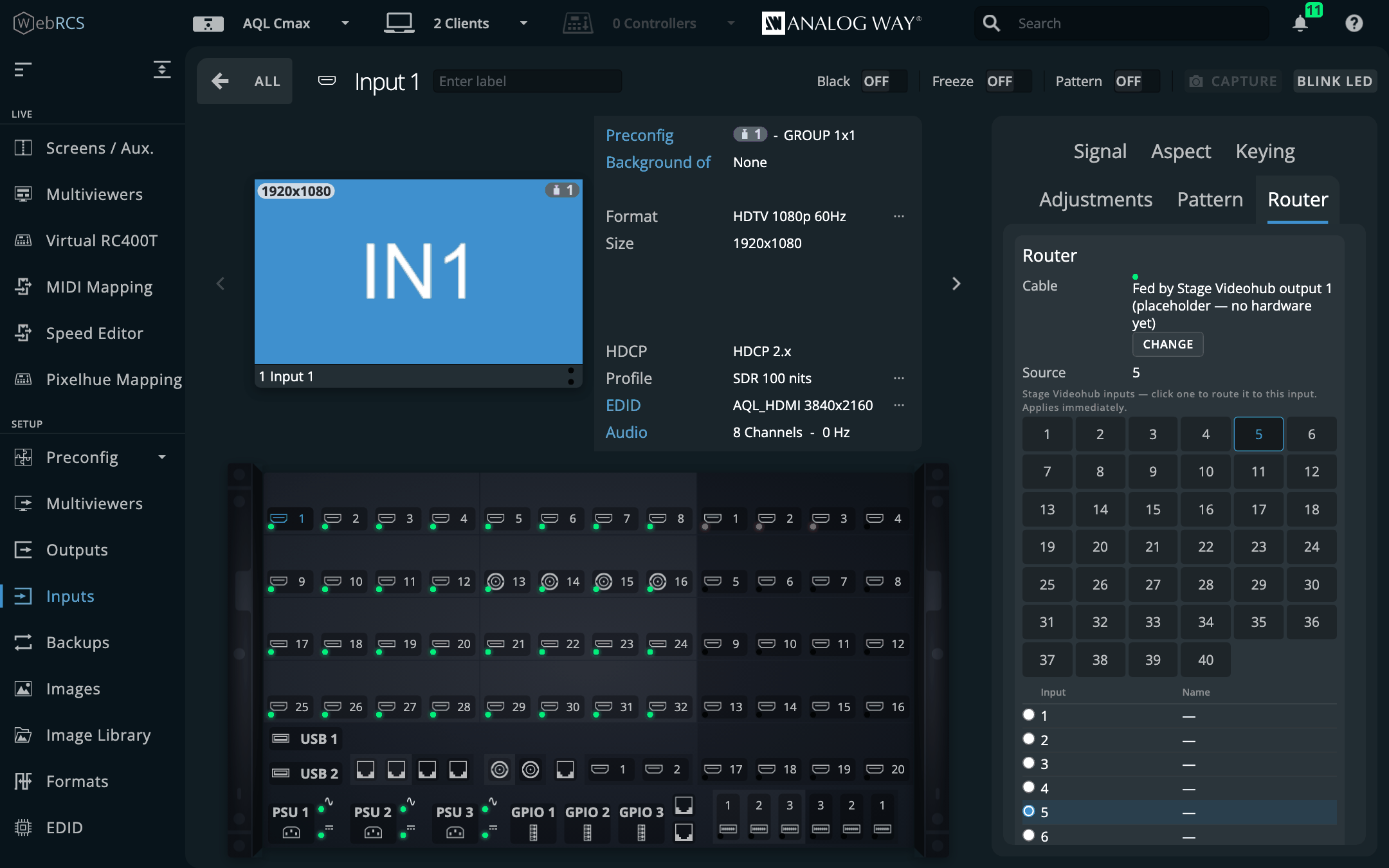

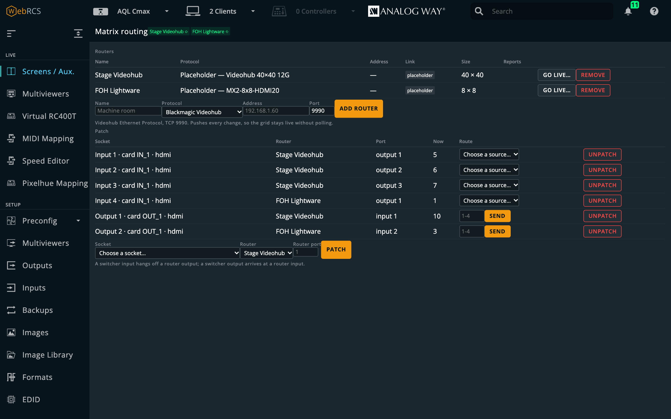

  • Matrix Routing — patch the frame's own SDI and HDMI sockets to ports on a Blackmagic Videohub, a Lightware or a Turtle AV router, and route through it from the panel, a cue, the Console or OSC. You describe the cable; the direction inverts on its own.

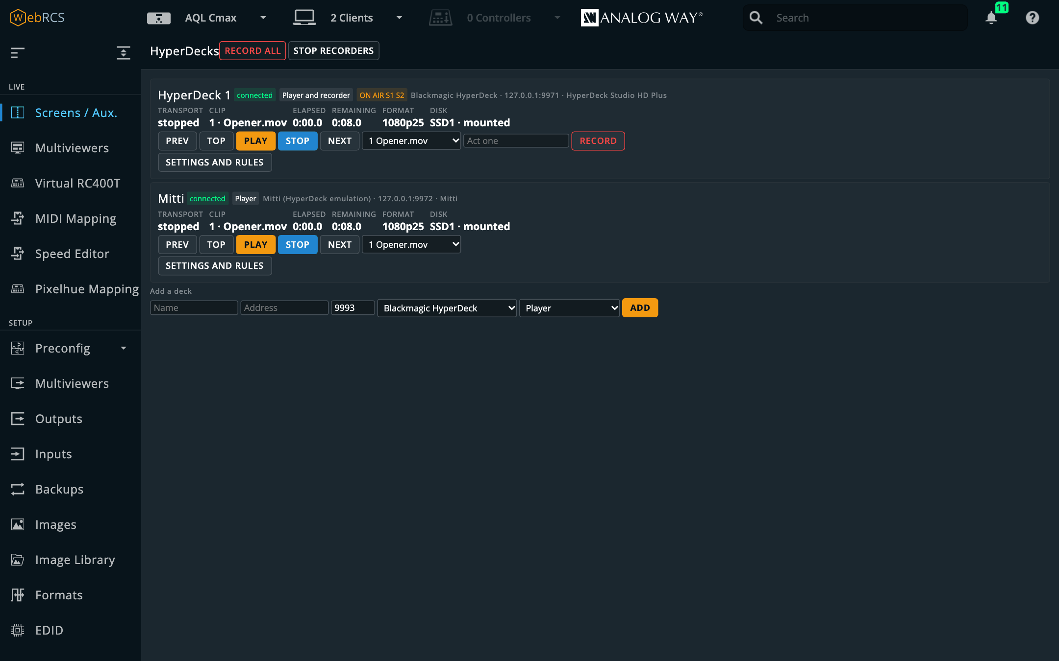

  • HyperDecks — Blackmagic HyperDecks, and Mitti through its HyperDeck control, played, cued and recorded from a panel, a cue or OSC. Link a deck to the input it feeds and it can follow the show the way Mitti follows an ATEM: play when put on air, load the next clip when taken off, and take when its clip ends — a set number of seconds early, so the mix lands on the last frame.

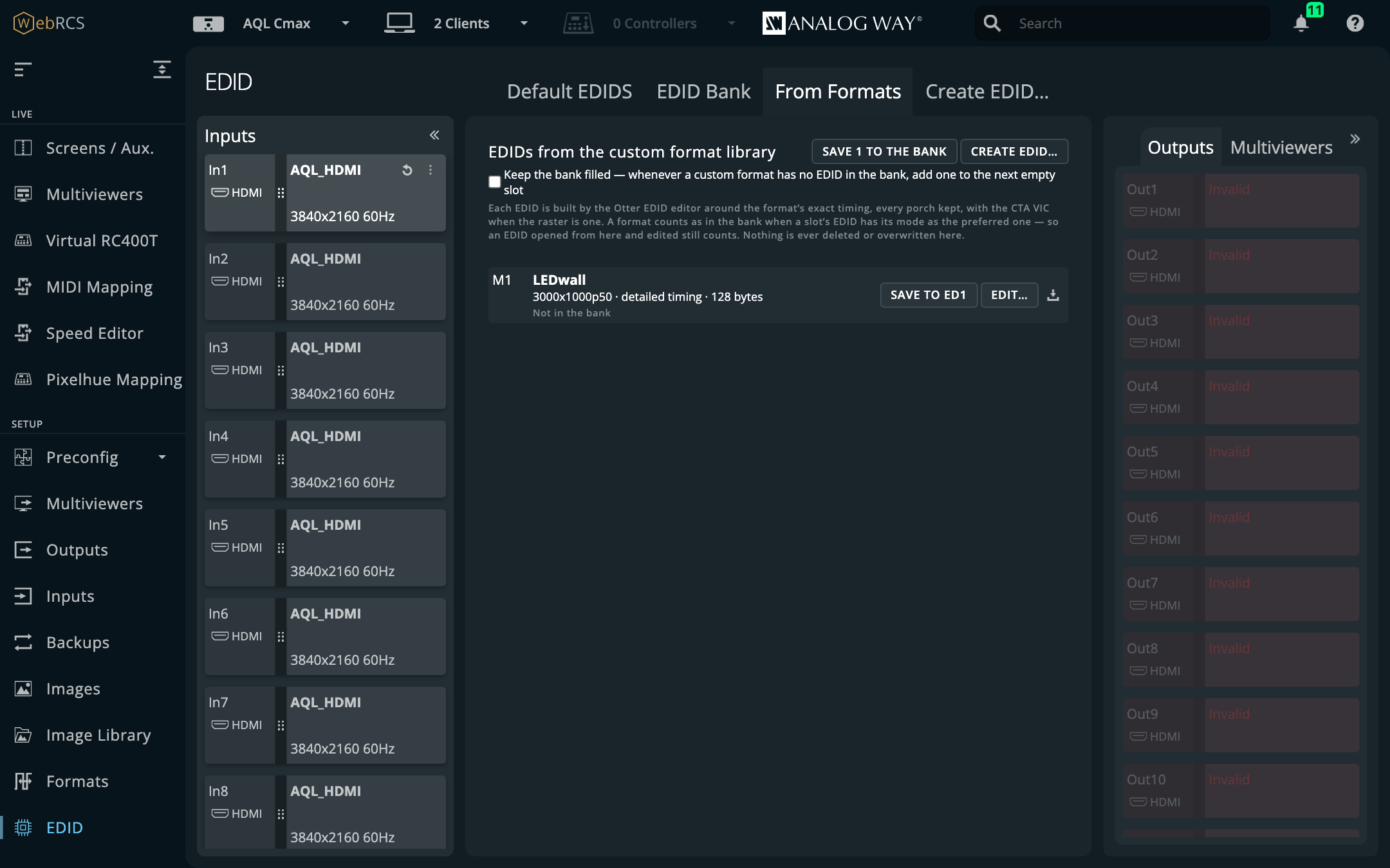

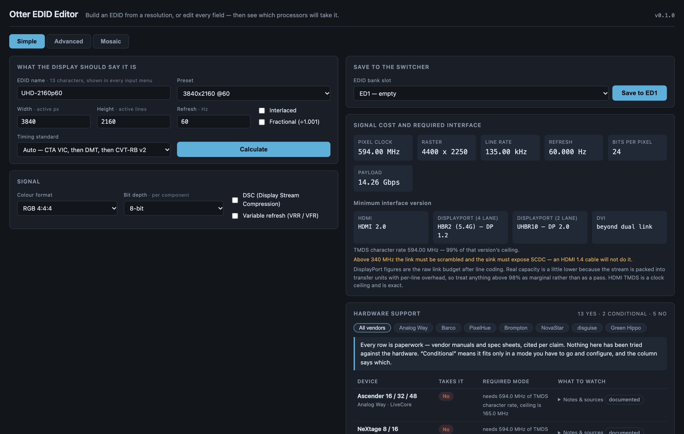

  • EDID builder — the Otter EDID editor on the switcher's own EDID page. From Formats, a tab beside Default EDIDS and EDID Bank, builds one EDID per custom format in Setup ▸ Formats — every porch kept, the CTA VIC carried when the raster is one — and saves it into the bank in one click, or keeps the bank filled with them on its own. Create EDID… and an Edit tool on every bank slot open the full editor in a window of its own, including its Mosaic mode for tiled multi-plug EDIDs, saving straight into a slot.

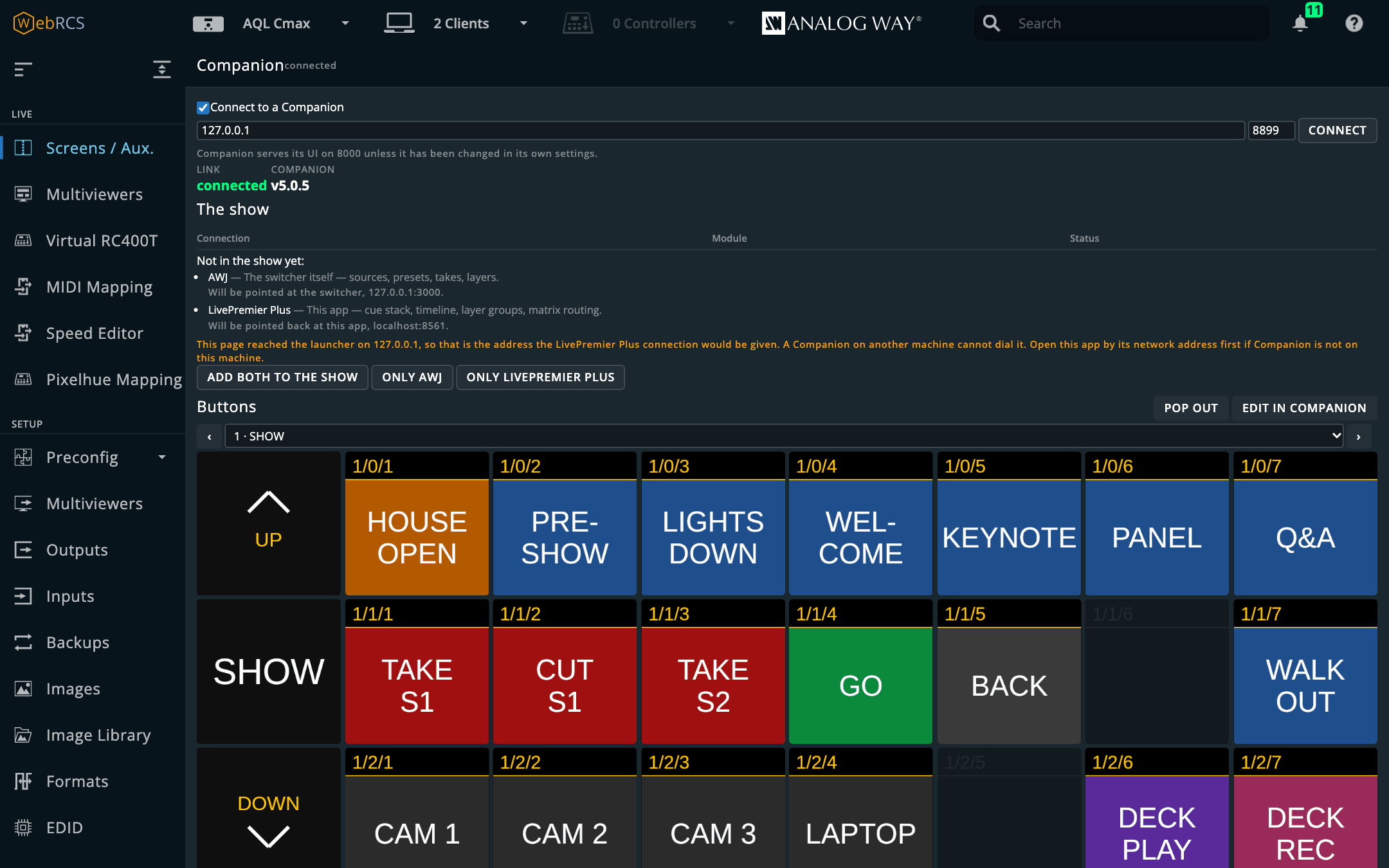

  • Companion — a Bitfocus Companion linked to this app: its pages of buttons drawn in the app's own look, live and pressable, and poppable onto a second monitor; a Companion trigger on any cue and on any memory recall, so the show presses the buttons as it runs; and Companion's own editor served on the same address as Web RCS, with no second port and no CORS. A panel lists the show's real connections, follows them live, and offers to add the AWJ and LivePremier Plus connections pointed at whichever switcher you are on — saying what it will create before it does.

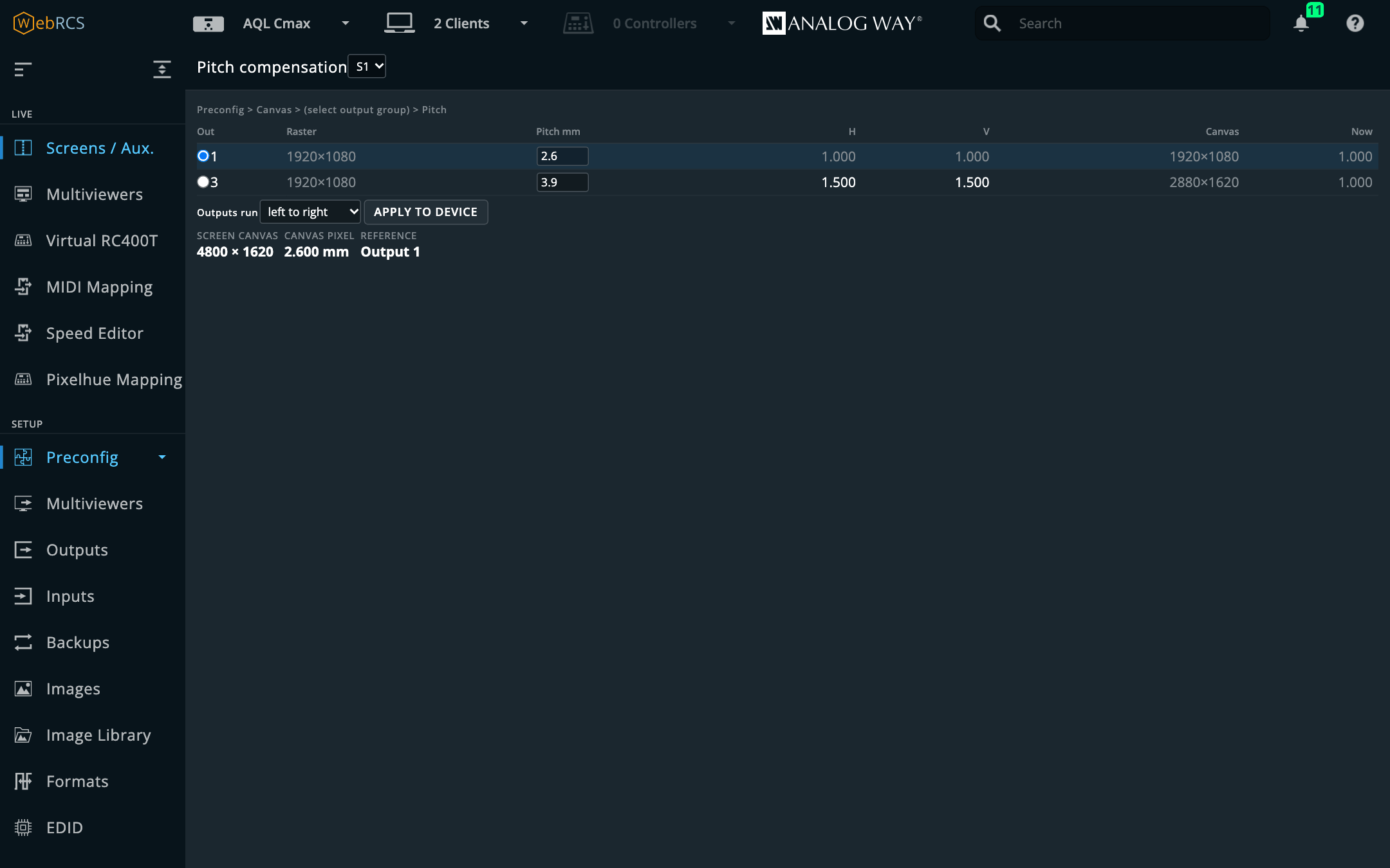

  • Pitch Compensation — a screen spanning LED walls of different pixel pitches needs H and V ratios per output, and the device has the fields and no help filling them in. Give it the pitches; it reads everything else off the switcher and writes the ratios on a second press.

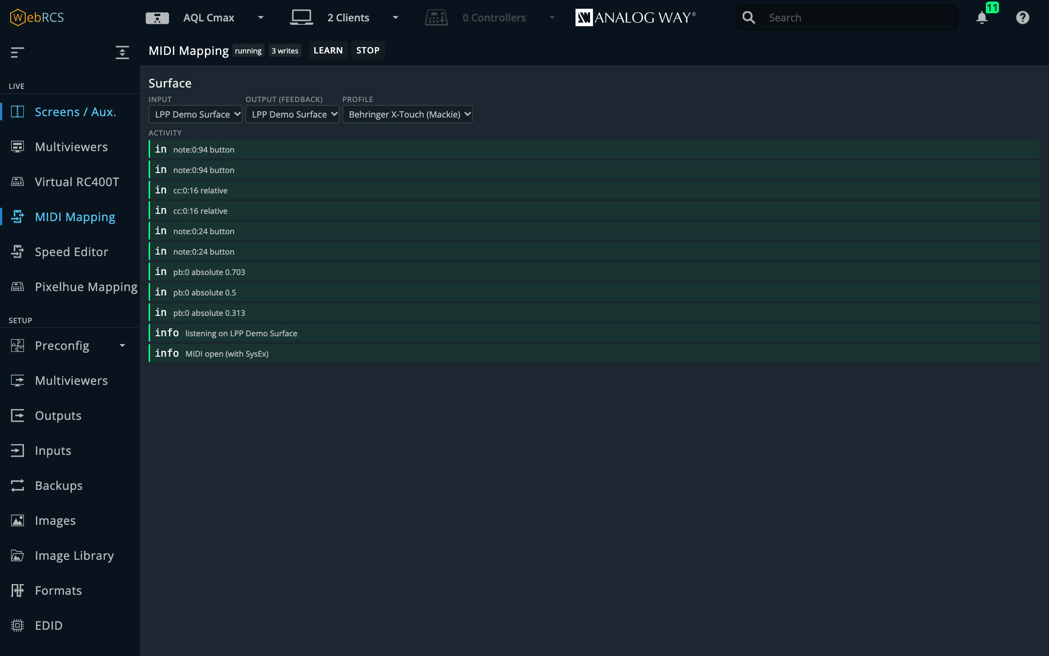

  • MIDI Mapping — a control surface driving the switcher, from the page itself. Faders to opacity, encoders to size and position, buttons to select.

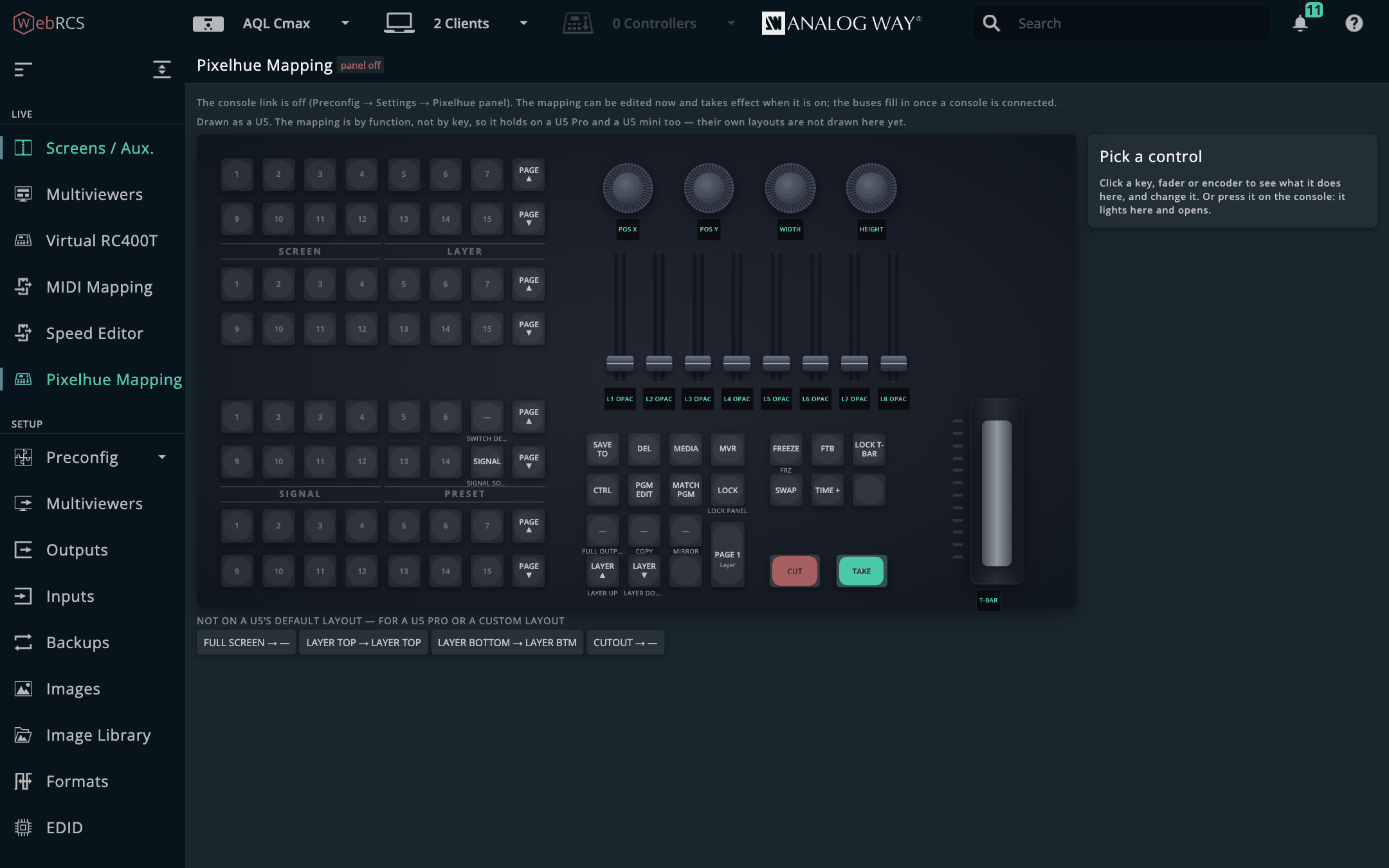

  • Pixelhue panel (preview) — a Pixelhue U5, U5 Pro or U5 mini drives the switcher from a model of it rather than from a key map, and Pixelhue Mapping draws the console so every key, fader and encoder can be given a different job. It has never yet been run against a real console.

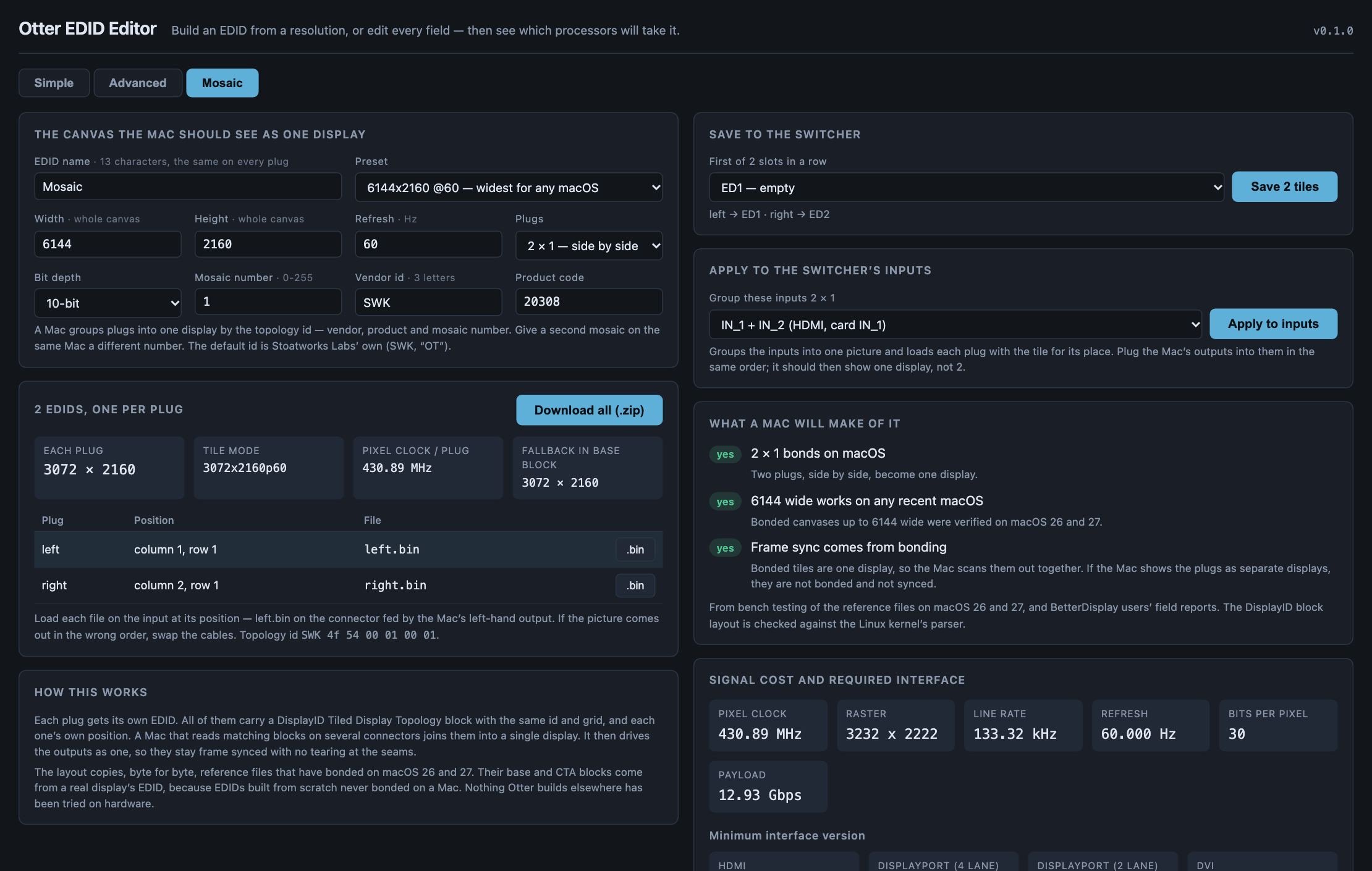

  • Mosaic inputs — the EDID builder's Mosaic mode, carried through to the frame: group inputs 2X1 or 2X2 and load each plug with its tile EDID, so a Mac joins several outputs into one frame-synced display.

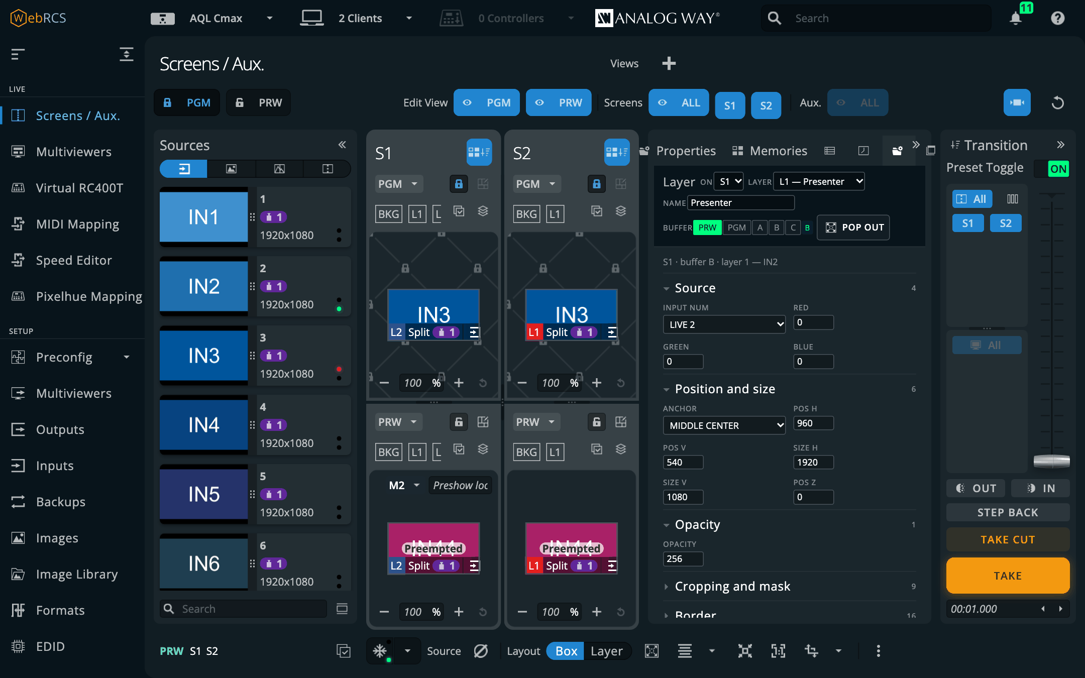

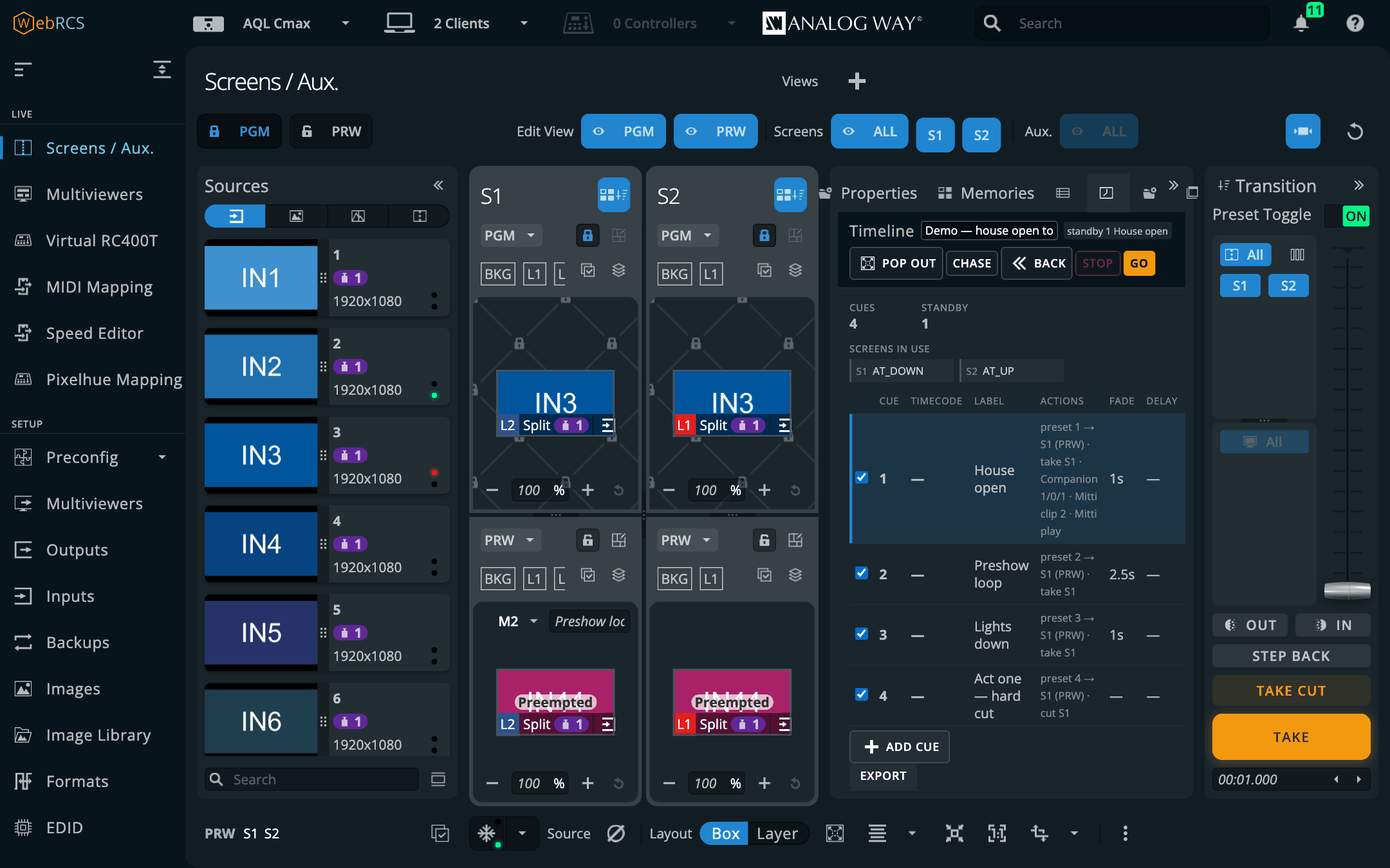

Screens / Aux. with the Timeline tab open beside Properties and Memories: the demo cue stack, its standby cue and GO, inside the vendor's own page
The Timeline tab on the vendor's own Screens / Aux. page, against Analog Way's LivePremier Simulator 6.2.73. Every screenshot here is the real app, taken with npm run demo.

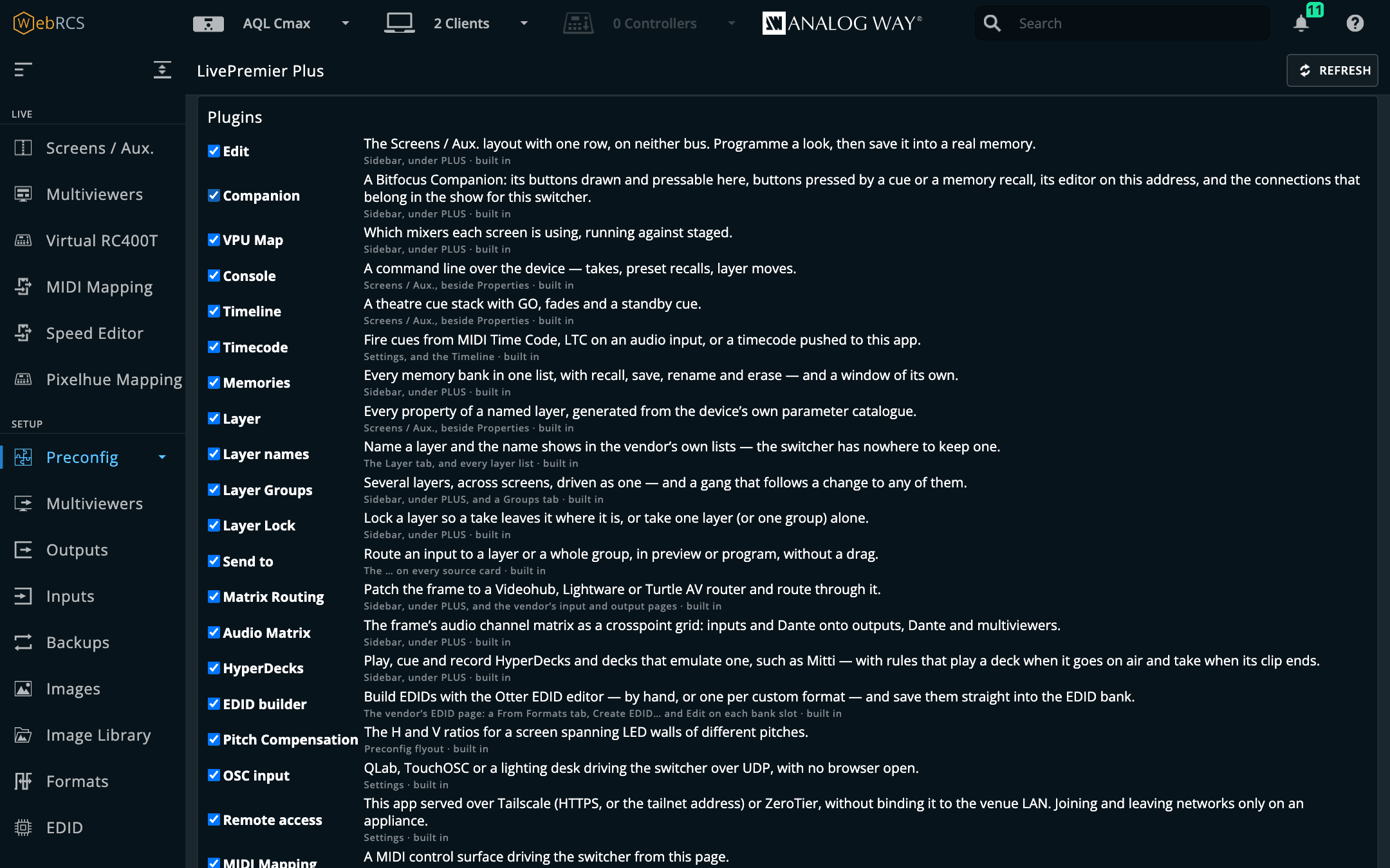

Every one of these is a plugin you can switch off, in Preconfig ▸ LivePremier Plus → Plugins; a switched-off feature leaves no menu entry, route or background service behind. You can add your own: a folder in ~/.livepremier-plus/plugins/ (or /config/plugins/ in Docker) with a plugin.json, a server half and a page half. They start switched off, and run only once you switch them on. docs/PLUGINS.md is the guide, and examples/plugins/hello-switcher the template.
Preconfig ▸ LivePremier Plus → Plugins: every feature listed with a switch, what it does and where it lives

Companion was driven against a running Companion 5.0.5 and a LivePremier simulator on 2026-09-22: the mounted Buttons page loaded same-origin with its grid drawn and one socket relayed; the panel listed the show's three real connections with live status, and its feed followed a connection being disabled and re-enabled; and an AWJ connection was added, configured and reported good. The cross-origin WebSocket check was confirmed live — 101 for the page we served and for a client sending no Origin, 403 for a forged origin and for the null a sandboxed iframe sends. The LivePremier Plus connection cannot be added yet, because there is no LivePremier Plus Companion module yet: the panel says so in those words. Merged into 0.11.0 after the Edit page; the merged proxy, settings and panels were re-checked through the proxy, but not against a live Companion a second time.
Layer groups and the send-to menu were driven on a simulator on 2026-09-21, against a preconfig staged for the purpose: two screens on opposite preset letters — S1 at AT_UP with program B, S2 at AT_DOWN with program A — which is the only arrangement in which getting the role conversion wrong shows up. A change to S1's layer 2 in letter B was followed onto S2's layer 1 in letter A, leaving S2's preview untouched; a group send in preview wrote both members' preview buffers and neither program; and a program send was held behind the confirmation step while the vendor's PGM padlock was shut and went straight through once it was opened, both read from the vendor's own buttons. No physical LivePremier has seen any of it.

The VPU map's header is part-verified from that same pull (2026-09-15). The header over the grid's columns names each link's region and output plug from outputList — usedInScreenAux, usedInRegion, capability, the mapping and the plug type — and every one of those fields is in the store the box gave us, with each screen's outputs adding up to its own figures (test/fixtures/aquilon-c-dual-outputs.json). Not yet verified on a box: the order in which a screen's links run over several outputs — every screen on that pull had one — so a screen whose outputs do not add up gets no header, and the next time an Aquilon is reachable, aquilon-vpu-map's scripts/probe-hardware.mjs step 6 and its capture guide say what to check.

0.12.0 (2026-09-22). Router routing on the vendor's own pages. A Router tab on Inputs ▸ an input and Outputs ▸ an output, and a Router box in Preconfig ▸ Inputs / Outputs. Each shows which router port the cable is on (patchable in place) and the router's ports as a grid of tiles and as a list: an input picks one source and routes on the click, an output picks any number of destinations and sends them on Route. Nothing lights until the router reports it. Proven against the simulator and a Videohub emulator — not yet against a real router.
0.11.0 (2026-09-22). Companion, served inside this app. A Bitfocus Companion's admin pages, web buttons and emulator open on the same address as Web RCS — Companion's own sub-path support with this proxy in front, so there is no second port and no CORS — and a panel lists the show's real connections, follows them live, and offers to add the AWJ and LivePremier Plus connections pointed at the switcher you are on, saying what it will create before it does. Companion's cross-origin WebSocket check is re-made here rather than bypassed. The LivePremier Plus connection cannot be added until a Companion module for this app exists; the panel says so. Linking a Companion also puts its admin UI behind this proxy, which is why the binding-wide warning now names it.

0.9.0 (2026-09-21). Two things an operator keeps doing by hand. Layer Groups name a set of layers across screens and drive them as one — a ganged group follows a source change made to any member, whatever made it — and a … on every source card routes an input to a screen and layer, or to a whole group, in preview or program, without a drag. You write a role, never a preset letter, because which letter is program changes on every take. Matrix Routing patches the frame's own SDI and HDMI sockets to ports on a Blackmagic Videohub, a Lightware or a Turtle AV router: you describe the cable, the direction inverts on its own, and the crosspoints are reachable from the panel, a cue, the Console and OSC. The Videohub driver was driven end to end against a working implementation of that protocol; the Lightware and Turtle AV drivers are written from their vendors' documents and have not met the hardware — docs/MATRIX.md says how to prove each on your own kit.

0.8.0 (2026-09-17). The VPU map reads the grid top to bottom the way an output link runs: the native band sits above the eight layer links, a screen whose next layer landed on another VPU keeps its columns there — the two cards stack and the link draws straight down out of one and into the next — and a header over the columns names each link's region and output plug from outputList, with the real Aquilon C outputs of 2026-09-09 as a fixture. The desktop launcher now stops the proxy it supervises on every exit path (⌘Q and Quit from the Dock left the Node process holding the port); the shell is av-launcher 2c83ad7.

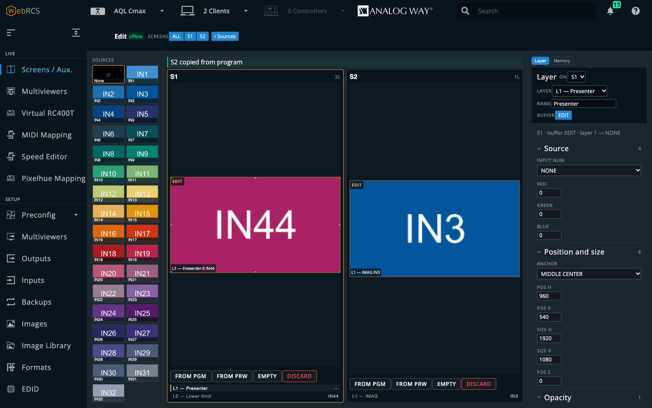

Edit
PLUS ▸ Edit is the Screens / Aux. layout with one row per destination instead of two, and that row is a programmer — a buffer on neither preview nor program, marked EDIT in amber. Fill it from PGM, from PRW or empty, drag and resize layers on the stage, put sources on them and work all sixty-seven layer parameters in the panel on the right. The switcher sees none of it.
The Edit page: both screens seeded from program, S1's layer selected on the stage and its parameters in the Layer panel on the right
The Memory tab is the one control on the page that writes. Direct puts the look into a memory slot with no preset buffer written and no take fired; via preview borrows the preview buffer, fires the switcher's own save and puts preview back property for property. The user guide says what each costs, and the Status note above says what is still open about the direct route on real hardware.

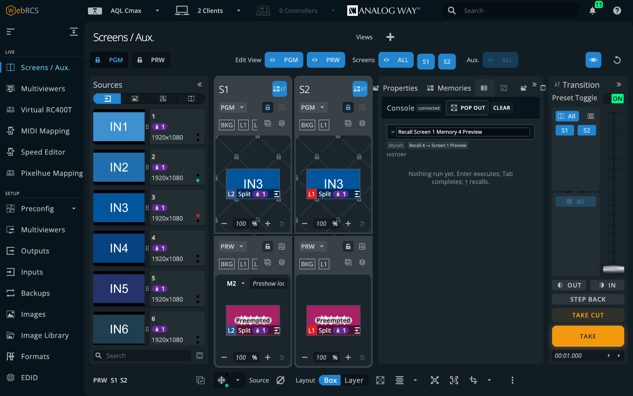

Console
Mynah's command language, inside Web RCS. Verb first, then objects, innermost scope last; every keyword abbreviates to any unambiguous prefix; Enter executes and nothing is sent before it.
Recall Screen 1 Memory 5
R Sc 1 Th 4 Me 5 Pre          the same command
Store Master 12
Take Screen 1
The line parses as you type and shows what it will do — Recall 3 → Screen 1 Preview — before anything reaches the device. Tab completes, ↑ recalls history.
Variables stand wherever a number goes — Set Screen 1 Layer 2 Size ($S1.width / 2) $S1.height, Recall Screen 1 Thru @screens Memory @opener — and the feedback names what each reads before Enter. Arithmetic goes in brackets, because outside them + and - are still the range operators. See docs/VARIABLES.md.
The Console tab with a line typed and not yet run: the Mynah badge and "Recall 1 → Screen 1 Preview" under it
This panel owns no grammar. Every token, rule and device path comes from src/vendor/mynah-lang.mjs, which is mynah's own npm run build:lang output — the same artefact its Companion module vendors. If a command means the wrong thing, the fix is in mynah.
That is worth more than tidiness. Mynah's compiler and this repo's CMD builder were arrived at independently — and they emit byte-identical store paths for the commands both know. Two independent derivations agreeing is the strongest evidence either is right, and it stays true only while nobody re-types the grammar here. A test pins it.

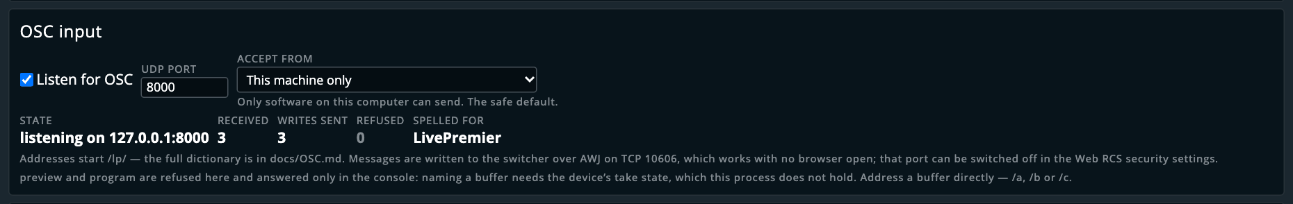

OSC input
Off by default. Turn it on in Preconfig ▸ LivePremier Plus → OSC input and this process listens on a UDP port, so QLab, TouchOSC, Companion or a lighting desk can drive the switcher directly.
/lp/screen/1/take
/lp/screen/1/memory/5/recall/preview
/lp/master/memory/12/store
/lp/screen/1/preset/a/layer/2/opacity/opacity/norm 0.5
The full dictionary is in docs/OSC.md — every address, its argument and its range. It is the same address space the MIDI mapping binds to: a fader is bound to a screen, a preset, a layer and a parameter, and that four-part address is the same thing whether it arrives as a control change or as a packet. The document is generated from the resolver's own tables, so it cannot describe an address that does not work.
Four things worth knowing before you wire a surface to it:
  • The address is the target; the argument is only the value. A button with a fixed address and no argument still means something specific, which is what lets a TouchOSC layout be drawn once with no logic behind it.
  • A trigger fires on a non-zero argument and on none at all. Surfaces send 1 on press and 0 on release; firing on both would take the screen twice.
  • A recall never defaults to program. /lp/screen/1/memory/5/recall goes to preview. Reaching air costs the explicit word, here as everywhere else.
  • /norm takes 0–1 and scales; without it the value is in the device's own units. Opacity is 0–256, not 0–100. Which one 0.5 meant cannot be worked out from the value, so it is said in the address instead.
It binds to loopback unless you choose otherwise, and the other option says in as many words that the network will be able to fire takes. Messages are written to the switcher over AWJ, so it works with no browser open — which is the point — and that port can be switched off in the Web RCS security settings.
Over UDP, live layer parameters must name a buffer — /a, /b or /c. preview and program name whichever buffer is pending or live right now, and resolving that needs the device's take state, which this listener does not hold. It refuses those addresses with that reason rather than guessing. The Console can resolve them, because the page has the device store.
The OSC input card listening on 127.0.0.1:8000, three messages received and three writes sent, spelled for LivePremier
Matrix routing
Patch the switcher's own SDI and HDMI connectors to ports on a Blackmagic Videohub, a Lightware or a Turtle AV router, then route through it — from the panel, from a cue, from the Console or over OSC.
Tell it about the cable and the rest follows:
A switcher input is fed by a router output, which takes one source; a switcher output arrives at a router input, which can be sent to any number of router outputs
That inversion is the whole model. From it come the two operations, which are deliberately not symmetrical: an input is fed by one router output, so choosing its source is one crosspoint and fully determines what it sees; an output arrives at one router input, which can be sent to any number of destinations at once.
The panel names sockets in the device's own words — Input 13 · card IN_2 · connector IN_25 · sdi — because which connector "card 2, port 1" is depends on a legend this app cannot see.
PLUS ▸ Matrix Routing with two placeholder routers — a Videohub 40×40 and a Lightware MX2-8x8 — and the patch from the frame's sockets to their ports
The same routing is on the vendor's own pages: a Router tab on Inputs ▸ an input and Outputs ▸ an output, and a Router box in Preconfig ▸ Inputs / Outputs.
Inputs ▸ Input 1 ▸ Router: the cable from Stage Videohub output 1, and the router's 40 inputs as tiles and as a list, input 5 selected
A placeholder router — a Videohub, Lightware or Turtle AV model of the right size with nothing on the other end — takes the patch and the routing before the rack arrives; Go live… gives it an address and Push plan sends only what differs.
Nothing is optimistic. A driver never writes its own state: a click does not move the grid until the router says it moved. A Videohub answers a refused route with ACK and the unchanged routing, so a UI that showed what it asked for would lie during exactly the minute that matters.
⚠️ No real router has ever driven this. The Videohub driver is a port of BlackMatrix's, exercised against a working implementation of the protocol; the Lightware and Turtle AV drivers are written from their vendors' protocol documents and have never spoken to hardware. The patch model and the connector reader are checked against a real LivePremier's own store. docs/MATRIX.md has the whole thing, including a short procedure for proving each driver on your own kit.
HyperDecks
PLUS ▸ HyperDecks. Blackmagic HyperDecks — and anything that answers their Ethernet protocol, Mitti included — played, cued and recorded from the panel, from a cue (VT 1 clip 3; VT 1 play) or over OSC (/hyperdeck/<deck>/play). Each card shows the transport, clip, elapsed and remaining time, format and disk, and whether its input is on air or in preview.
Two decks on the HyperDecks page: a HyperDeck as player and recorder, and Mitti as a player, each with transport, clip and settings
Tell a deck which switcher input it plays into and it can follow the show the way Mitti follows an ATEM: play when that input is put on program, rewind when it is cued, pause, rewind or load the next clip when it comes off, and take when its clip ends — a set number of seconds early, so the mix lands on the last frame. The rules run in one open page at a time, and act only on what changes after they start, so opening a page never plays a deck already on air.
⚠️ Written from Blackmagic's published protocol and proved against an emulation of it — not yet against a real HyperDeck. node tools/hyperdeck-sim.mjs is that emulation; docs/HYPERDECK.md has the protocol notes and a short procedure for proving it on your own deck.
Mitti needs the release after 0.16.0. A real Mitti 2.8.18 answers 103 unsupported to any command ending in a carriage return, which is how 0.16.0 ends them. main ends them with a bare line feed, which a HyperDeck also takes, and the simulator's --mitti mode now refuses CR the same way.

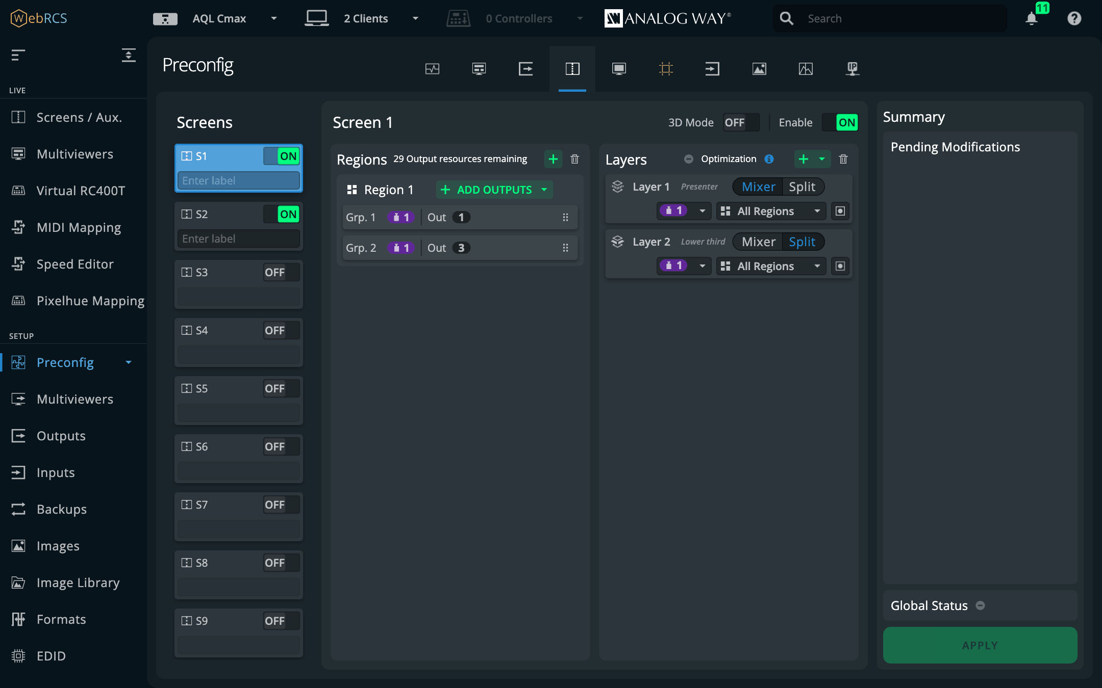

Pitch Compensation
Under Preconfig, beside the two fields it fills in.
A screen spanning LED walls of different pixel pitches needs each output group told how much canvas its raster is worth, or a layer crossing the join changes physical size the instant it crosses. The device has the fields for it — Preconfig > Canvas > Pitch, H Ratio and V Ratio — and no help at all working out what to put in them.
The device knows every number but one. It has the rasters, it knows which outputs are on the screen, and it will say what ratios are set. It has no idea how far apart the LEDs are, so the panel reads the first lot and asks you for the pitches — one per output, 2.6, or 2.6 x 3.0 if the pixels really are not square.
The engine is aquilon-pitch's, vendored into src/vendor/pitch-engine.js. It carries four things that are easy to get backwards and still look right, each established there by driving a simulator rather than reading the manual:
  • the ratio multiplies a group's raster to give its canvas footprint, so a coarser wall takes a ratio above 1.000
  • the field is an integer in thousandths, range 0.100 to 10.000
  • an out-of-range write is discarded by the device, not clamped — so a ratio that will not fit is refused here rather than sent
  • the footprint floors, so 1080 × 1.234 is 1332 and not 1333
Applying takes two presses. It is a preconfig change, it moves every output on the screen at once, and it is the only control in the panel that touches the device — so it should be hard to hit by accident. When the device already holds the computed ratios the button says so and does nothing.
Pitch compensation on S1: output 1 at 2.6 mm as the reference, output 3 at 3.9 mm taking 1.500 H and V, and a 4800 × 1620 canvas
MIDI Mapping
Under Virtual RC400T. Pick an input, an output for feedback, and a controller profile; Start. Faders, encoders and buttons then drive the selected layer.
The engine is awj-surface's, vendored whole into src/vendor/surface/ along with its stock profiles (X-Touch/Mackie, APC40, MIDIcon 2 and Pro, plus a generic learn profile). Decoding, soft pickup, encoder acceleration, MCU feedback and the parameter catalogue are all upstream's. This repo contributes a front-end and nothing else.
Soft pickup is the behaviour worth knowing: a non-motorised fader will not move a live value until it has swept through that value, so picking up a fader mid-show cannot jump a layer's opacity. The panel shows the hold-off rather than looking broken.
MIDI Mapping running on a surface with the X-Touch profile: fader moves arriving as pitch-bend, a jog wheel as a relative CC, and buttons as notes — three writes sent

Pixelhue panel — preview
A Pixelhue U5, U5 Pro or U5 mini event controller, driving the switcher. Off by default; turn it on in Preconfig ▸ LivePremier Plus.
It does not map keys. The console is handed a model of this switcher — its screens, its inputs, its memories — and labels, lights and pages its own keys from it; what comes back is what the operator meant (select screen S2, put LIVE_2 on the selected layer, take), carrying the identity this app published. So there is nothing to remap when a firmware moves a key.
⚠️ Preview: this has never been run against a console. It was built from the consoles' firmware and proved against the vendor's own control service running headless with no panel attached. docs/PIXELHUE.md has the wire detail, how to rig one, and the list of what is still unverified. Since 0.14.0 it has been driven key by key from PixelFlow's own virtual U5 against the simulator; fade-to-black and freeze are sent on LivePremier, not yet on a Midra 4K.
What each key, fader and encoder does is editable on Pixelhue Mapping, under Virtual RC400T: the console drawn in the Virtual RC400T's look, the buses showing what the console shows. Click a control to change it — take, cut, fade to black, layer stepping, the cue stack, a memory to preview, a Companion button — or press it on the console and it lights up here. A changed control carries a blue dot; Reset puts everything back.
Pixelhue Mapping: a U5 drawn as a Virtual RC400T, with its source and preset buses, function keys, faders, encoders and T-bar, and the "Pick a control" panel beside it
A U5 mini answers on the LAN, so it is driven from wherever this app already runs. A U5 or U5 Pro serves its control port on loopback only, so this app has to run on the console itself — which is a Windows mini-PC with a touch screen, and runs the proxied Web RCS perfectly well.

What it looks like
Every panel is built from the vendor stylesheet's own utility classes — the slate-grey scale, the spacing scale, the typography — and the sidebar entries are cloned from real ones at runtime, so they inherit whatever per-build class hashes the firmware happens to use. The result is not a skin that approximates Web RCS; it is Web RCS's own CSS.
Console, Timeline, Layer and Groups are tabs in the vendor's own strip on Screens / Aux., beside Properties and Memories, because per-screen tools belong where an operator already looks for per-screen tools:
Properties | Memories | Console | Timeline | Layer | Groups
The Layer tab: S1, layer 1, named "Presenter", its PRW buffer resolved, source, position and size, and opacity
Layer is a properties editor, and it is called Layer rather than Properties because the vendor's own Properties tab is two along in the same strip — two tabs with one name is a worse problem than a name that is only most of the truth. It is also the honest difference between them: the vendor's tab follows the layer you have clicked, which is React state inside their bundle and therefore unreadable from here, so ours makes you name a destination, a buffer and a layer outright. On a second monitor that turns out to be the better behaviour anyway, because the window stays pointed where you left it.

    LivePremier Plus     <- ours: settings and the plugin switches

A switched-off plugin takes its entry with it, so a sidebar can be shorter than this.

Layer groups, and sending a source to one
An operator does not think "layer 2 on screen 1, layer 1 on screen 2, layer 1 on screen 3". They think the side screens. The switcher has no word for that — a LivePremier addresses a layer as (destination, preset buffer, layer) and nothing above that ties two of them together — so this adds one.
A group is a name and a list of layers, kept per device beside the cue stack.
PLUS ▸ Layer Groups: "Side screens", ganged, holding S1 L2 and S2 L1 with what each shows in program and preview; "Keys" with its gang off
It does two things:
  • It is a target. Send an input to the group and every member gets it.
  • It follows. A group marked gang — the default — watches its members, and a source change to any one of them is written to the rest. It does not matter how that change arrived: our menu, the vendor's own drag-and-drop, a memory recall, another client on the network.
The … on each source card is how you aim at one. It is beside the vendor's own ⋮ (which opens that input's settings) and cloned from it, so it inherits the same button styling whatever the firmware hashes it to this week; the glyph is horizontal rather than vertical so the two are told apart at a glance. The menu is preview or program, then a target: a recently used one, a group, or a screen and one of its fitted layers.
The … menu on IN4's source card: Send IN4, Preview or Program, the two groups, and each screen's fitted layers
It writes the role, not the letter. A layer's source lives under a preset buffer — A, B or C — and which letter is program changes on every take, so two screens are routinely on opposite ones. Sending to "program" resolves that per screen. A gang that copied letter to letter would put a preview edit on air on half the screens, and that is the single thing this feature has to get right; it is verified on a device with S1 at AT_UP and S2 at AT_DOWN, which is the only arrangement in which a wrong answer shows up.
It respects the PGM padlock. The lock on a screen card is React state inside the vendor bundle — it is not in the device store, and a write over the socket is not subject to it. The menu honours it anyway: a locked target buffer gets a confirmation step naming every layer it is about to change, an open one is sent straight through. A screen whose card is not on screen has no lock to read, so it is treated as locked and asked about.
Mid-take nothing is written at all. "Program" and "preview" do not name a buffer honestly while a transition is in flight, and the refusal is the same one the Layer panel already makes.

Layer Lock
PLUS ▸ Layer Lock. A LivePremier take swaps the whole preset buffer; there is no per-layer take. What this uses instead is that a layer identical in program and preview has nothing to transition. Lock keeps a layer's preview copy equal to program, and every TAKE or CUT sent from this page — the vendor's own button included — is held for the few milliseconds it takes to line a drifted lock back up. Take only takes one layer, or one group, alone: every other layer is set equal to program, the take goes, and their preview looks are put back afterwards.
Layer Lock: the two layer groups with Lock group and Take only, then each screen's layers with program, preview, what the next take will do, Lock and Take only
⚠️ Only takes sent from this page are held, and it is proved on the simulator only. The front panel, a T-bar, an OSC take or another operator's browser go straight to the switcher; the panel says so at the top every time.
Gallery
The panels above that have no section of their own, and the windows that pop out. All of them are the real app on the LivePremier Simulator 6.2.73, taken with npm run demo; click one for the full size. The user guide explains each.
PLUS ▸ Memories: the screen bank on S1, eight named memories with Recall, Save and Erase
Memories — every bank in one list, renamed in place, with the buffer that holds each.
PLUS ▸ Companion linked to Companion 5.0.5, its connections and a page of buttons
Companion — linked to Companion 5.0.5: the connections it offers to add, and a page of buttons drawn as Companion renders them.
PLUS ▸ Audio Matrix with Input 1 opened into its channels
Audio Matrix — blocks of eight, Input 1 opened into single channels.
The Timeline popped out, cue 1 selected with a Companion trigger and a HyperDeck command
Timeline, popped out — a cue with its Companion trigger and HyperDeck commands.
Setup ▸ EDID ▸ From Formats with custom format M1
EDID ▸ From Formats — an EDID built for custom format M1, one click from the bank.
The EDID builder window in Simple mode
Create EDID… — the Otter editor in its own window, saving straight into a slot.
The EDID builder in Mosaic mode, two tiles for a 6144x2160 canvas
Mosaic — one tiled EDID per plug, saved and applied to a 2 × 1 input group.

    plugins.js     every feature as a plugin: what it is, and whether it is on
    contributions.js  how plugins extend each other: contribution points, services

plugins/         every feature, one folder each - a server half, a page half,
  console/       or both: console, timeline, matrix-routing, companion, edit,
  …              memories, layer, layer-groups, osc-input and the rest

The VPU model is shared, not reimplemented
PLUS ▸ VPU Map in the demo: 32 of 64 mixers fitted, 26 allocated, S1 in Optimized mode, and 26 staged changes waiting in Preconfig
src/vendor/vpu-model.js is a copy of public/vpu.js from aquilon-vpu-map, the standalone tool that reads the same allocation over AWJ. Deliberately the same model in both places: if two tools derived their own answers from one device they would eventually disagree about what the box is doing, and both would look right. npm run sync:vpu-model re-copies it and rewrites the recorded commit, and test/vendor.test.js fails if the copy has drifted from an upstream checkout.
src/core/vpu.js is the only part that differs between the two projects. That tool assembles mixer records from a few hundred AWJ reads; this one lifts them straight out of the device store the page already has, which also gets the per-screen resource status — the device's own "does this fit" figures — for free, where the standalone reader spends 24 round trips on it.
There is deliberately no AWJ path here. It would be easy to add — this is a process, it can open TCP 10606 — but the store is already mirrored and stays current from the socket, so an AWJ reader would be a second source of truth for the same VPU state. Two sources that can disagree about what is on air is not a trade worth making for a faster first paint.
A simulator has no VPU at all. It carries a vpuLayerList that is present and permanently empty and no vpuMixerList; $vpuLayer answers E12 on real hardware. That is an artefact of the simulator, not a second firmware generation, and the panel says so plainly rather than drawing an empty chassis or claiming the firmware is unsupported.

Timeline (cue stack) yes yes — takes, cuts, fades and recalls spelled for the transition and preset trees
Memories master, screen and layer banks master, screen and aux banks — the aux bank is separate on this platform, and there is no layer bank
Console yes yes — mynah compiles the same grammar for this platform (Take Screen 1, Recall Aux 1 Memory 7, Set Aux 1 Source 4); no layer memories, no stills on a layer, and it says so
Audio Set Audio Patch … To … on the channel matrix yes — routed, not patched: Set Audio Patch Input 3 To Screen 1 writes the preset's audio layer, Follow Layer 2 On Screen 1 / Follow Screen 2 On Line Output 1 set what a point follows, mutes land where the device keeps them

Pitch Compensation yes yes — the ratios live under canvas/pitch there, and the panel knows

MIDI Mapping yes not yet — the surface engine still spells LivePremier
EDID builder yes — the 100-slot bank and M1–M16, read off the simulator not yet seen — it lights up by itself if the store has the same system/edid/bankList

  • The timeline writes only what a cue says. Preset recalls, transition times, TAKE, CUT and STEP BACK — nothing else, and only on GO.
  • A TAKE waits 150 ms behind a recall in the same cue, so it cannot overtake its own preset load and put the previous preview on air.
  • A cue is reported as sent, never as confirmed. Recalls and takes return nothing on this protocol. The log counts writes that left the browser; device status is shown separately, from the device's own status properties.

  • The OSC listener is off until you turn it on, binds to loopback unless you choose otherwise, and never answers a packet. It listens; it does not reply, because replying to a spoofable datagram tells an unknown host that something here is worth sending to.
  • An OSC address that cannot be resolved is refused, not approximated. An enum value the device does not have, a parameter that is read-only, a preset that needs a take state this process does not hold — each is turned away with the reason, and counted in Settings.
  • A ganged group is the one thing that writes unprompted — that is what ganging is — and it is fenced accordingly. It writes only a layer's source and only to members of a group someone made; it resolves program and preview per screen rather than copying a preset letter; it refuses outright while a take is in flight; it acts only on a change made while the page is open, never on state it merely found at startup; and a layer can belong to only one group, so two groups cannot pull at the same layer. Turning a group's gang off leaves it a target and nothing more.
  • The send-to menu respects a padlock it could ignore. The PGM lock on a screen card is state inside the vendor's own bundle — it stops their UI, not the device — so a write from here is not subject to it. The menu asks anyway when a target buffer is locked, and treats a screen it cannot see as locked.
