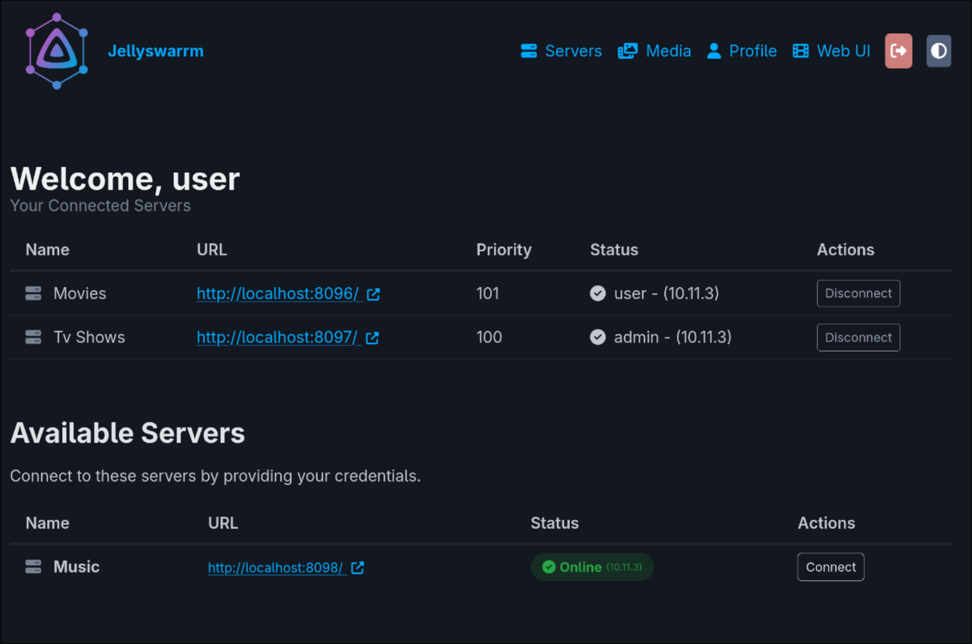

✅ Working
  • Unified Library Access – Browse media from multiple Jellyfin servers in one place.
  • Direct Playback – Play content straight from the original server without extra overhead.

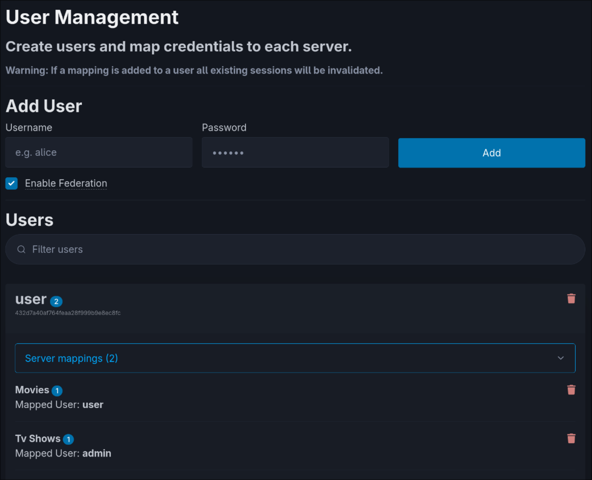

  • User Mapping – Link accounts across servers for a consistent user experience.
  • API Compatibility – Appears as a normal Jellyfin server, so existing apps and tools still work.
  • Server Federation – Automatically sync users across connected servers.
  • User Page – Personal dashboard for managing credentials and libraries.

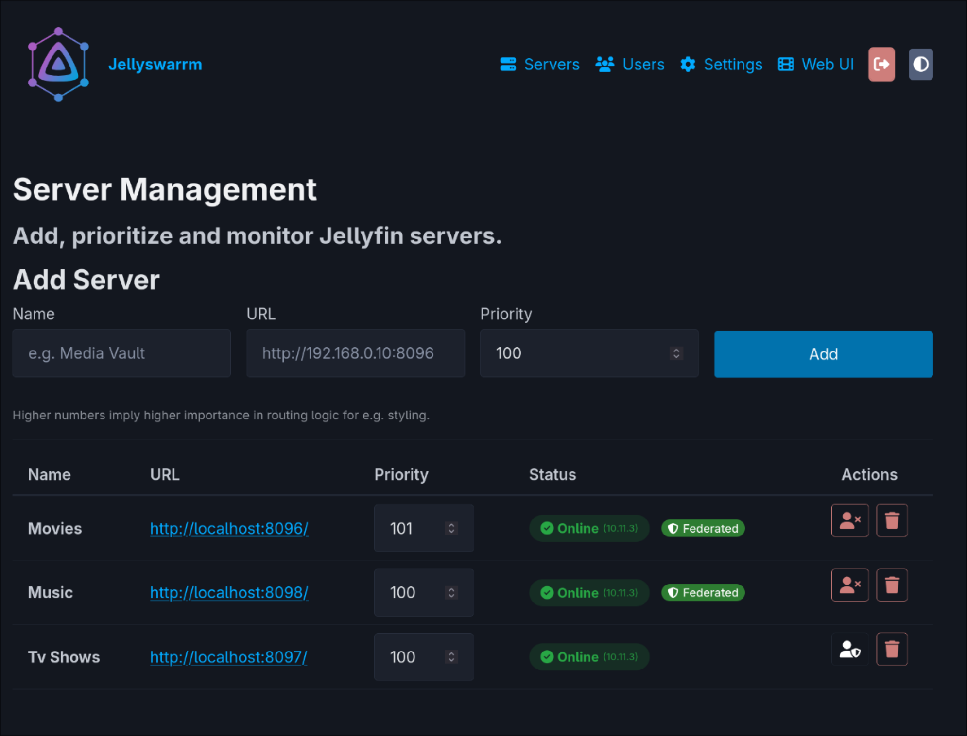

  • Web UI (setup & management): http://[JELLYSWARRM_HOST]:[JELLYSWARRM_PORT]/ui – Log in with the username and password you set in the environment variables. – From here, you can add your Jellyfin servers and configure user mappings.

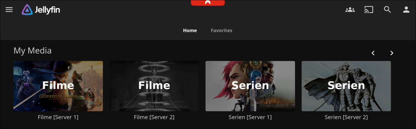

  1. Why not just add multiple servers directly in the Jellyfin app?
    Some Jellyfin apps do support multiple servers, but switching between them can be inconvenient. Jellyswarrm brings everything together in one place and also merges features like Next Up and Recently Added across all servers. This way, you can easily see what’s new in your own libraries or what your friends have added.
