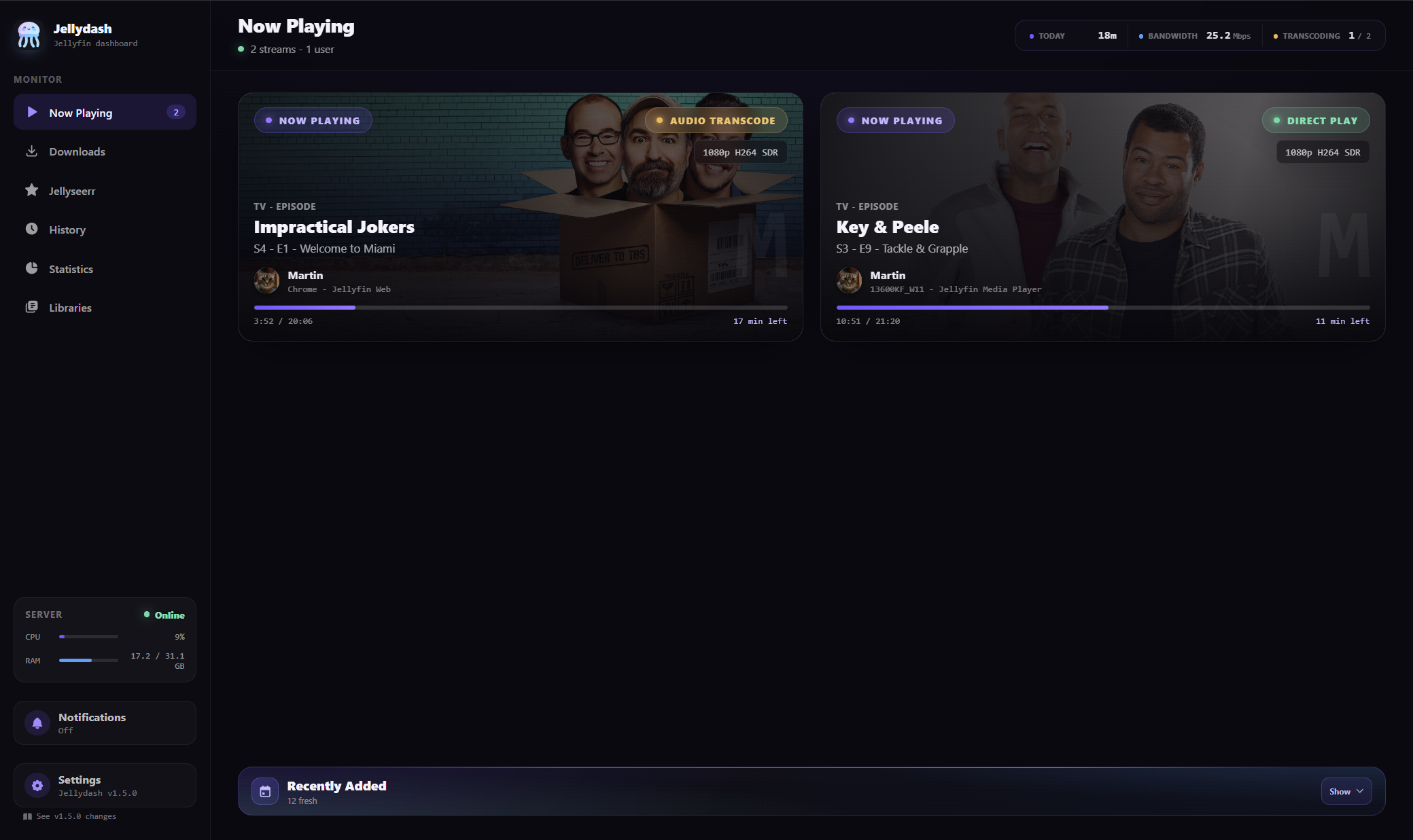

A Jellyfin dashboard for current streams, play history, statistics, and optional notifications. This template runs Jellydash with SQLite. The mascot is based on an icon by Magnific from Flaticon.

This template installs the Jellydash Docker image with SQLite, so it runs as one container. It is intended for a new installation. If Jellydash already runs through Docker Compose on your Unraid server, keep using that setup. Installing this template does not move your existing database or settings.
