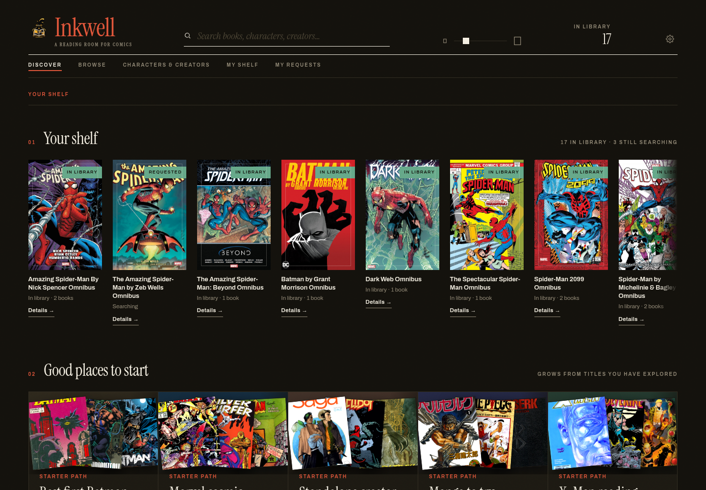

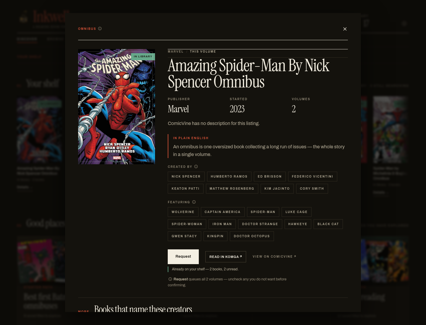

Inkwell is a comic request front end for Mylar3. Browse by publisher, character, creator, team, or event; choose books and follow requests until they reach an optional Komga library. Fresh installs create an administrator in the browser, then add local users and approve requests. Existing installs keep their saved access mode. It stores state under /config and reads Mylar appdata read-only. Read the self-hosting guide before enabling remote access.

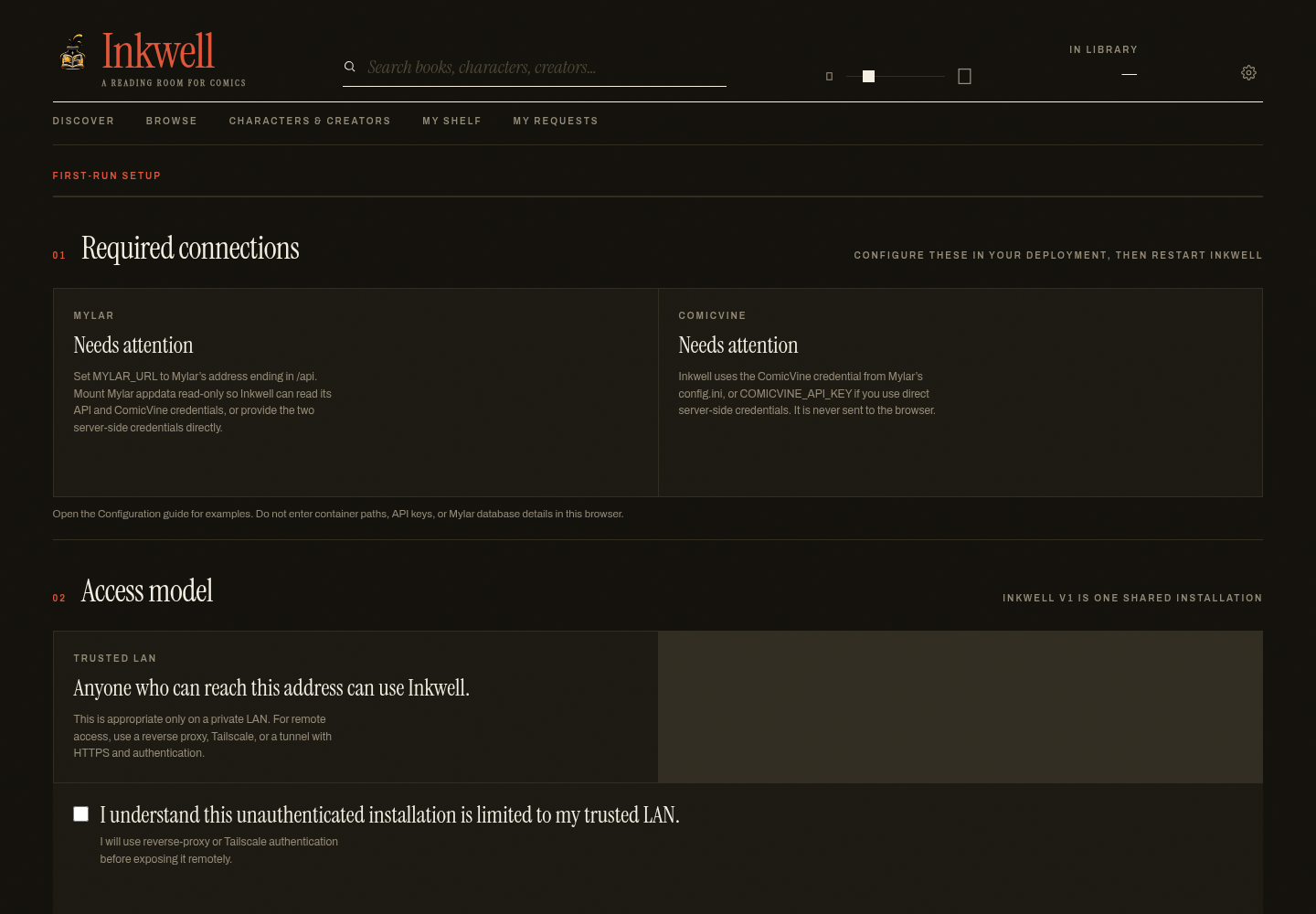

Open http://SERVER-IP:3013. The first-run page identifies missing required configuration and prevents request-changing actions until setup is finished.

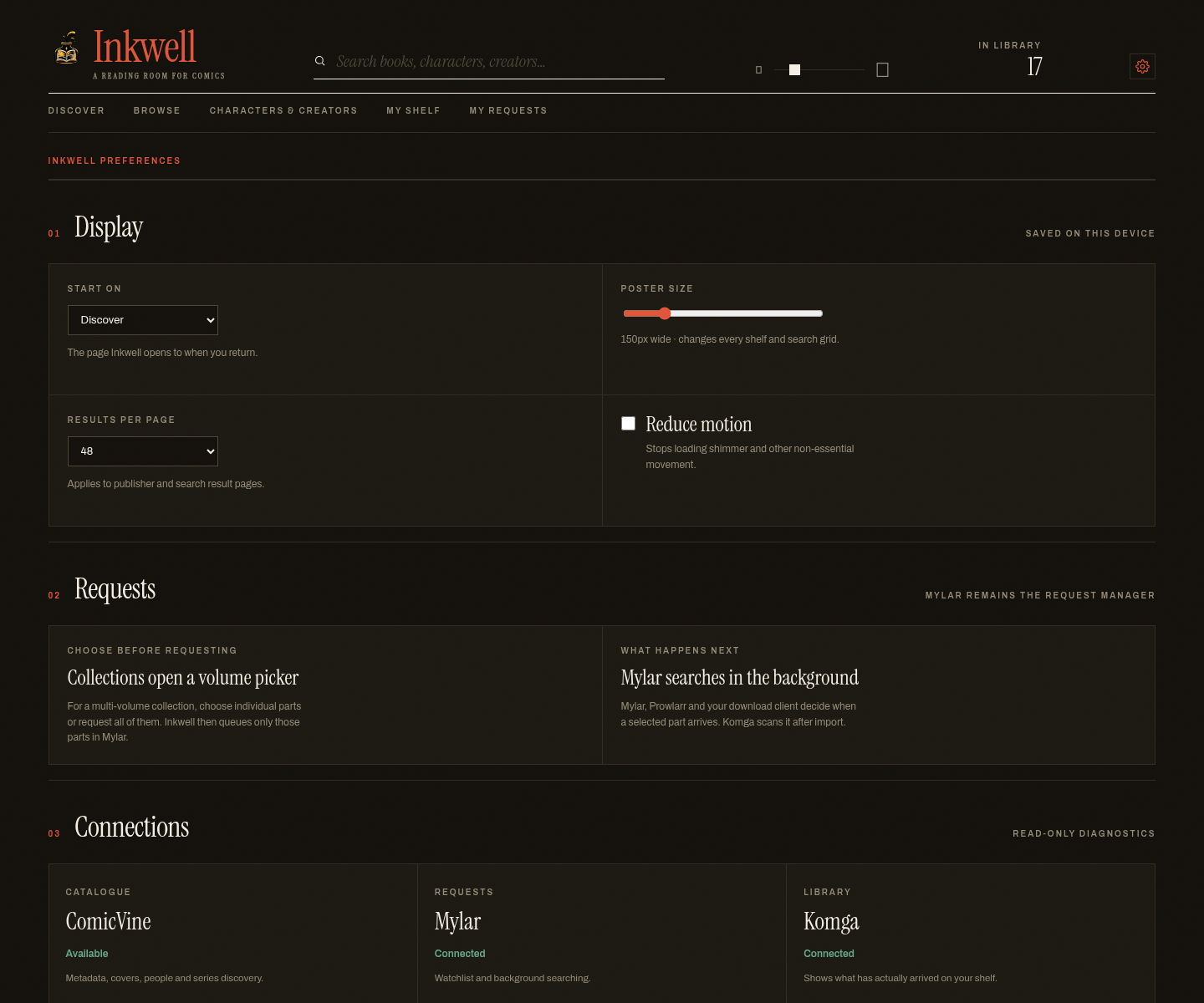

Connections and permissions
Inkwell listens on container port 3000 and makes only the outbound connections below. It does not need the Docker socket or a comics, downloads, or media-library mount.
Connection Required Access and failure behavior
Mylar API (MYLAR_URL) Yes Reads the watchlist and issue state and performs the request actions a reader confirms: add or stop tracking a series, queue or cancel parts, and start a search. Mylar carries its API key in the query string, so keep this traffic on a trusted container network, private LAN, VPN, or HTTPS connection.
Mylar appdata (/run/mylar) Normal install Read-only access to config.ini supplies the Mylar and ComicVine keys. Read-only access to mylar.db adds provider-search timing, wanted dates, scheduled-sweep state, and arrival events. Direct environment keys can replace the config file, but database-backed diagnostics then remain unavailable.
Mylar web UI Optional enhancement Reads and controls Mylar's direct-download queue because Mylar exposes no API for it. If Mylar's own web authentication is enabled, these queue panels and retry/stop controls are unavailable; ordinary API requests still work. Set MYLAR_WEB_URL only when this address differs from MYLAR_URL without /api.
ComicVine HTTPS and its cover hosts Yes for a fresh catalogue Supplies book metadata, covers, creators, characters, teams, and events. Inkwell paces calls globally, backs off on rate limits, and continues serving its saved local catalogue during an outage.
Komga API (KOMGA_URL) No Read-only Basic-authenticated API access identifies which requested books reached the shelf and supplies read links and thumbnails. Credentials come from a read-only Komf config or KOMGA_USER / KOMGA_PASSWORD; no Komga media mount is needed.
Wikidata HTTPS No Keyless character and team relationships. Calls are serialized, cached for a month, and never block the underlying ComicVine page when unavailable.
Notification URL No Sends arrival and stalled-download events by outbound POST in ntfy, Discord, or JSON form. Treat the entire URL as a secret because Discord and some other receivers embed credentials in it.
For a same-host multi-container installation, a shared private Docker network and service names such as http://mylar:8090/api and http://komga:25600 avoid routing API credentials over the wider LAN. A normal LAN address is also supported. Self-signed HTTPS endpoints require their issuing CA to be trusted by the container; there is deliberately no “disable certificate verification” setting.
