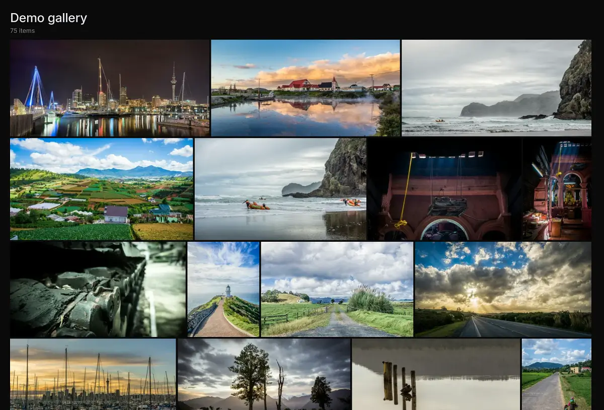

👉 See a Live demo gallery serving straight out of my own Immich instance.

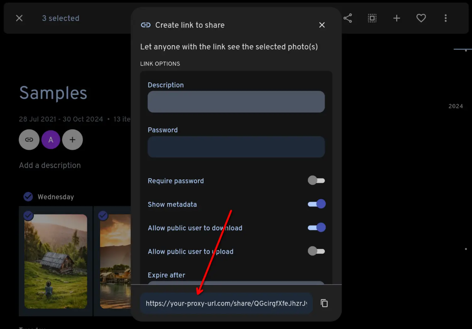

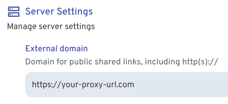

  4. In Immich's Server Settings, set the "External domain" to your IPP URL. Every link Immich generates from now on points at the proxy.

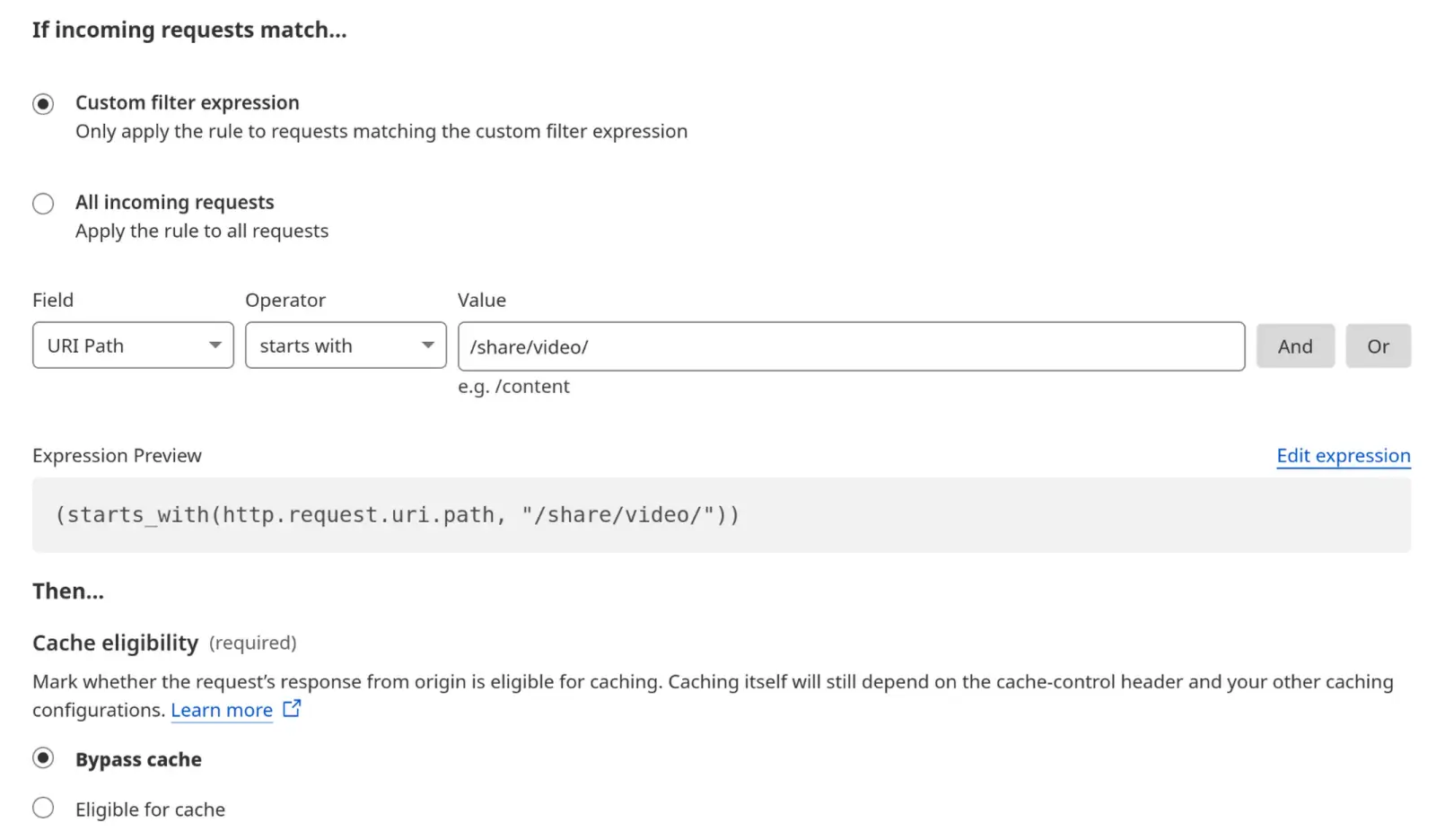

If you use Cloudflare, set your /share/video/* path to Bypass Cache or videos may not play.
