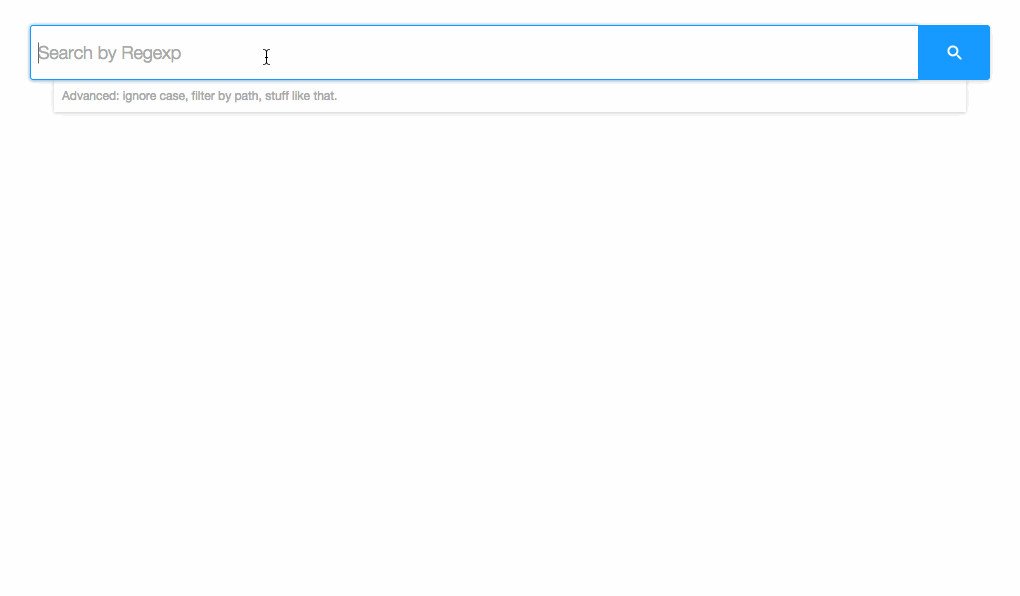

Hound is an extremely fast source code search engine. The core is based on this article (and code) from Russ Cox: Regular Expression Matching with a Trigram Index. Hound itself is a static React frontend that talks to a Go backend. The backend keeps an up-to-date index for each repository and answers searches through a minimal API. Here it is in action:
Hound Screen Capture
