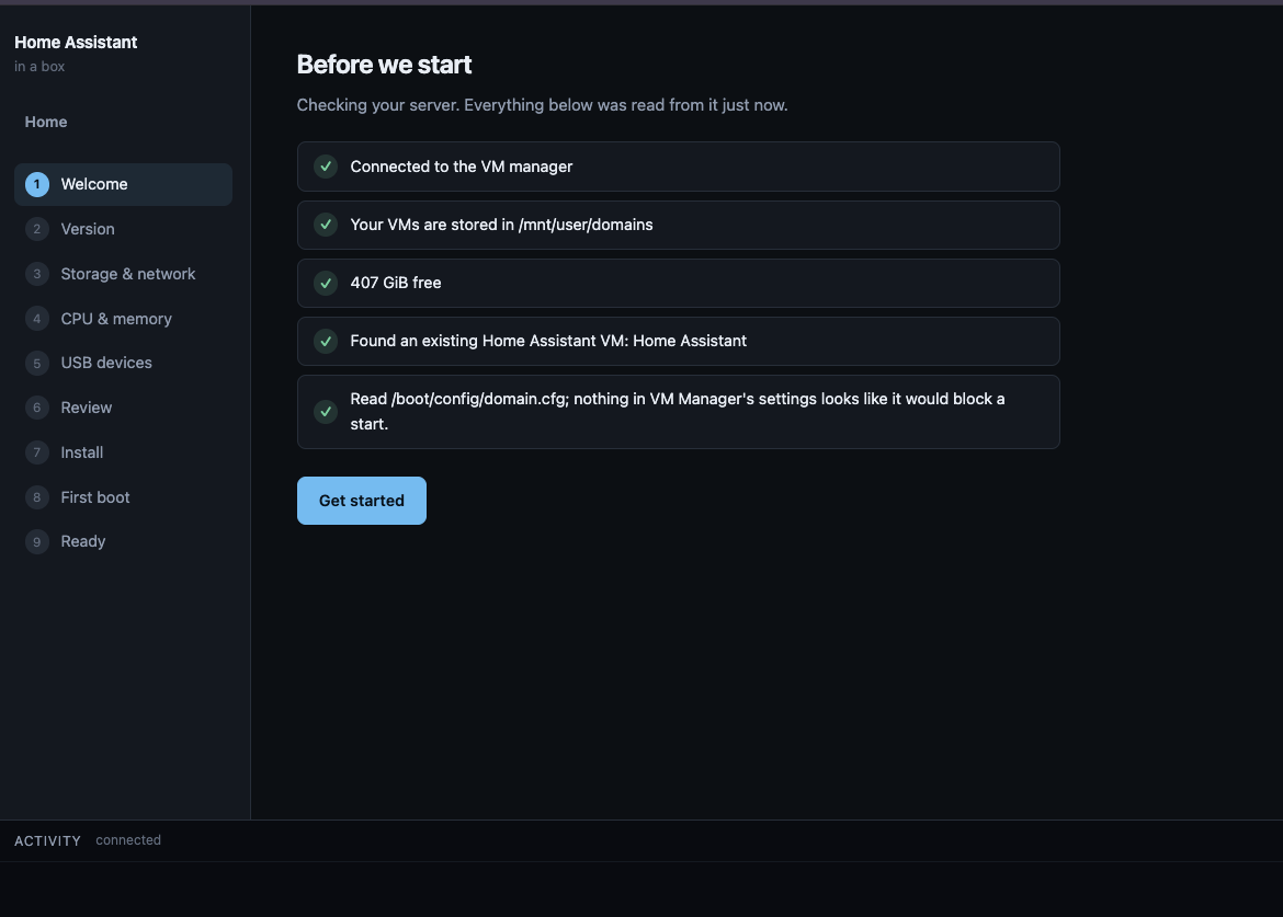

The welcome screen, checking your server before anything is installed

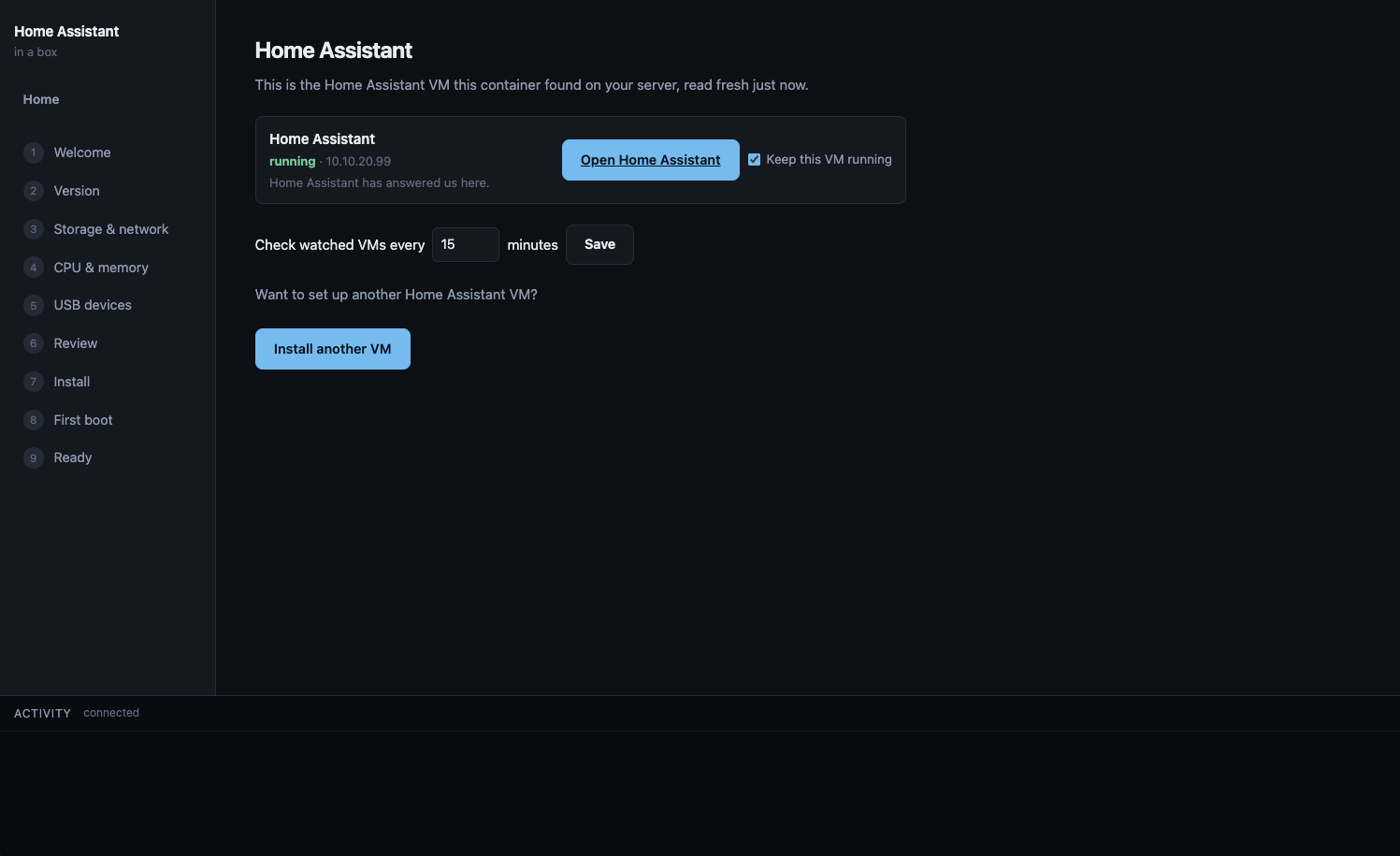

The home page, with a running Home Assistant VM

The wizard walks you through the rest. It checks your server first, tells you what it found and won't let you start an install that can't work, like when the VM service is turned off.

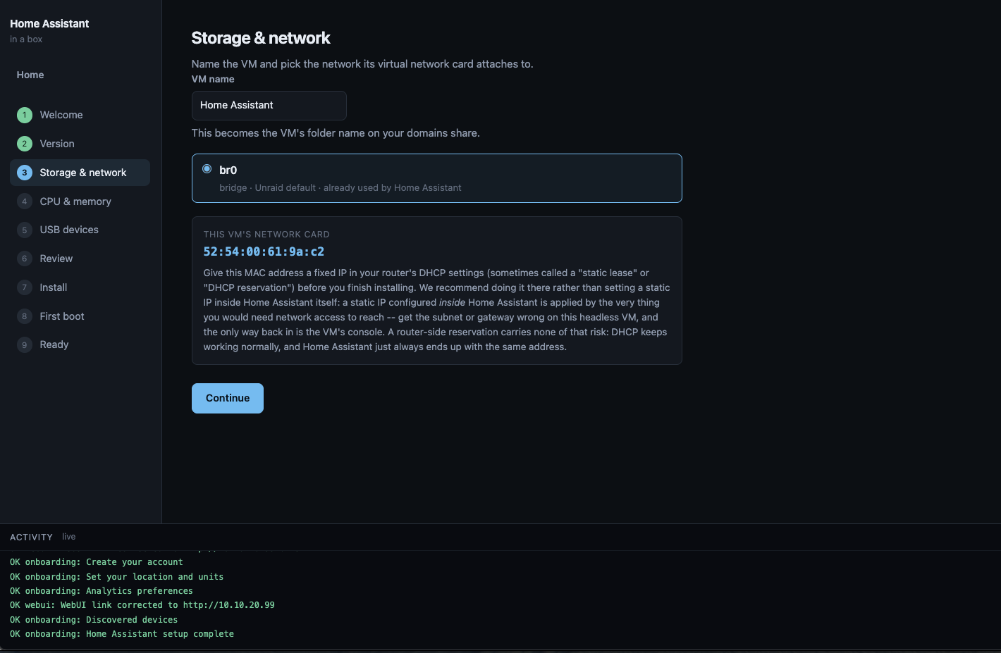

A couple of things worth knowing as you go through it. The storage and network step shows you the MAC address the VM will get and my advice is to give that MAC a fixed IP in your router's DHCP settings before you finish installing. Do it in the router rather than setting a static IP inside Home Assistant itself. A static IP configured inside Home Assistant is applied by the very thing you'd need network access to fix. So if you made a mistake and the subnet was wrong on this headless VM the only way in is the VM console. A router side reservation doesn't have any of that risk.
The storage and network step, showing the MAC address the VM will get

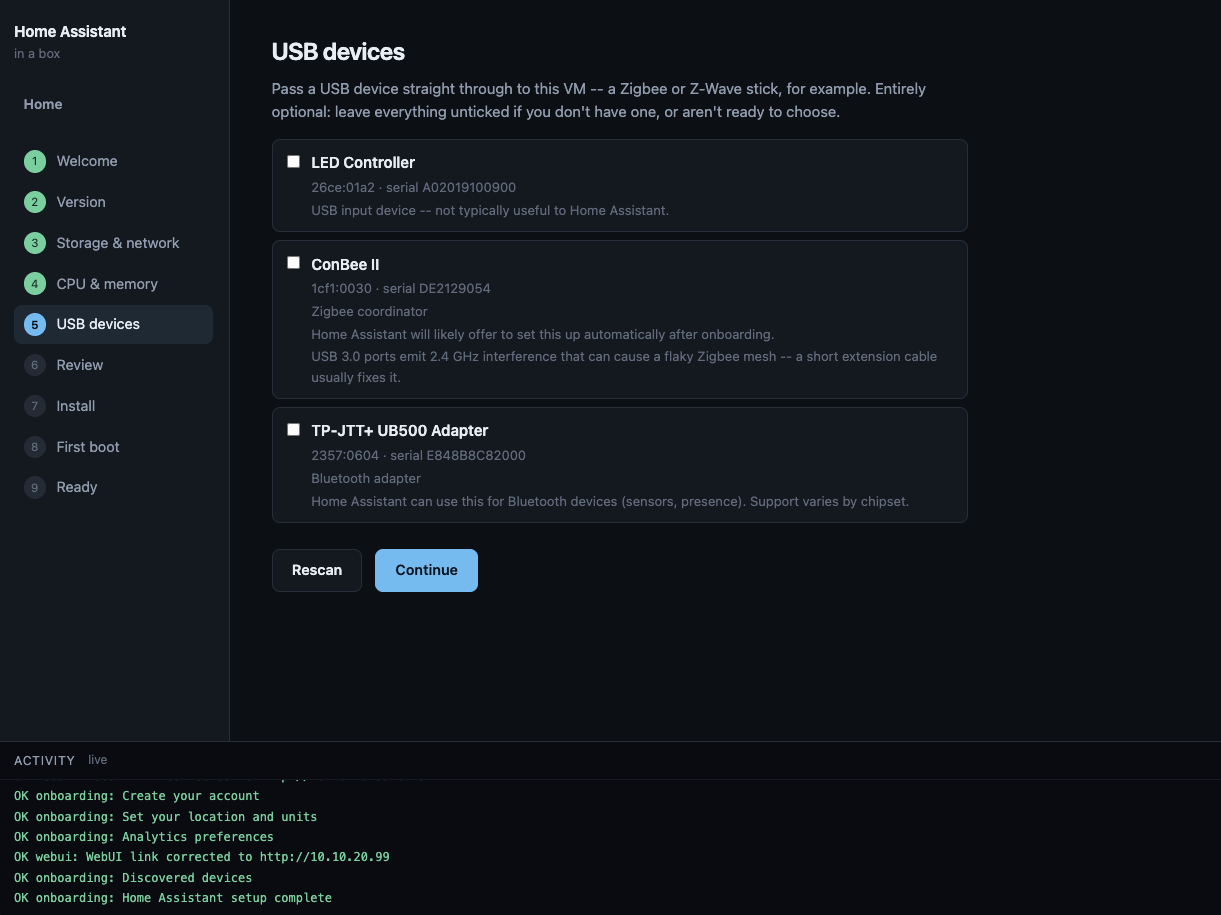

The USB step is optional. If you've got a Zigbee or Z-Wave stick plugged into your server, tick it and it gets passed into the VM, ready for Home Assistant to discover during onboarding. More on how that works below.

After an install, or whenever the container finds Home Assistant VMs already on your server, its web page becomes a status panel rather than the wizard. Each VM it's sure about gets a row with its state, its address, a button to open it and a checkbox called keep this VM running.
Tick that checkbox and the container watches the VM. If it's found stopped, it gets started again and you get a notification through whatever channels you've set up in Unraid's own notification settings. The container doesn't invent its own notification system, it uses yours. If a VM refuses to stay up the watcher notices it's flapping, stops trying and tells you why instead of restarting it in a loop forever.
The watch settings survive container restarts and image updates, so you set them once.
One thing I'd point out here. The container only ever starts VMs, it never stops them. There's no stop button on the panel and the watcher will never shut anything down. Stopping your VM is your business and Unraid's VM manager does it fine.

This is the part I think beginners will appreciate most. The USB step doesn't just list devices, it tells you what they are when it honestly can.
The USB step, naming the devices it recognises
It ships Home Assistant's own USB discovery data, the same data Home Assistant uses to recognise sticks itself. So a ConBee II shows up labelled as a Zigbee coordinator, a Z-Stick as a Z-Wave controller and so on. Bluetooth adapters are recognised by their USB class, which works for adapters that didn't exist when this container was built. A few well known devices get a word of advice too. If it sees a UPS it'll mention that Unraid usually monitors that itself and passing it through takes it away from your server's shutdown protection. If it sees a Google Coral it'll mention those are usually better left on Unraid for a Frigate container.
When it doesn't know what something is, it says nothing rather than guessing. A confidently wrong label is worse than no label. Devices it can't identify are still listed and still selectable, just without a claim attached.
2 things are never offered at all. USB hubs and your Unraid boot flash. Passing the boot flash into a VM would take your server down, so the container uses the same detection Unraid itself uses and keeps it off the list entirely, wherever it's plugged in.
If you pass a stick through and later unplug it, the VM still boots. The passthrough is written as optional so a missing device is skipped rather than being a boot failure.
For Zigbee sticks specifically, plug them into a USB 2.0 port or use a short extension cable if you can. USB 3.0 ports put out interference right in the 2.4 GHz band Zigbee uses and it's a well known cause of flaky Zigbee networks. The wizard reminds you of this when it sees a Zigbee coordinator.
