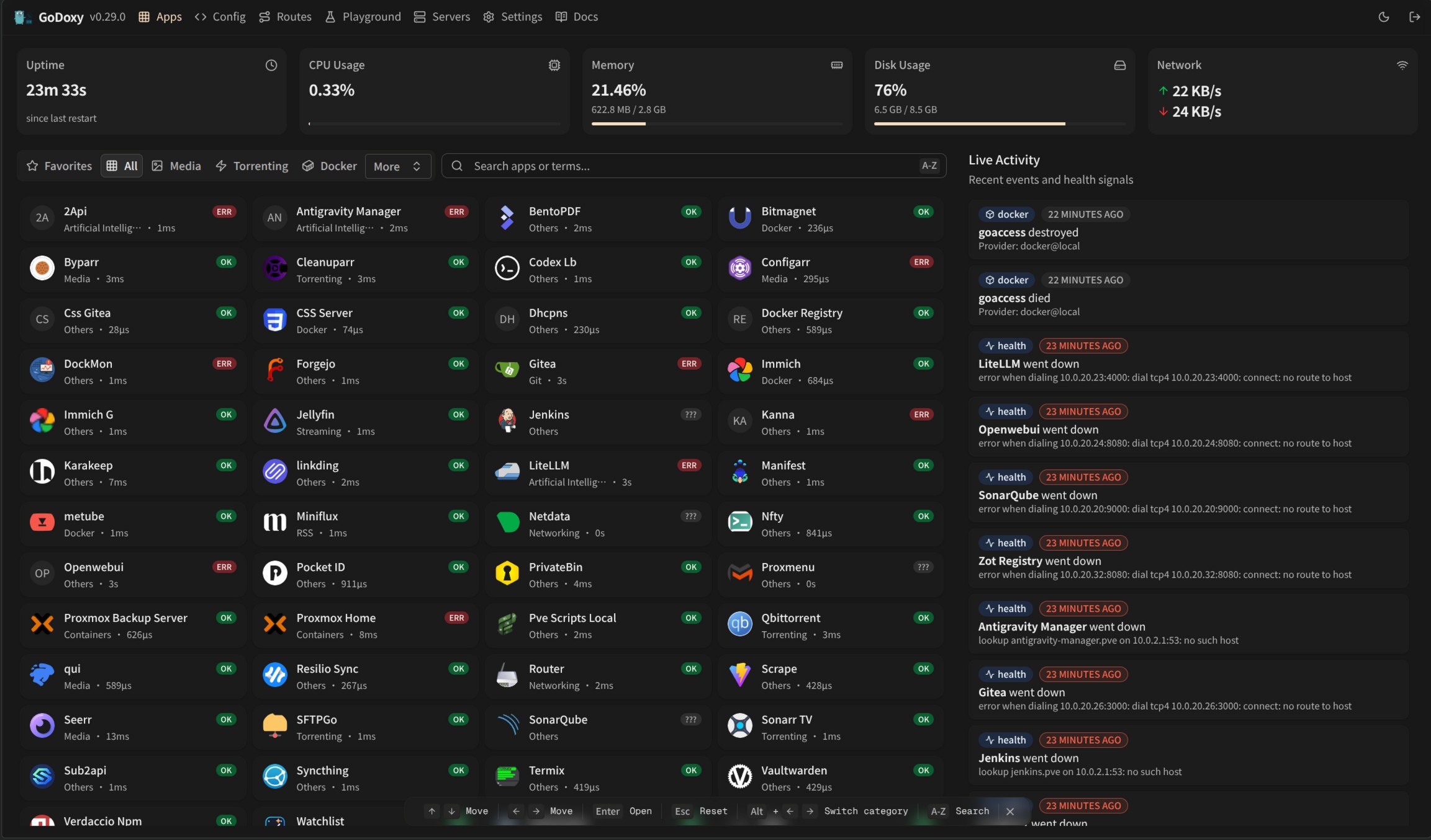

Screenshots
idlesleeper
idlesleeper

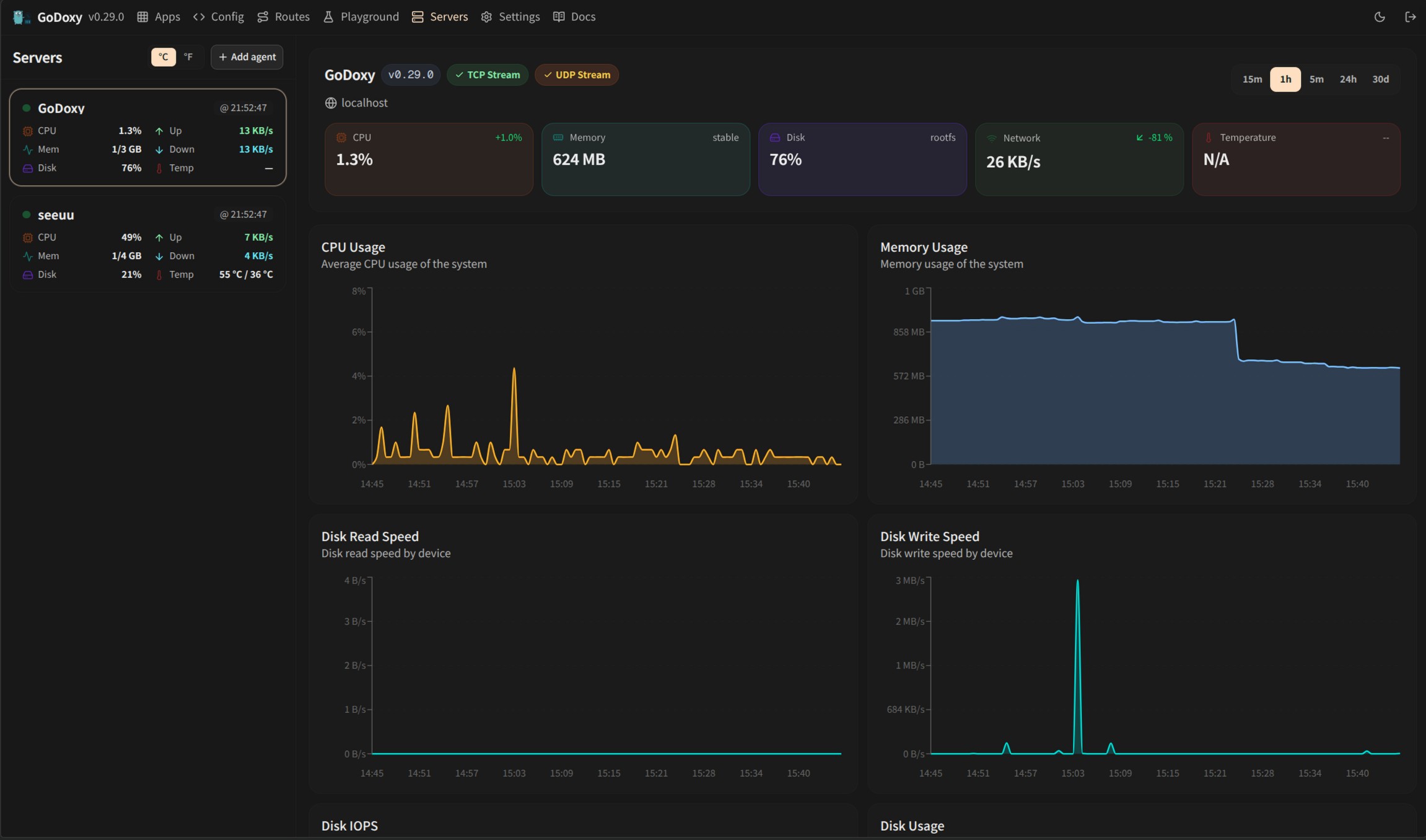

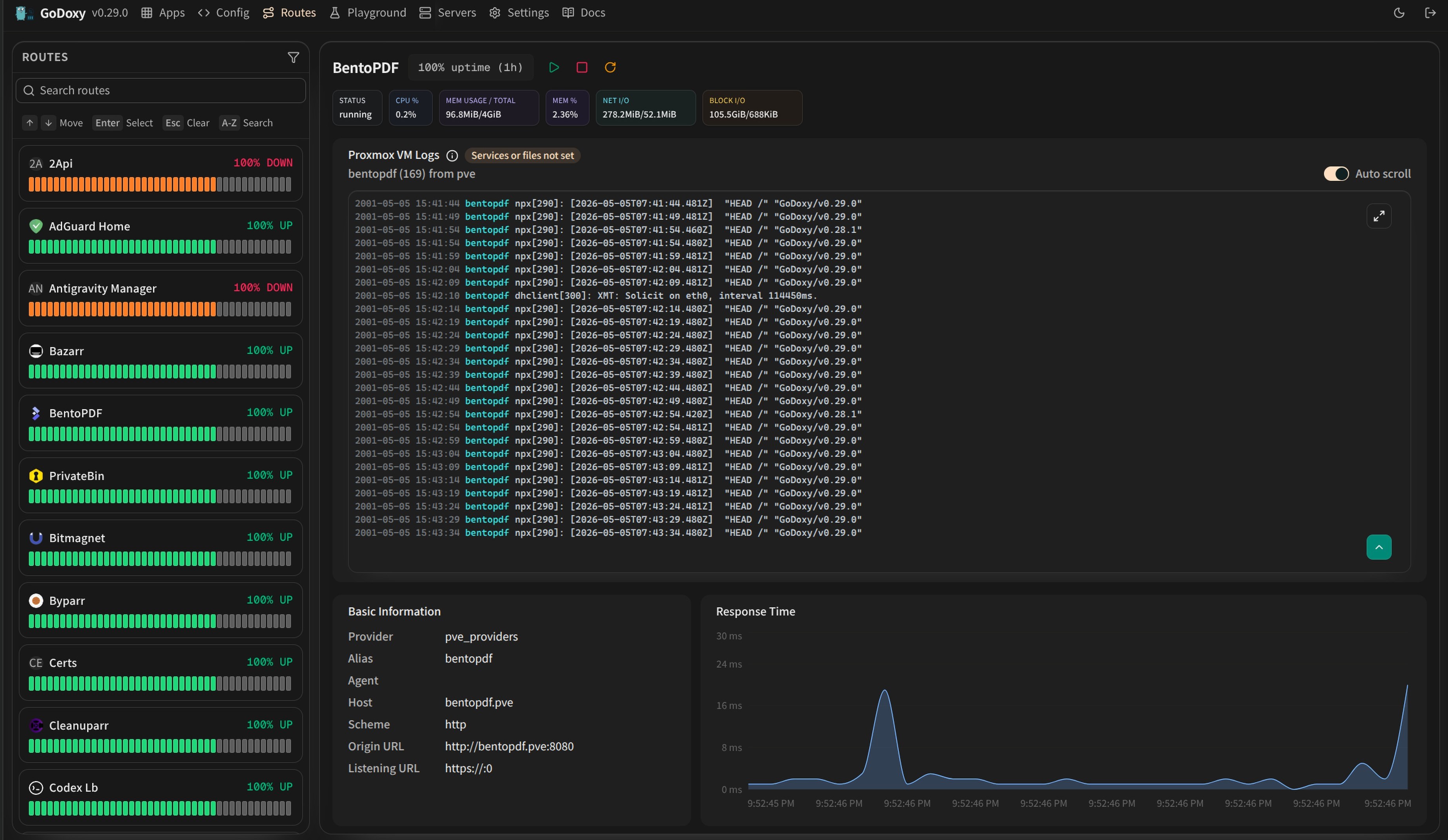

Metrics and Logs
Routes Servers
Routes Servers
