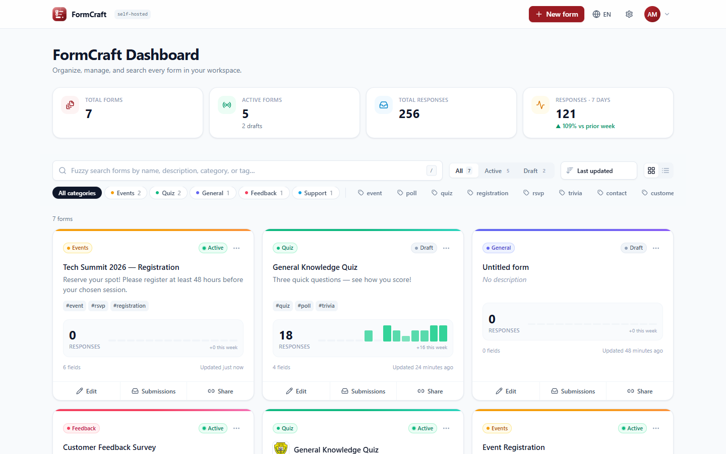

FormCraft dashboard
FormCraft is an open-source form builder you run on your own hardware. Build forms with a drag-and-drop editor, share a link, and review responses in a built-in data table. Your data stays in a database you control: a bundled PostgreSQL container, your own PostgreSQL server, or an embedded SQLite file.

✨ Features
🎛️ FormCraft Dashboard
  • A card for every form, showing total responses, a 14-day response sparkline, Active/Draft status, field count and last update
  • Fuzzy search across title, description, category and tags (powered by Fuse.js, so it tolerates typos: feedbak survy still finds the right form)
  • Category chips, tag filters (multi-select), status segments and sorting (updated, latest response, most responses, A–Z)
  • Grid and list views (your choice is remembered)
  • Quick actions: Edit, View submissions, Copy share link, plus Duplicate, Publish/Unpublish and Delete
  • Workspace stats: total forms, active forms, total responses, and 7-day responses with week-over-week trend
  • Keyboard shortcuts: / to search, N for a new form
