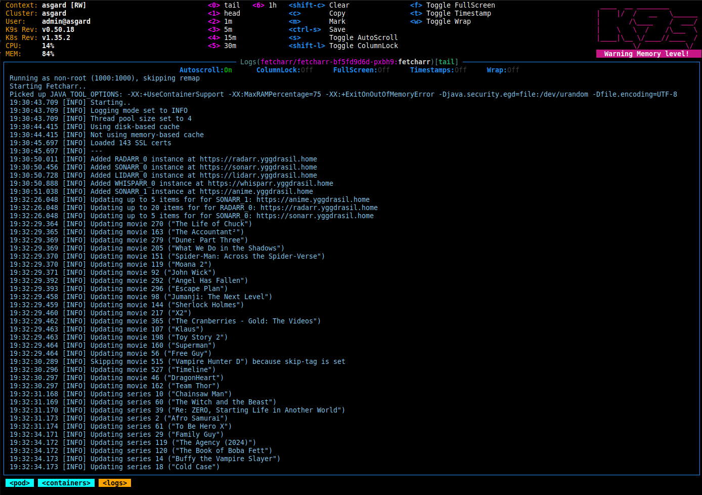

If the concept sounds interesting to you, give Fetcharr a try. See if it finds anything. If my experience while developing this is anything to go by, you'll get some results almost immediately. Likely within a few hours, and maybe even within a few seconds. See if it helps and if you want to add it to your stack.
How do I use it?
Docker, Kubernetes, whatever container system you currently use. Use the latest tag for the latest production build or the dev tag for the latest development build.

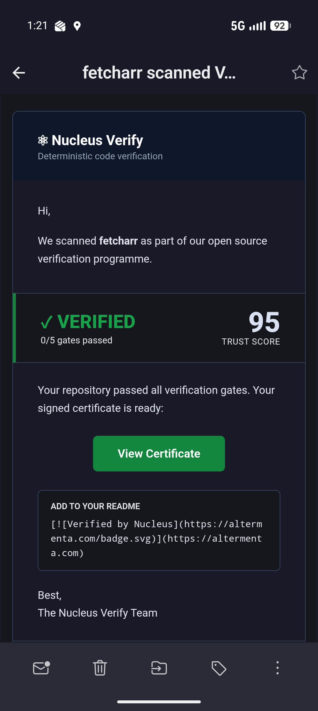

It definitely feels like I won a contest that I wasn't aware I was in. Passed all 0 gates, too!

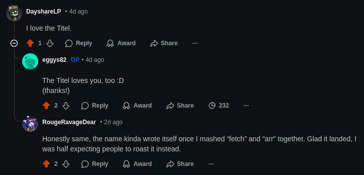

I'm terrible at naming these things, so I'm grateful to have someone who came up with the name "fetcharr". A few days after it released. Glad someone is on the ball, at least!
