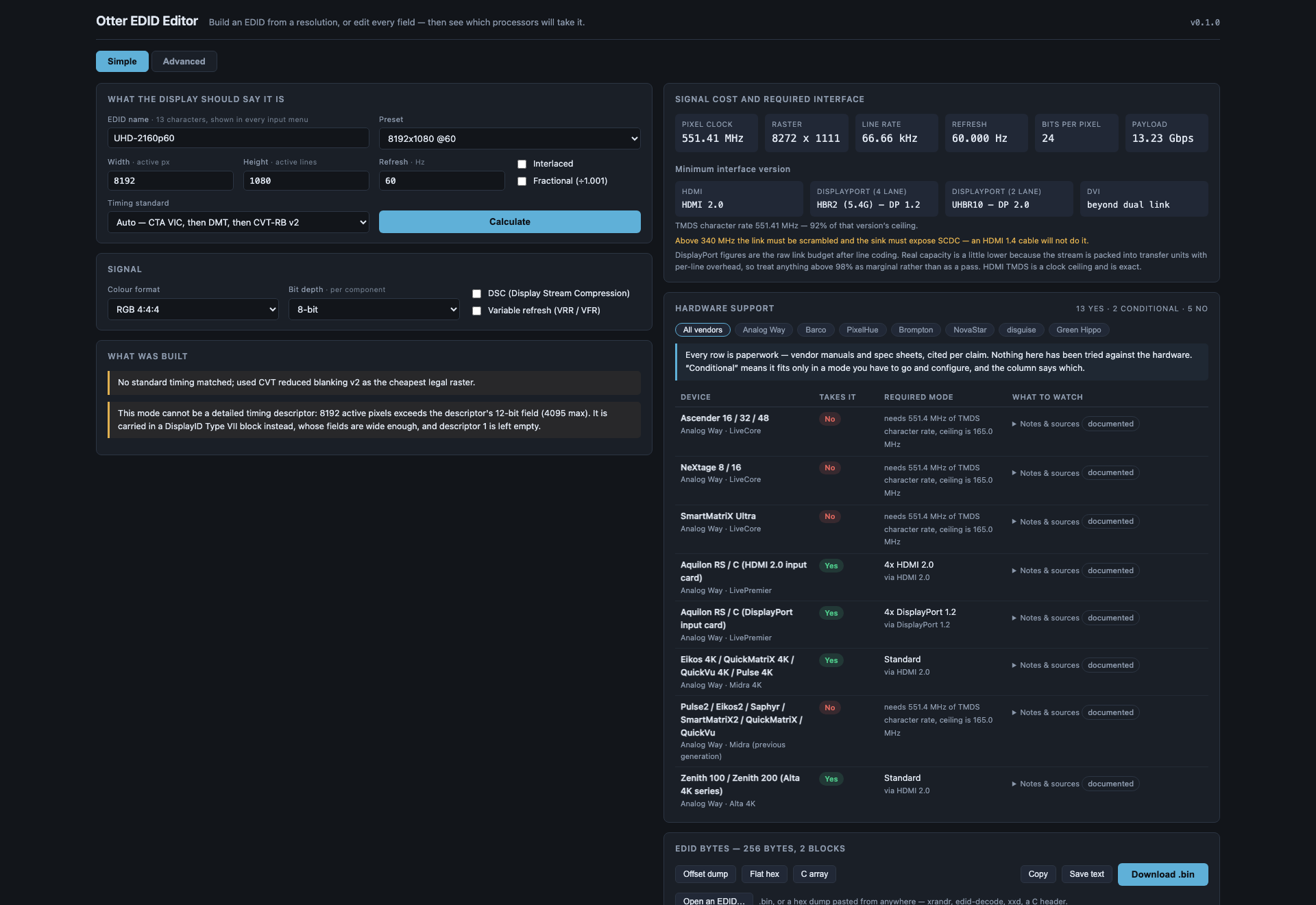

EDID Editor building an 8192 × 1080 @ 60 EDID: the raster it needed, the signal cost, and the per-processor support table
An 8192 × 1080 @ 60 EDID built in Simple mode: the CVT-RB v2 raster it needed, a 551 MHz pixel clock that puts it past HDMI 1.4, the minimum interface per standard, and the per-processor table saying which will take it. Every row comes from the vendor's own documents, and none of it has been tried against hardware.
