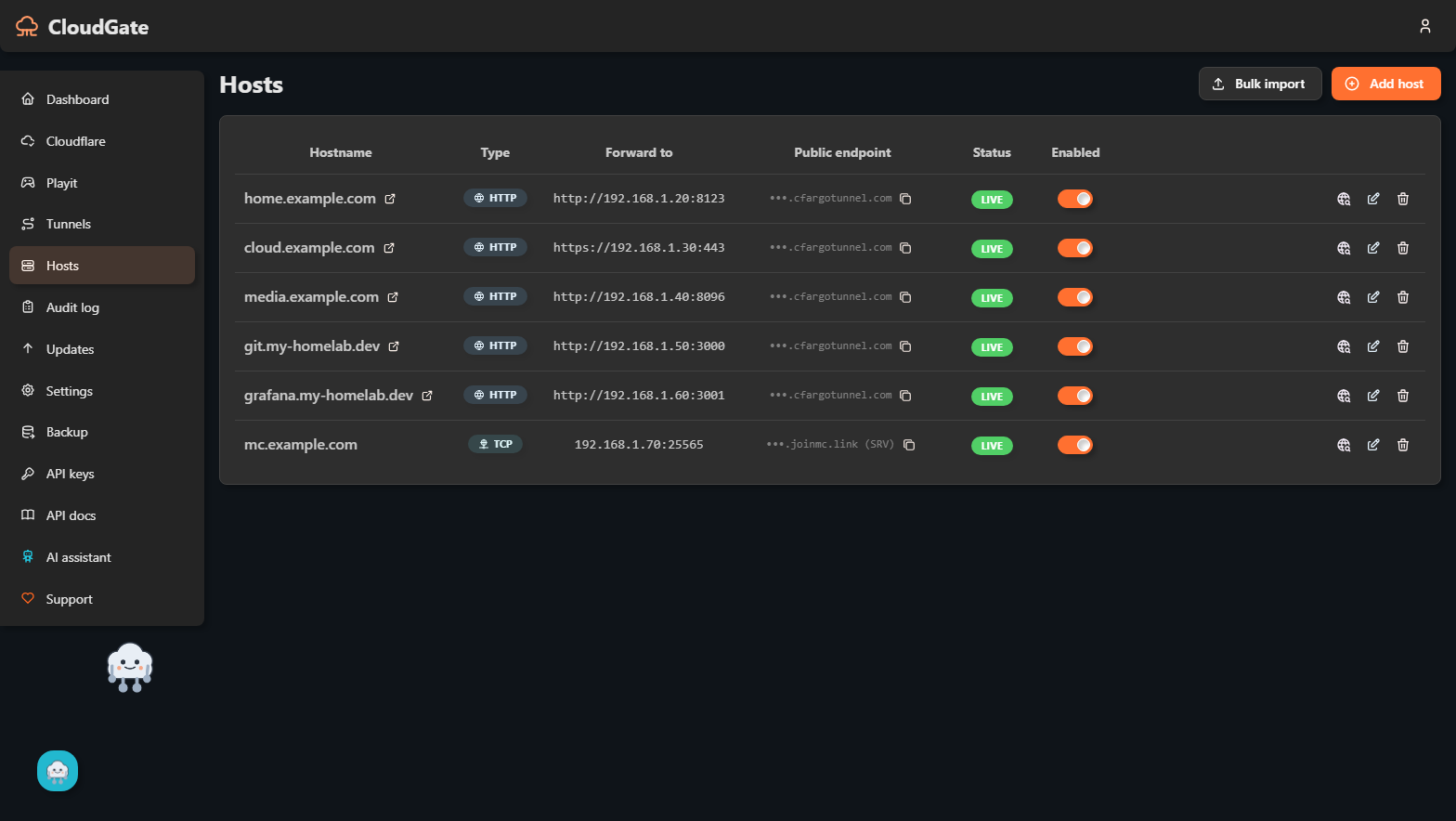

CloudGate is a WebUI that does it all:
  • Add a service: enter 192.168.1.42:8080 and immich.yourdomain.com → done.
  • CloudGate creates the Cloudflare Tunnel, DNS record, ingress rule, and reloads cloudflared.
  • Need raw TCP/UDP instead of HTTP — a Minecraft server, SSH, a game server? Playit.gg tunnels handle that (Cloudflare's free tier can't). See Hosting a Minecraft server.
  • Hybrid mode: per host, pick "via Cloudflare Tunnel" OR "local nginx reverse proxy".

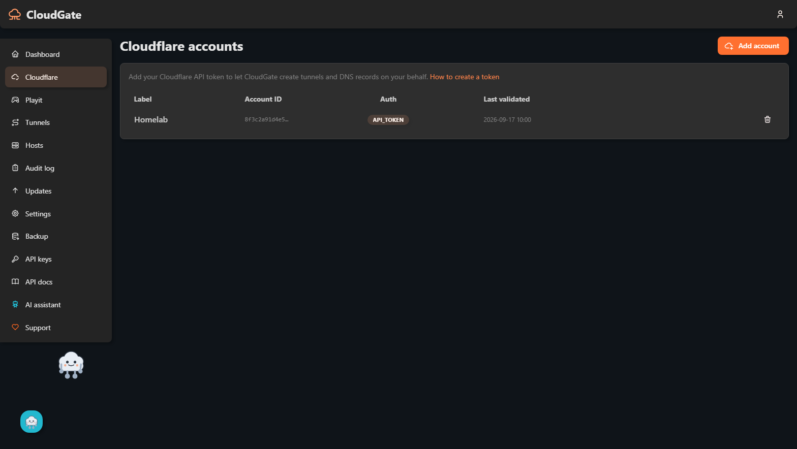

  4. Add your Cloudflare API token in the UI (instructions: see docs/CLOUDFLARE_SETUP.md).

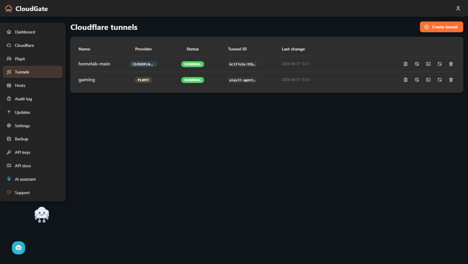

Tunnels Create, restart, delete · live status · log tail · auto-revive on container restart · SIGHUP reload
