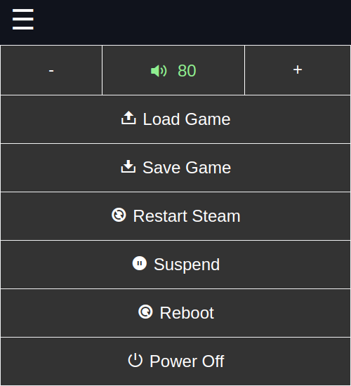

  • quick actions
    • adjust audio volume
    • toggle the performance overlay
    • load/save emulator state
    • restart steam

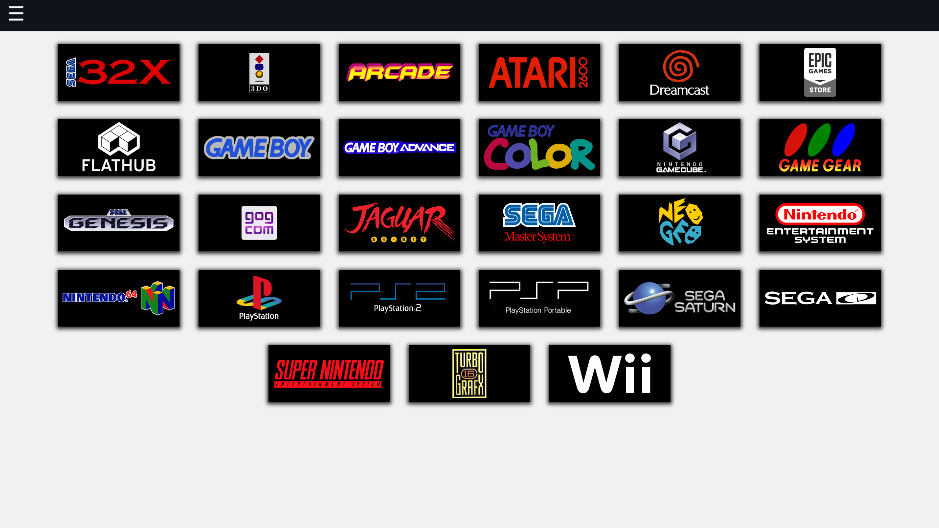

Library page
Library

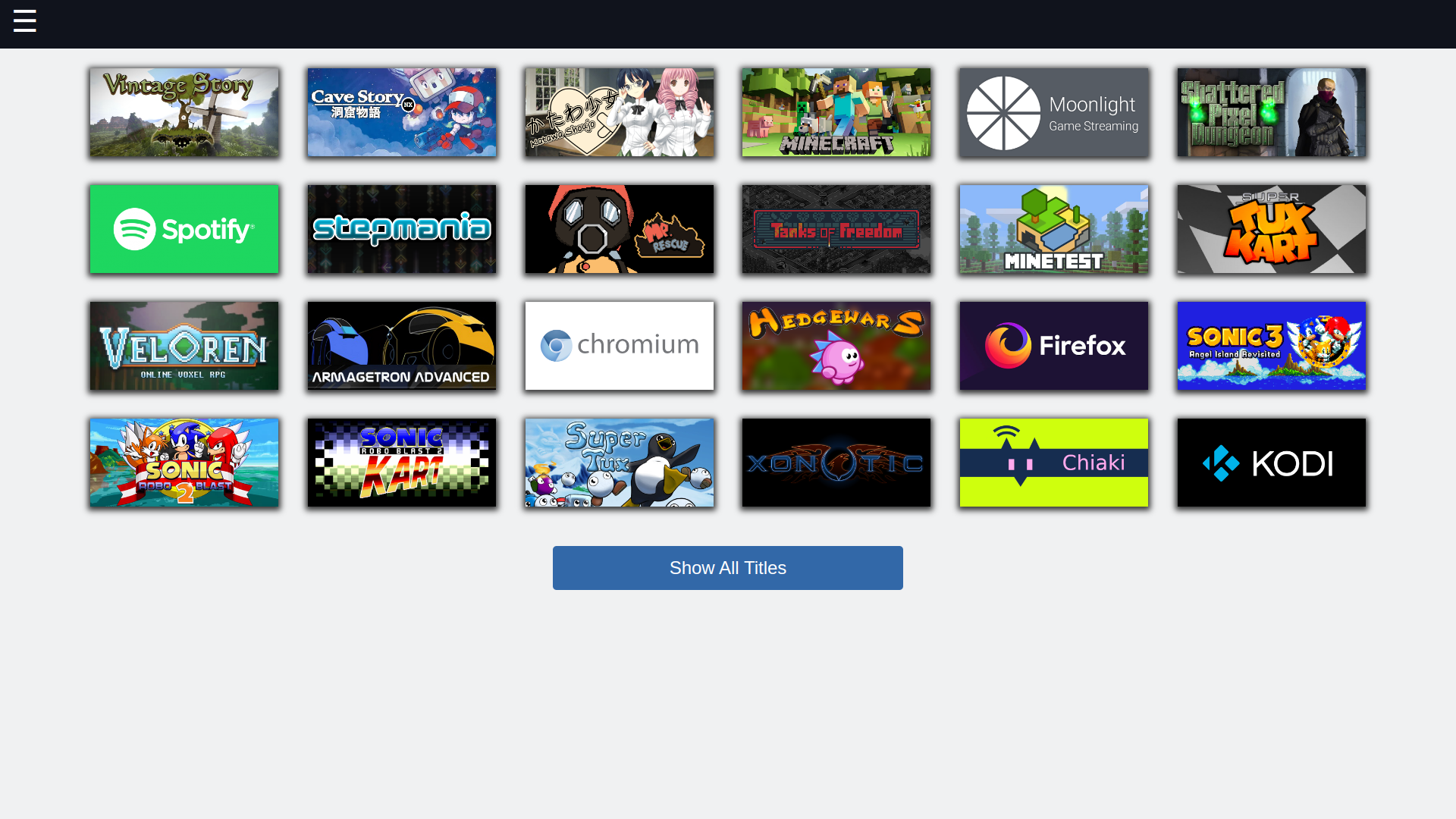

Flathub library page
Flathub

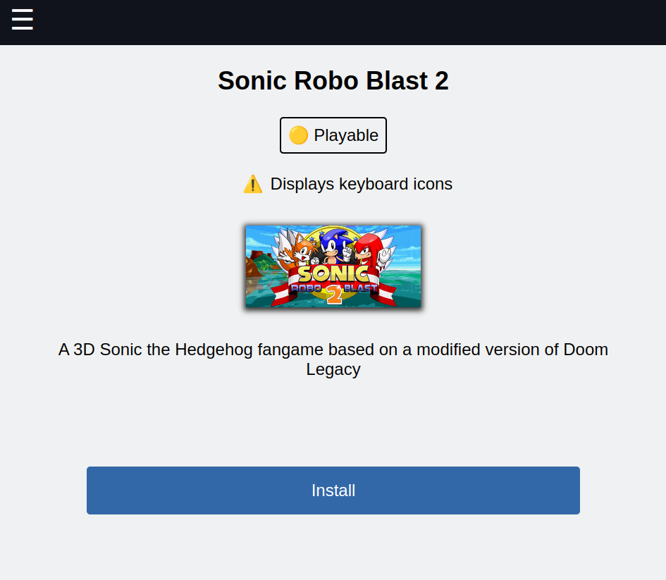

Flathub game page
Flathub Game
Actions page
Actions

GOG, Epic, and Flathub applications and games are evaluated for compatibility and assigned a rating of "Unsupported", "Playable", and "Verified", reflecting the Steam Deck ratings. You can contribute to these ratings by submitting a PR against chimera-data or commenting in the compatibility-reports channel on the ChimeraOS Discord.
Install Flathub apps
You can install any application on Flathub by going to Library, then selecting Flathub.
Chimera also looks in ~/.local/share/chimera/banners/flathub/ for a list of additionally allowed Flathub applications. Just add a PNG or JPEG image of size 460x215 or 920x430 with the Flathub app ID as the file name under that directory. The Flathub app ID can be obtained from the last part of the URL of the Flathub page for the application. For example, the ID for Minecraft is com.mojang.Minecraft.
If the application works well please create a new issue with the app ID and grid image so it can be added to the set of installable default apps.

Upload ROMs
You can upload ROMs and banner images to Chimera, and they will be added to Steam. The emulators are pre-configured and ready to play out of the box with almost any controller.
The following platforms are currently supported:
  • 32X (requires BIOS file)
  • 3DO (requires BIOS file)
  • Arcade
  • Atari 2600
  • Dreamcast
  • Game Boy
  • Game Boy Advance
  • Game Boy Color
  • GameCube
  • Game Gear
  • Genesis/Mega Drive
  • Jaguar
  • Master System
  • Neo Geo (requires BIOS file)
  • Nintendo
  • Nintendo 64
  • PlayStation (requires BIOS file)
  • PlayStation 2
  • PlayStation Portable
  • Saturn (requires BIOS file)
  • Sega/Mega CD (requires BIOS file)
  • Super Nintendo
  • TurboGrafx-16/PC Engine
More platforms will be added over time.
