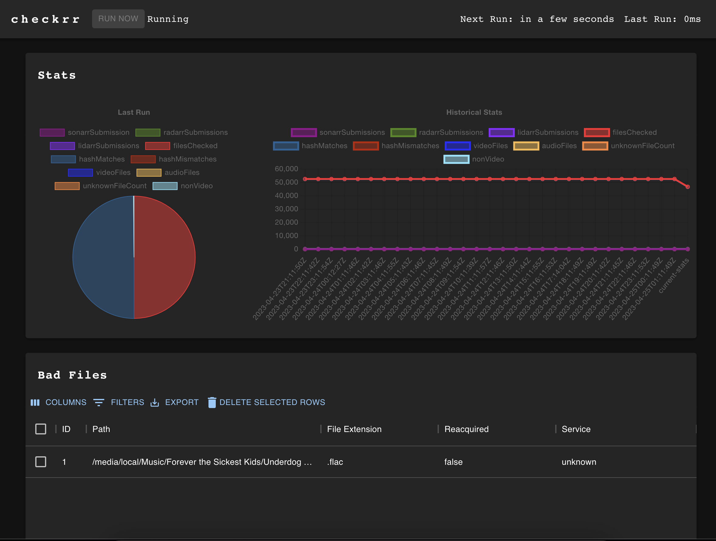

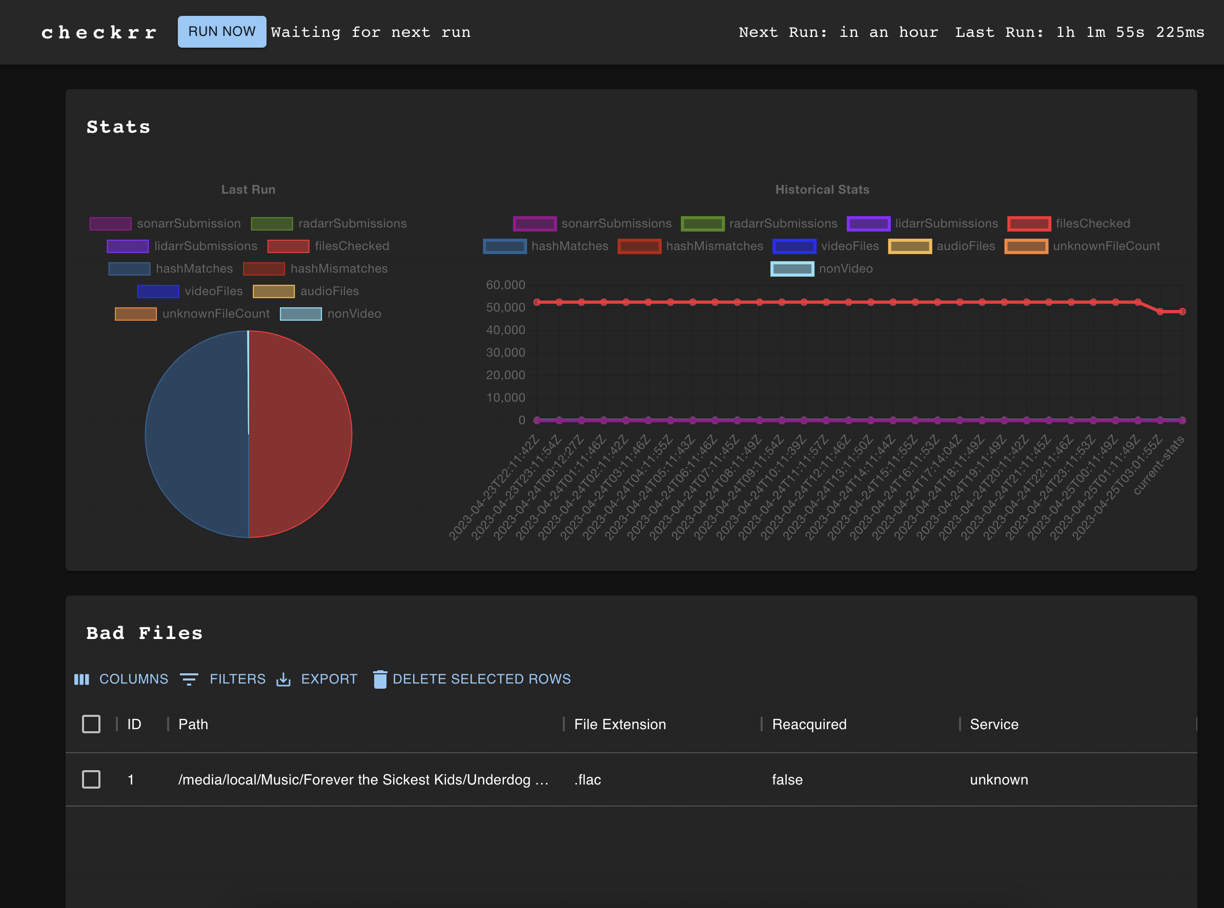

Screenshots
Idle screenshot Running screenshot
