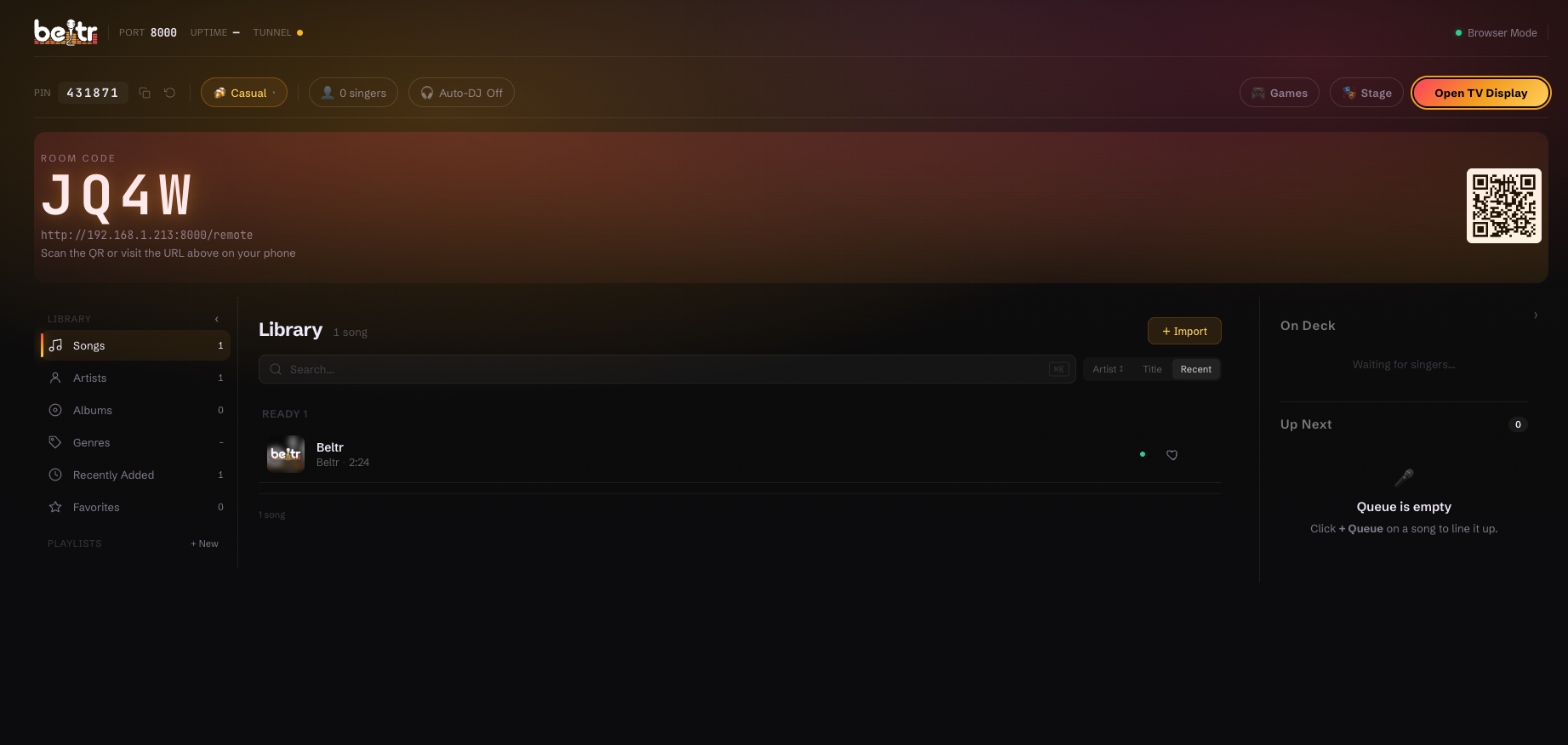

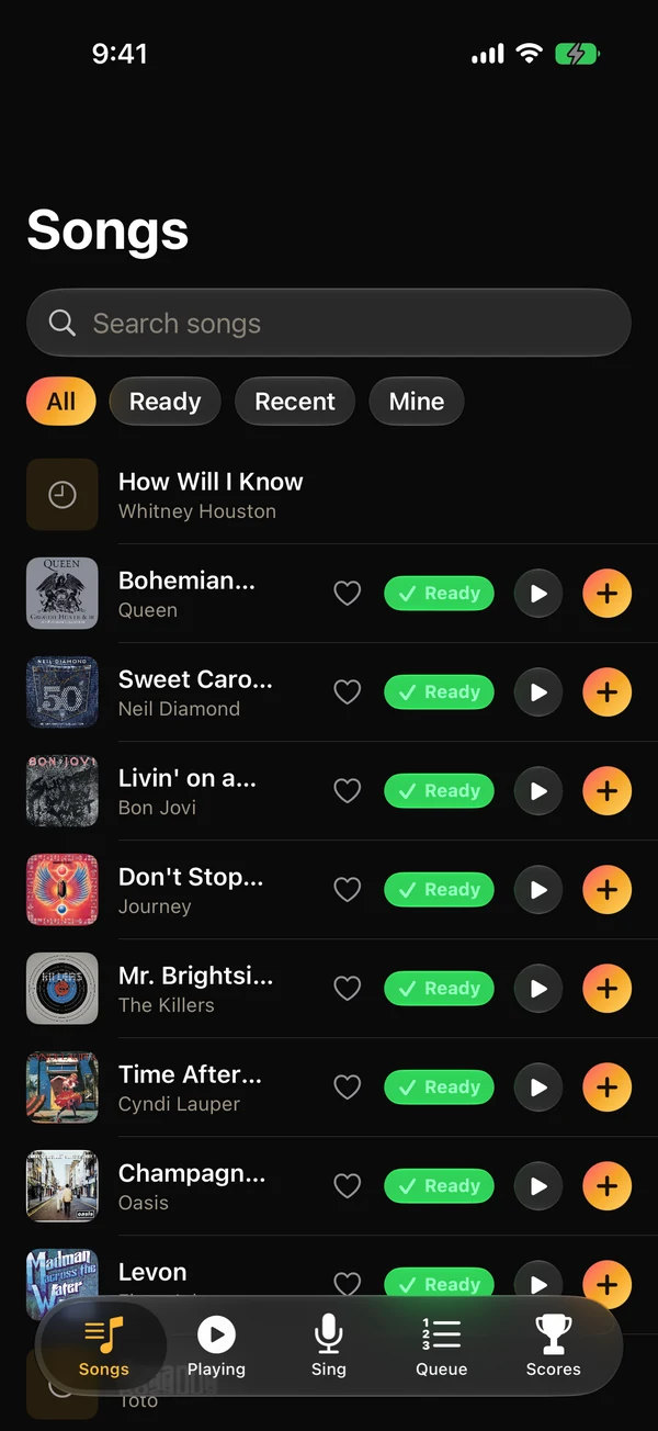

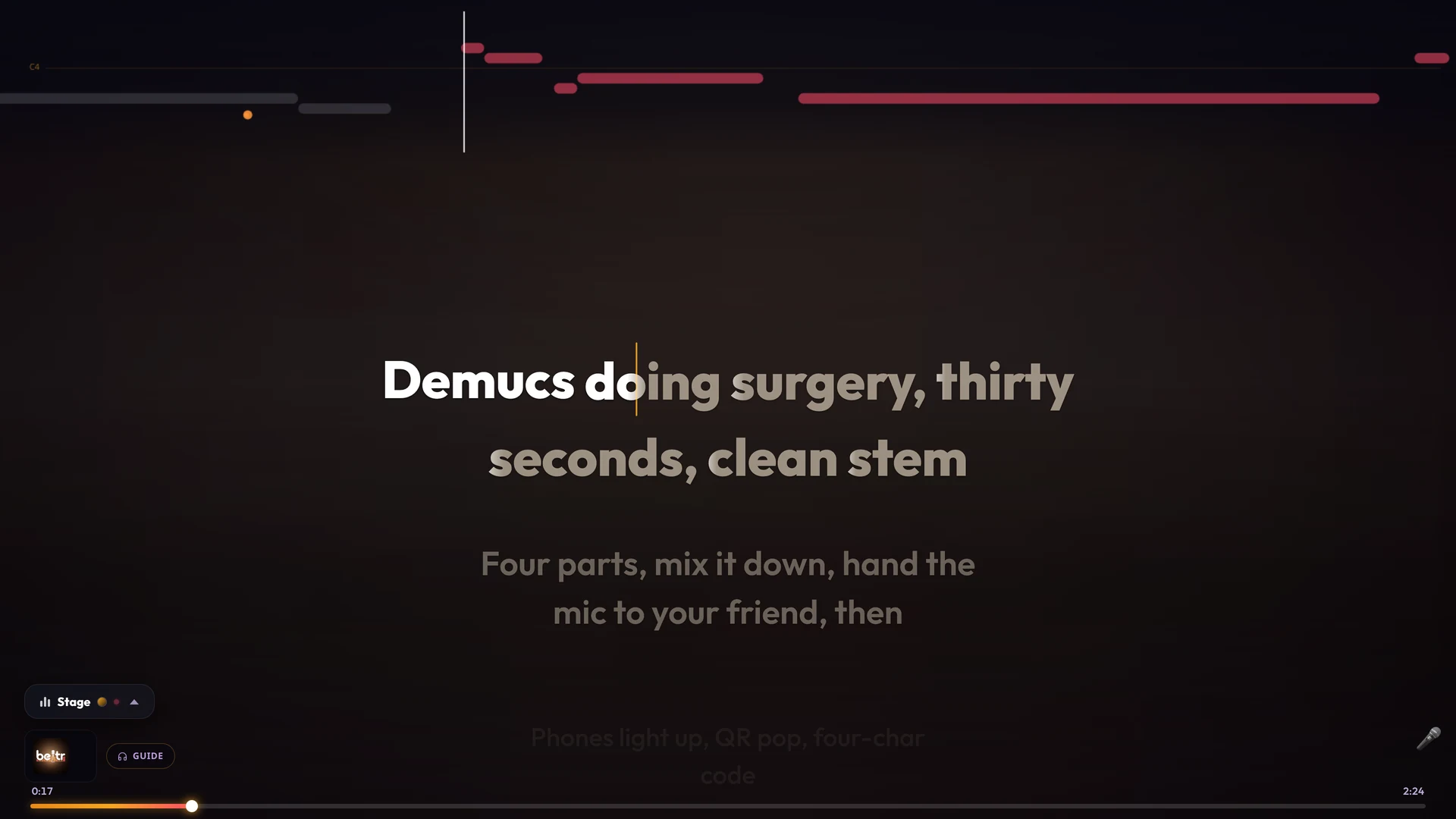

Karaoke night from the music already on your server. Beltr strips the vocals with local AI, puts word-synced lyrics on the TV, and makes every phone a remote, no app needed. NVIDIA build: separates a song in well under a minute. No NVIDIA card? Pick Beltr. Beltr turns any song in your music library into a karaoke track. It separates the vocals out with a local AI model, finds synced lyrics online (or drafts them locally when no provider has the song), force-aligns them to the vocal word by word, and displays them on a TV while everyone's phone acts as a remote — scan the QR code on screen, no app to install. Everything runs on your server. Nothing about your library is uploaded. THIS IS THE NVIDIA GPU BUILD. It needs the Unraid "Nvidia-Driver" plugin installed and your GPU passed through. Two settings below do that: NVIDIA_VISIBLE_DEVICES must hold your card's UUID (the Nvidia-Driver plugin page in Settings shows it, like GPU-1a2b3c4d-...), and "Extra Parameters" must contain --runtime=nvidia, which this template already sets. If you do not have an NVIDIA GPU, install plain "Beltr" instead. This image is several GB larger and gains you nothing without a card. It will still run — it falls back to the CPU — so a broken passthrough shows up as "slow", not "broken". Check the GPU panel in Settings after install to confirm the card was actually found. FIRST RUN: Beltr downloads about 2 GB of model weights into /cache the first time it needs them. That happens once and survives container updates as long as /cache stays mapped. Watch the container log if a first song seems to sit still — the download is what it's doing. SPEED: with a working GPU, separating a 3-4 minute song takes well under a minute. Most songs then get their lyrics instantly from an online lyrics database; the ones no provider knows fall back to local transcription, which the GPU also accelerates. LICENSE: Beltr is a one-time purchase (no subscription). Run it free for five songs, then enter your key from beltr.app in the License key field below — or drop it in a file at /config/license.key. It activates once and then works offline. Container updates and restarts do not re-activate, as long as you keep the Config path mapped; a key covers two installs. AFTER INSTALL: open the WebUI, go to Settings, and add /media as a music folder. Then open http://your-server:8477/tv on whatever screen you're singing at, and scan the QR with a phone. MICROPHONES NEED HTTPS: browsers only allow microphone access on a secure page. Beltr serves one itself on port 8478 with a self-signed certificate: open https://your-server:8478/tv on the laptop or phone that has the microphone and accept the browser's warning once. Everything else — queueing, playback, lyrics, stem mixing, the QR the TV shows — works over plain http on 8477. A reverse proxy with a real certificate is only needed if you want no warning at all. NOTE: Beltr assumes everyone who can reach it is trusted. Set AUTH_PASSWORD to put a password on the TV and dashboard screens, but do not expose this container to the internet without a reverse proxy doing real authentication in front of it.

Lyrics on the TV screen
