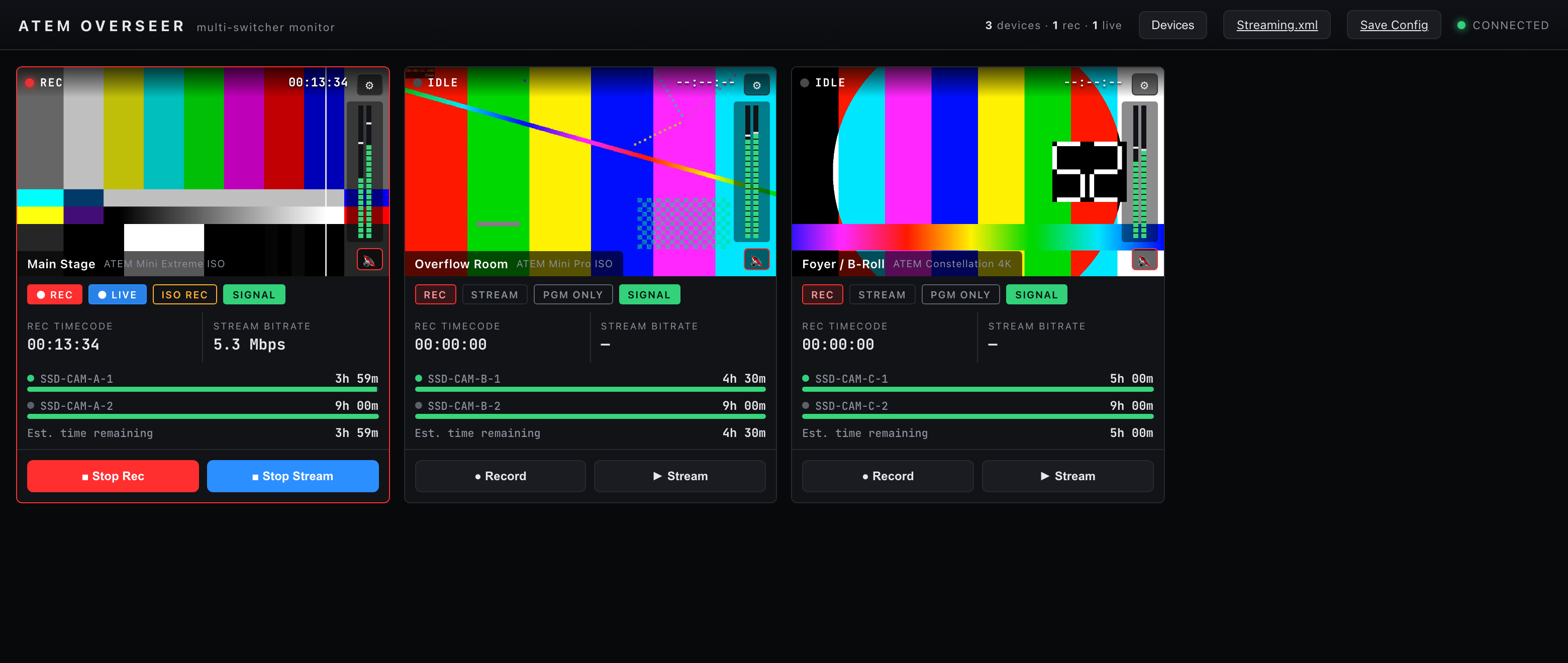

Atem Overseer dashboard
The dashboard running the built-in --mock fleet: one tile per switcher with record/stream status, live program-audio meters, drive time-remaining, ISO/PGM mode and transport controls.
You can click around it yourself at https://atem-overseer-demo.stoatworks-labs.com. It's the dashboard in your browser, replaying recorded telemetry from the --mock fleet, so the meters move and the timecode runs. The transport controls do nothing there and say so, because the server has to be on the network with your switchers to control anything. See demo/README.md.

Point it at any number of ATEMs on your network and get, per device:
  • Record & stream status with live timecode and a tally-red tile border when rolling
  • Drive capacity / estimated time remaining per disk, with working-set and low/critical warnings
  • ISO vs PGM-only record-mode indicator (and toggle)
  • Stereo program audio metering (Fairlight levels, peak-hold) that runs at display rate
  • Live output preview: the ATEM streams to Overseer's bundled RTMP ingest and plays back in the tile with no transcode
  • Per-device audio monitoring you can mute/un-mute independently, so you listen to one wall at a time
  • Remote transport: start/stop record and stream from the browser
