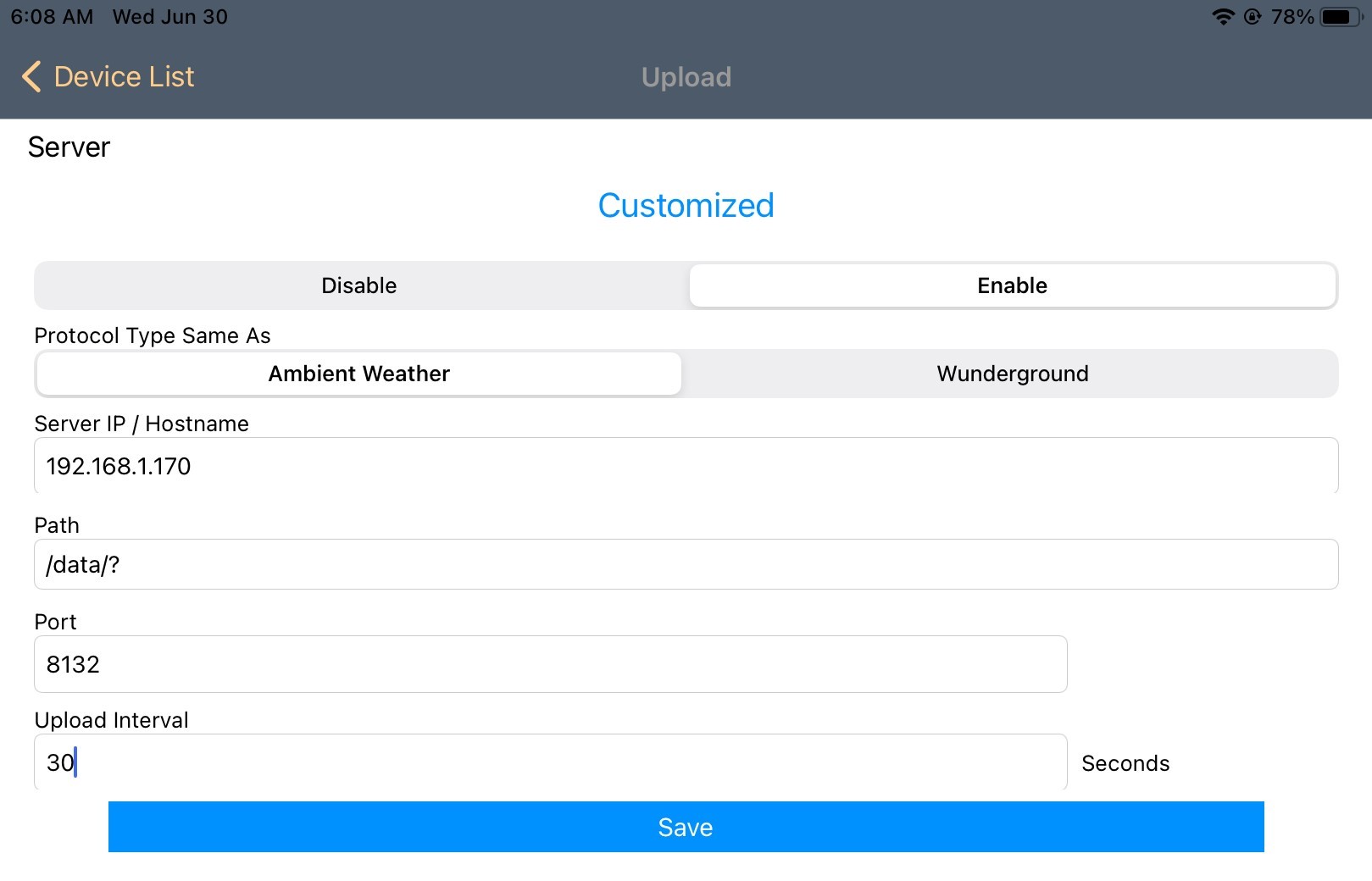

Configuring the weather station
Your Ambient Weather station must be configured to send data to the local service. This configuration is done through the awnet app. It is recommended to use an iOS device, but some have found success using an Android device as well.
- Run the
awnetapp and connect to your weather station. - Tap
nextthrough the configuration screens until you get to theCustomizedscreen. - Set the fields to the values in the following table.
- Tap
Save.
| Field | Value | Notes |
| Enable/Disable | Enable | Make sure to set this to Enable otherwise no data will get sent. |
| Protocol Type Same As | Ambient Weather or Weather Underground | Ambient Weather supports more sensor data and is preferred. Select Weather Underground only if using a weather station that doesn't support Ambient Weather. |
| Server IP / Hostname | The IP or hostname for the machine running the Docker container | |
| Path | /data/? |
It is very important this field is entered exactly as shown. Be very careful to include the ? at the end otherwise nothing will work. |
| Station ID | Any non-blank value | Only required when the protocol is set to Weather Underground. The actual value provided doesn't matter but something must be in the field. |
| Station Key | Any non-blank value | Only required when the protocol is set to Weather Underground. The actual value provided doesn't matter but something must be in the field. |
| Port | The port specified in the .env file |
If running in Home Assistant this should be set to 7000. If running the standalone Docker image the sample .env file provided uses 8132 so unless you changed it to something else you should enter 8132 here. |
| Upload Interval | The frequency to send the data. | 30 is a reasonable value to start with. |
Here is what a properly configured weather station looks like:

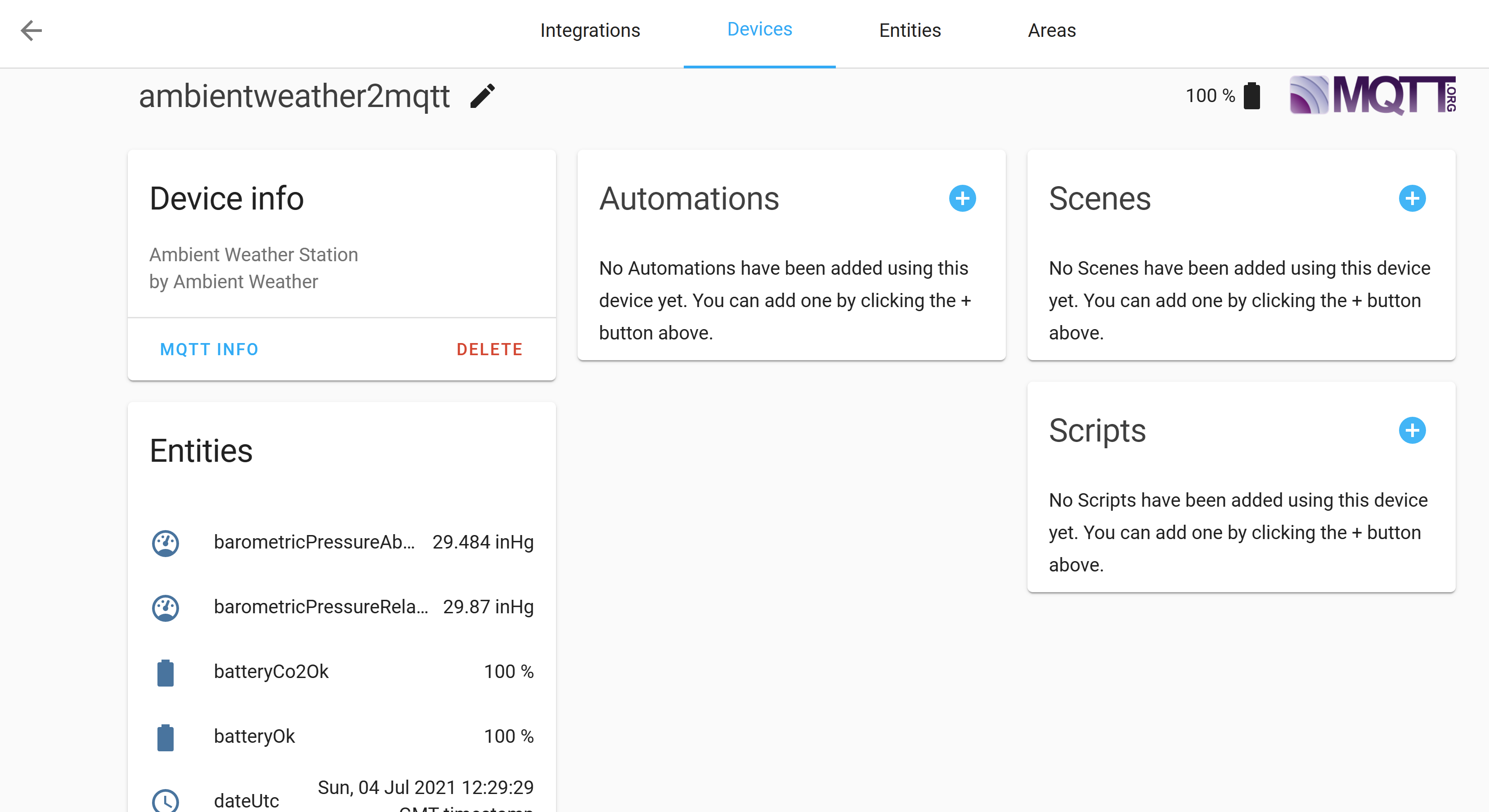

Verifying everything works
To verify everything works connect to your Home Assistant server and go to Configuration > Devices and search for ambientweather2mqtt. You should see a list of all the sensors with current values reported.
Troubleshooting
If you see the list of sensors but they all report Unavailable for the value it
means the data from the weather station is not being received by this system.
Check the following:
- The
Server IP / Hostnamevalue was set to the correct IP address for the Docker system. - The
Portvalue was set to the same value specified in.env. - The
Pathvalue was set to/data/?with the question mark at the end. If the question mark is missing the system will not work. - Your firewall rules aren't blocking communication from your weather station to your Docker server. This can happen if you run virtual LANs to segment NoT/IoT traffic from your primarily LAN.
